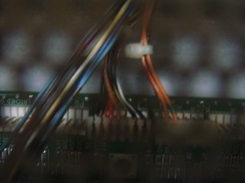

I just took a pic of it for you with my phone. I won't be able to upload it until later...I could text it to you if you are in a rush for it

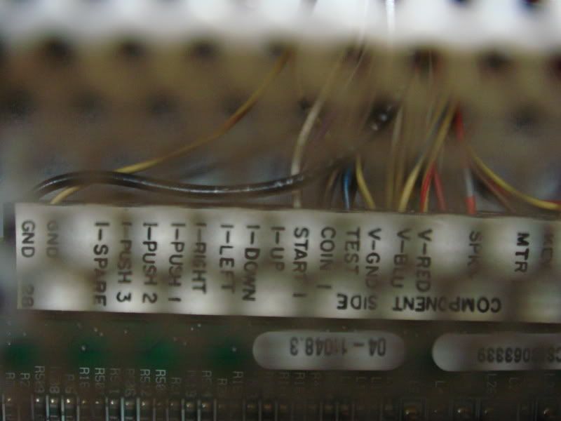

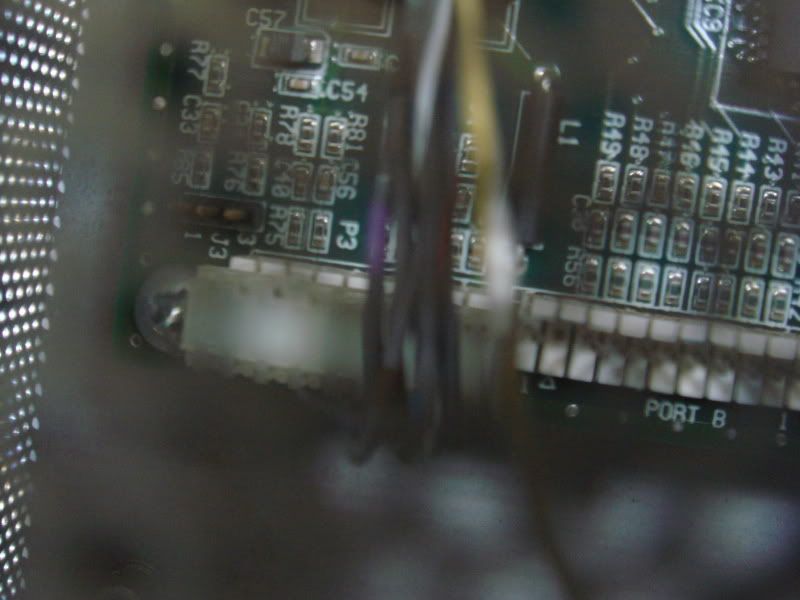

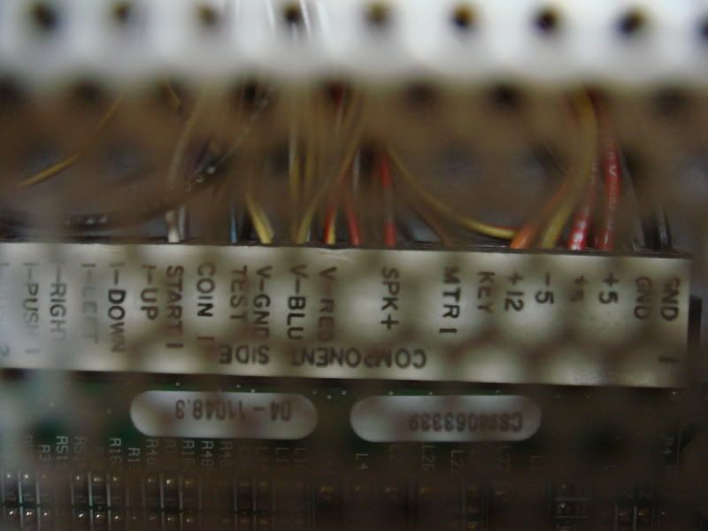

Test and Service Credit buttons are off the JAMMA harness. the Volume Up/Down buttons come off another header. I think it might actually be labeled "Coin Door", or "Aux. Inputs", I forget what it's called on the Seattle boards.
The test and volume switch board should have a 6 pin connector...here is where they all go:
1. Jamma Harness 15 parts side
2. P-16 AUX pin 5
3. P16 AUX pin 6
4 Jamma Harness N (14) solder side
5. KEY
6. P16 AUX pin 7
Hopefully this helps...if you still need pics of it, please let know
Thanks
Doc

This is the best i can do for now.Hope it helps?
