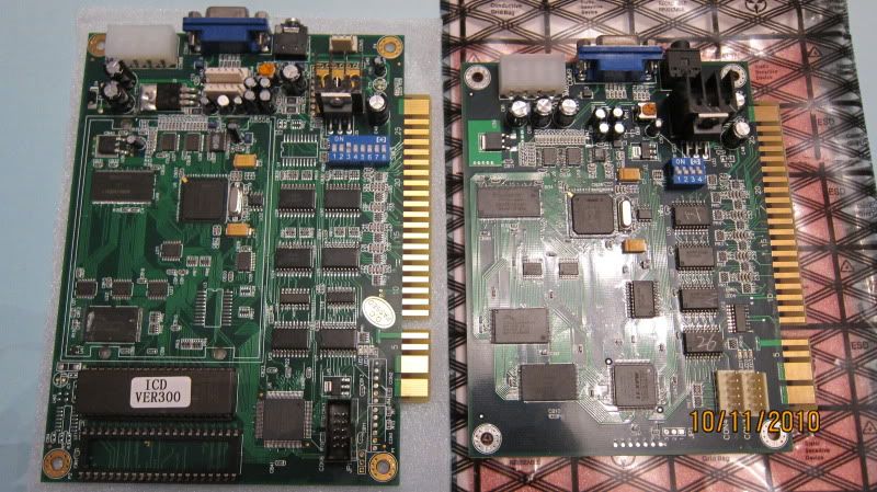

Stolen picture, old vs new 60-in-1

Same games? Same bugs? Did they IMPROVE any of the (sound) emulation? Same crappy menu with the shitastic 10 seconds of looping audio?
We had a stash of these, and from what I could tell the boards taht reduced to 4 dips instead of 8, I know they are smaller too, had some errors with how some of the games played.
I need to check when I get home but I'm pretty sure these 4 switch boards has probs with trackball support and DKJR, on top of the regular sound issues with the icades.
The original 60-in-1's (and the B versions) had the 4-dips, and the new ones (and A's) had 8-dips, so that's not the only identifier...
