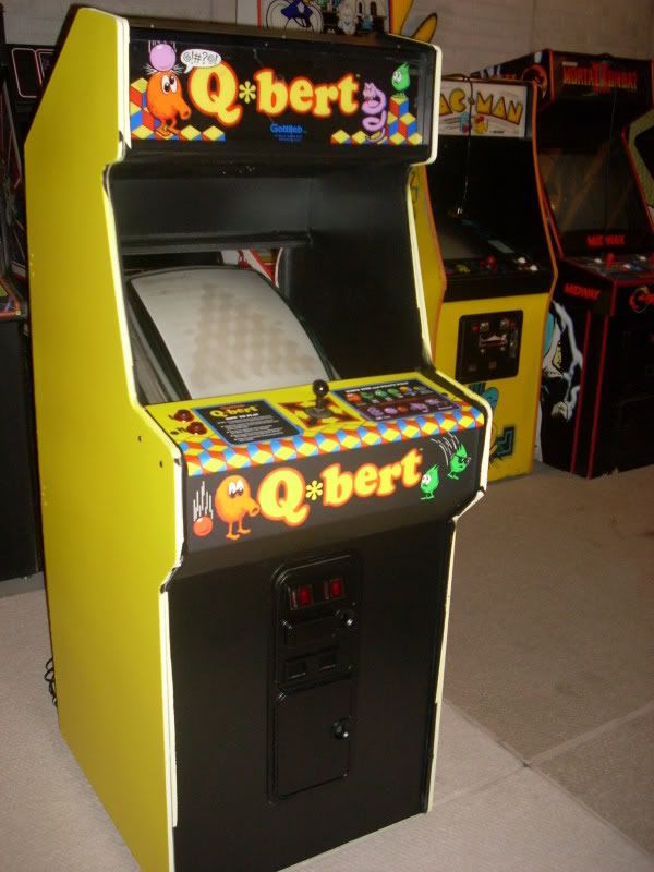

Hehe I've been on the 6 year plan with my Q*Bert. I bought it at a Super Auctions (converted to Dragons Breed) and have been piecing it together since then. Here's where I'm at with it. Still need to get the back door mounted, but a lot has been done. I even got the new cpo and lower overlay put on last night. Since I hate sanding and painting, getting that part done the last few months has made a huge difference. Now I feel confident in making that final push to get it done.
