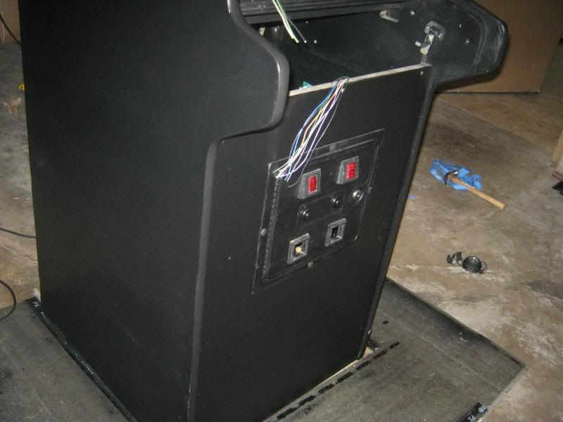

My Crystal Castles and Xevious do not have freeplay so I did the button trick. Crystal castles does not have a 1 player button, basically hitting a jump button starts the game so I can't wire a credit that way. Unfortunately something about atari start buttons do not like the coin trick tied to 1st player either.
I used extra red large buttons from Radio shack and a little silicon to hold the button in place for Crystal Castles. It is down by the lock box. For Xevious, I used an existing hole some goomba operator left from putting a lock bar there. Hole was large enough for a large button. I did the Xevious about 6 months before I did the Crystal Castles, which is why I didn't do the key hole option. It was when I got desperate with the Crystal Castles that I didn't want to drill a new hole so I did the key hole. Coin door was already kind of sticky, so I didn't have to worry about it popping open. You can see both red buttons in the picture below.
