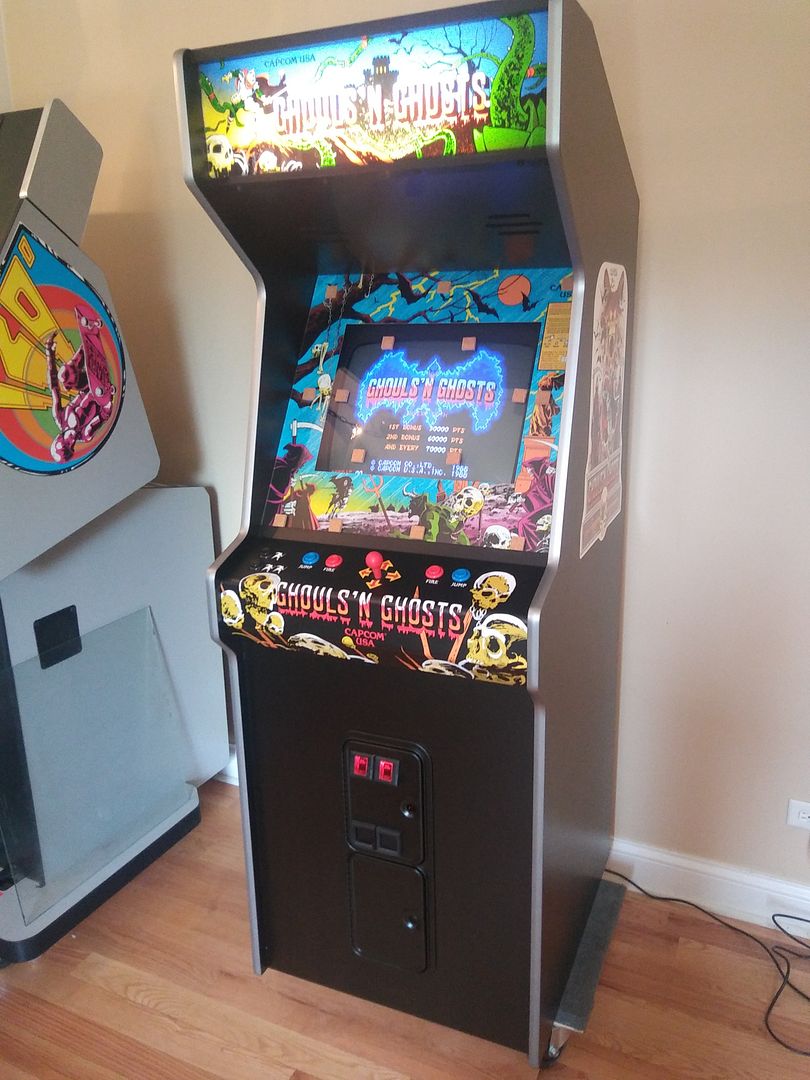

I have a local CNC shop that makes all my Lexan and they said they can make me a cabinet cnc cut. I have scoured the internet and don't see anything for this cabinet. If anyone has the plans I'd be grateful.

Ghosts and Goblins for sure has a dedicated cabinet. I used to own one. Like a Data East cab they are based on a generic Dynamo cab, but the front side panels by the kickplate go straight down from the control panel rather than cutting back in. It's similar in comparing say a Moon Patrol cabinet to a Robotron cabinet.

Yeah, Ghosts in Goblins was a dedicated blue cab thats very different to an HS1. Ghouls looks at home in an HS1 (as it should because it's supposed too), but when you paint one blue with the Goblins art it just looks funny and out of place.
We just need someone with one to get us measurements.

Yes it was dedicated, not the same, but not very different. [emoji6]
Dynamo basically tweaked the designs they had by a few cuts to make 'new' cabinet.

So if someone can measure the front panel of the cabinet that's the missing dimension. (+ the coin door height)
I built a bunch of these. Too much work with all the blue vinyl. The first one I built was with templates and measurements from an original cab. I got it almost identical. Then I bought an original cab and built several from that which were perfect.
This cab has several different areas that differs from all other dynamo cabs:
Monitor/ cp wood that holds monitor is one piece
Monitor frame is made to fit hantarax monitor
Back door has recess for specific frame
Everything is dado joined
Its the most unique cab that can't be really copied unless you have one to deconstruct.
