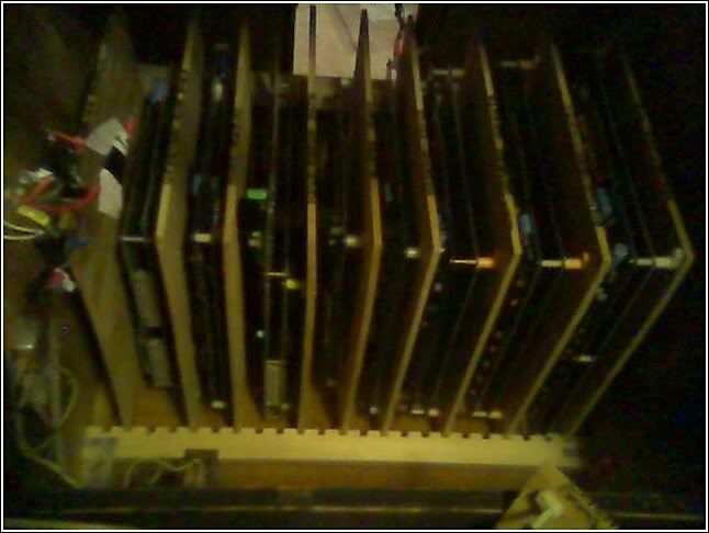

I have my JAMMA cabinet set up with a Multi-JAMMA for 8 boards at once, or I can switch in a single JAMMA board through the front drawer. This is an old picture of the back, but gives you an idea of how I'm housing multiple boards in one cab.

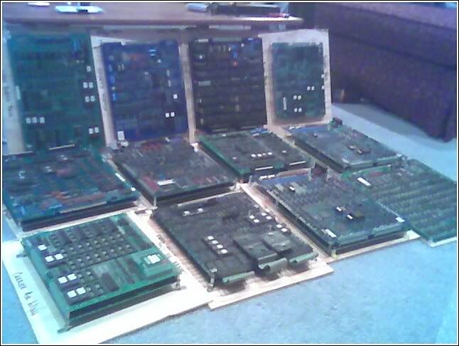

I only have 5 machines and 2 of them are Dynamo cabs. One vertical and one horizontal. I have over 30 boards for these 2 cabs and change games like I change my underwear. How often that is, I'll leave up to you. My horizontal was a Street Fighter so it has all the buttons I'll ever need. And my vertical has 2 buttons. I intend to add a 3rd when I get around to it.

Wow! thats crazy!! Never seen anything like that before
Awesome! What did you mount the PCBs on? Looks like of like fiberglass sheets in the pic
