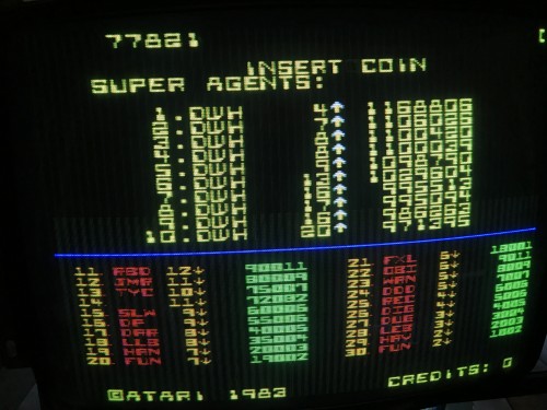

Even with the warps, high scores on Cloak and Dagger really impress me. When I bought my machine it was completely dead and had been sitting in someones garage for 10 years. But once I got it to work the old high scores were still on there, and someone who owned it before me had filled the top 10 scores with almost all 1 million score games. I'm not sure if it was the guy who I bought it from, or if it was someone else. But pretty impressive (I took a photo to preserve those scores before I reset the high scores). Is anyone on KLOV DWH? haha

And wow, those are serious scores. And it looks like the top score got back up to the 4th floor, but didn't escape??
