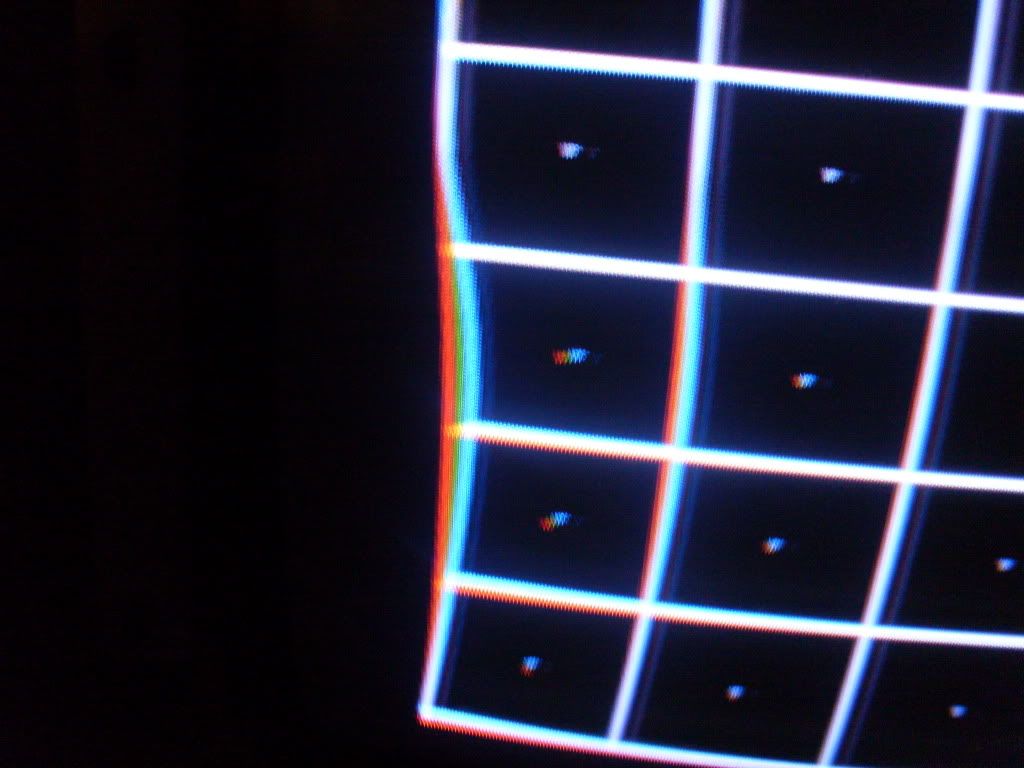

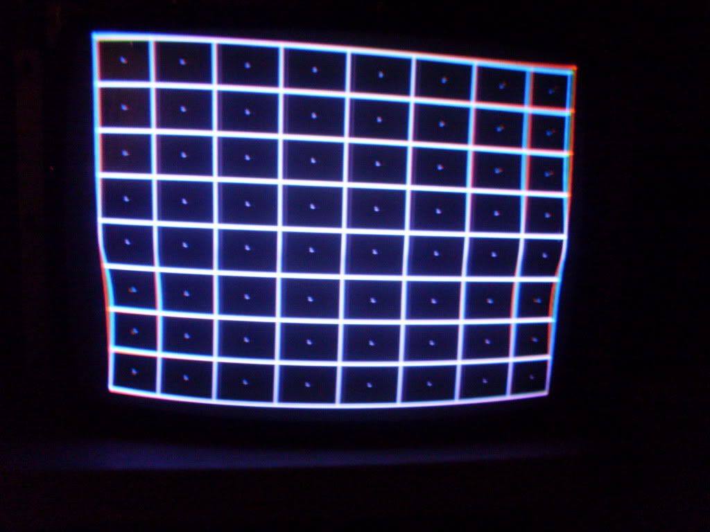

Well, I connected the strands that had continuity to a terminal, and my ring tester said it was good to go. My meter read 40.3 ohms instead of the 44.1 of the original. Hooked it up and I get this:
The bottom edge is parallel to the tube edge, so the yoke isn't crooked. The chassis hasn't been rebuilt yet, but the geometry isn't perfect. Of course, it's better than what it was....
got those metal wedges on there? shouldn't that help the corners out?
PS: this is amazing. lol
I pulled the 5501 yoke off and put the 5515 yoke on in the same position. Rings in the same position.
After leaving it on for while the bottom curved up and looped back towards the top, like a piece of paper that curled up at the bottom...
I don't know if I can fix it completely. Some of the busted strands are way up under the edging of the plastic around the yoke, and it's all glued or epoxied in place, and i don't think I'll be able to get to them in order to try to connect them all. Apparently it doesn't like not having those strands connected, or perhaps my quick fix needs to be improved a bit....

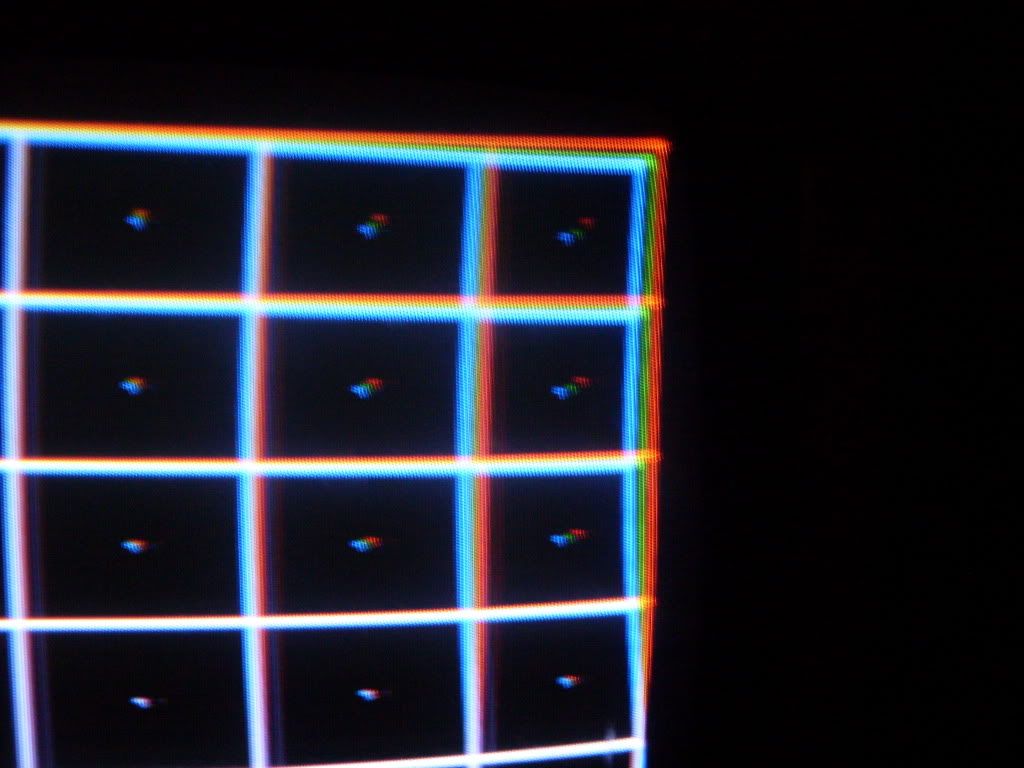

When we last left you, I had found a couple of the fried strands that had continuity to each lug, connected them, and got this result:
Well, I wasn't happy with this result, even though I now had vertical deflection. The distortion was too much for any self-respecting arcade hobbyist to live with - even for a medium-res monitor. Plus, after it was left on for 30 minutes, the distortion got worse and the image started to fold back on itself.

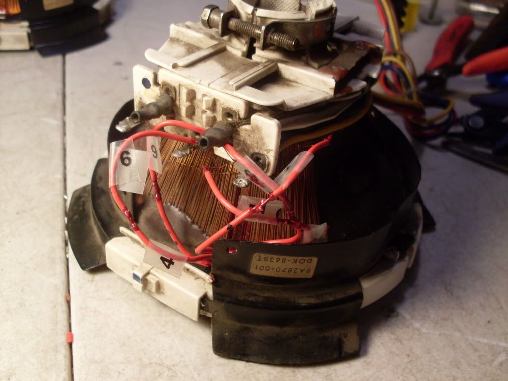

Okay, the first thing I did was disconnect the two strands I connected before. I was able to pull part of the standoff frame away from the copper wiring by cutting into the glue that held it in place. This gave me access to some of the very short strands that were right under the edge there.
Next, I grabbed a pencil Exacto knife and a flat-head screwdriver. I stuck the flathead under each strand end, then used the Exacto blade tip to scrape away the enamel coating on each copper strand. Then I tinned each end and attached a short section of insulated wire to each. I did the same to the strands on the other side of the burn mark. In total, I had 5 strands that were broken (that I could see). I then numbered each strand with my labelmaker, counting 1-5 on one side of the break, and 6-10 on the other side.
Now to find the continuity between each strand tip and the lugs on the yoke. These were my results:
Strand 3 <--> Left Lug
Strand 1 <--> Strand 9
Strand 2 <--> Strand 6
Strand 4 <--> Strand 7
Strand 5 <--> Strand 10
Right Lug <--> Strand 8
So, I wanted continuity from each lug, going thru all strands. I made up an arbitrary order based on my numbering order and came up with this:
Left Lug -> 3 -> 6 -> 2 -> 7 -> 4 -> 9 -> 1 -> 10 -> 5 -> 8 -> Right Lug
So, I would be connecting 3 & 6, 2 & 7, 4 & 9, 1 & 10, and 5 & 8 - which I did. I then used some of my wife's Red Wine enamel nail polish to coat the solder connection all around, making it look like I bled all over the yoke.

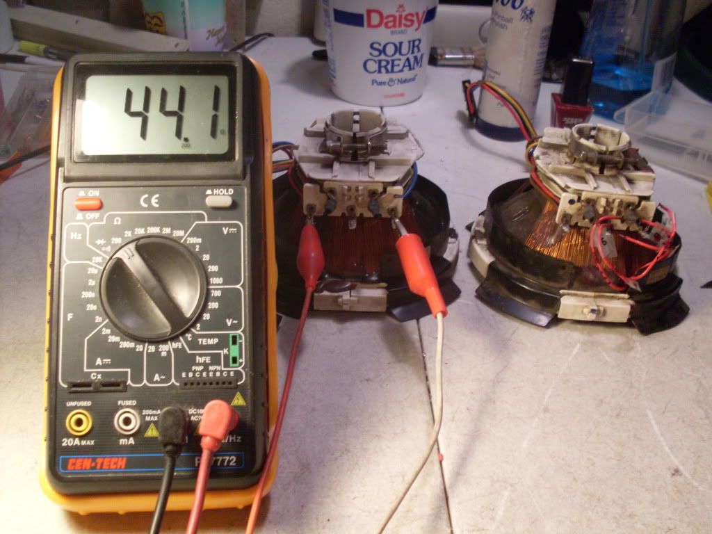

Okay, now I needed to see whether or not this repair was better than the first. Before, I was reading 40.3 ohms across the vertical yoke, rather than the 44.1 ohms I had been told was correct. Well, I now had an original undamaged yoke handy, so I hooked up my meter to the vertical yoke to see what it's supposed to be:

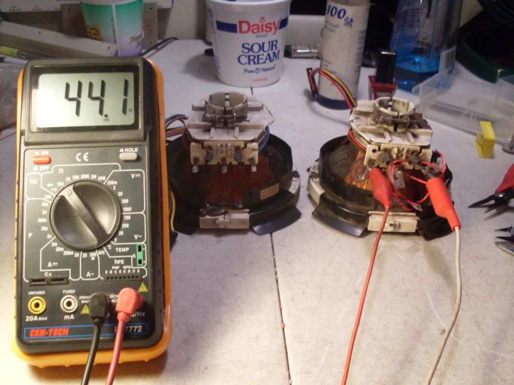

So, lets see what my "repaired" vertical yoke is now reading:
HEY! Look at that! I'm feeling pretty good now. I had to take a few minutes to go strut in front of the wife and announce, "CONFIDENCE IS HIGH! I repeat, CONFIDENCE IS HIGH!" Of course, I then had to explain what I was doing, and how difficult it was. She patted me on the head, gave me a cookie, and sent me back to test my "fixed" yoke.

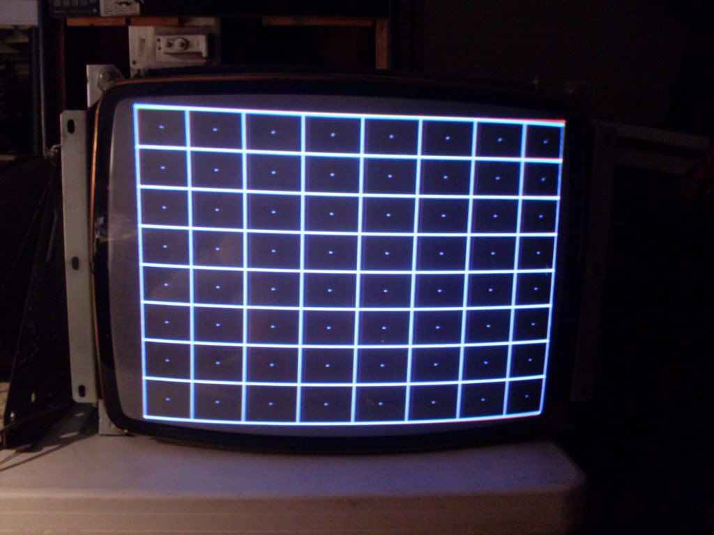

Well, before we test, we've got to have a control. So, I put the undamaged yoke on the tube and got this slightly blurry pic (damn camera):
Looking good. A little convergence issues on the corners and a little warping, but probably due to the yoke or rings not being on perfectly. Not worried about that at the moment. I'm just hoping that my repaired yoke gives a similar result.

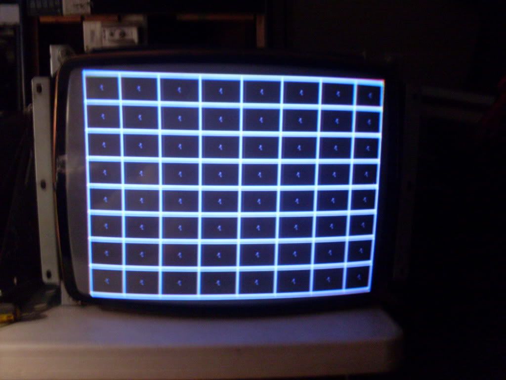

So, I put the repaired yoke on and get this:
WOOHOO!!!! :eek:
It's been running for 30 minutes now and still looks just as good! Looks like I have successfully repaired a blown yoke. I'm sure it's owner is going to be VERY happy.

Impressive. Congrats. How difficult was it to solder to those small wires after you scraped off the insulation?
Eh, not bad. I tinned them, then tinned my insulated wire, stuck the iron tip in there with a small blob of solder on the tip and quickly merged them. Had a fan blowing to help cool them down fast so they wouldn't separate while they cooled...
