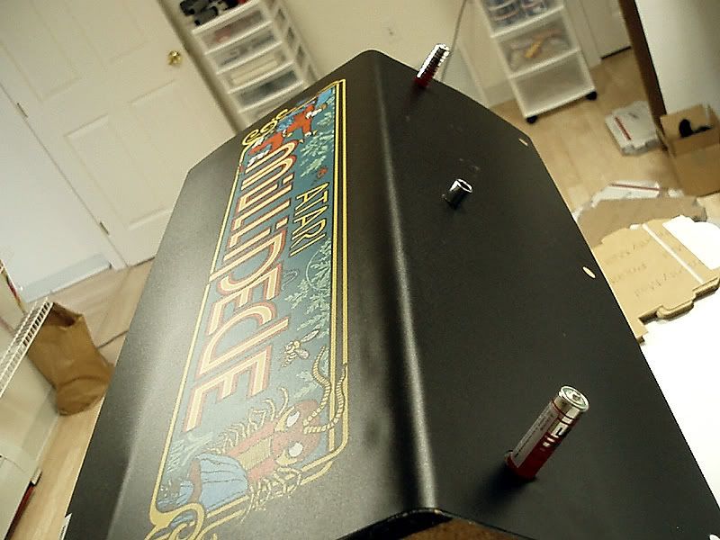

Keep in mind your marquee will be cracked like crazy soon enough so perfection is really irrelevant.
I did this with Millipede a few years back.
Dude that battery / 10mm idea is genius. I'll be doing that. Thx
FYI. Energizer Max batteries are a little fatter than Duracell's. lol

Ok I think it went on good enough to call this a success. Did the best I could to keep it straight and get this marquee overlay around the curves on the wooden marquee.
The pictures detail my process. Used @andrewb trick but used double sided tape. And I used @Dewman trick with the AA batteries and 10mm socket. Worked great.
I also let the marquee warm up in the sun for a few to help activate the clue.
