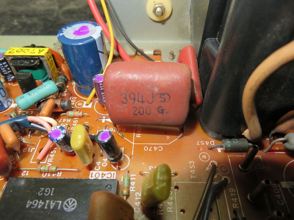

Buffett before I tear this Sanyo apart for a 7th time, can you tell me the exact value of C470? Can you sell me one of those pillow caps or link me to who sells them? I'm going to take a look at it and see if it is labeled.

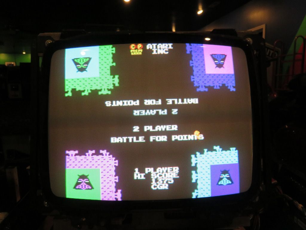

Missing about an inch on either side of Warlords cocktail. 14" and can't adjust it out any further.

as i recall c470 is .47uf 200v and i have the complete kits with way more caps and variations and much better caps then BR kits. here is the link to it.

So this is what throws me, this numbering system on these (chicklet/pillow) type caps. The numbering system. Im not comprehending it.

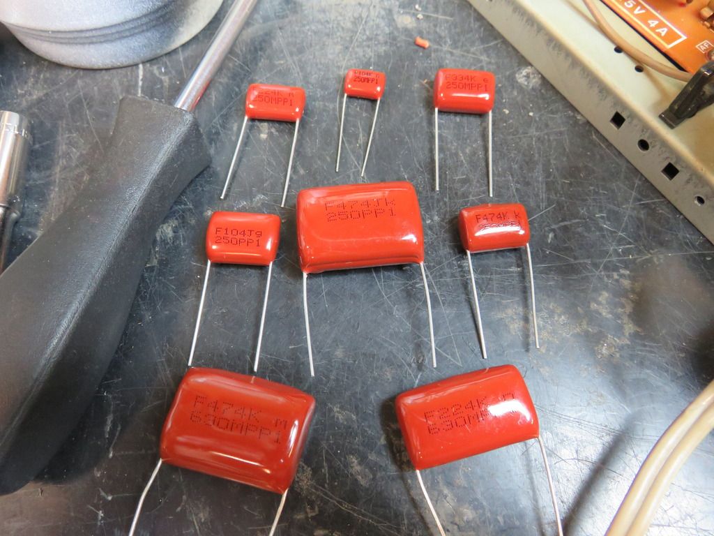

Included is this photo of the BR width cap kit
I'm also taking it, that just C470 is responsible for the width alone other than the coil (Meaning it's the only one I need to replace).

bob's kit doesn't have the .39uf 200v cap that you have on that chassis. my kit BTW has the .39uf and many others that BR kit doesn't have.

I am going to attempt replacing it with the same only new. I am trusting there is a problem with this width cap. I am thinking a cocktail Warlords should go all the way to the edge of the tube and not have a 1" gap on either side. Although I have seen a few pics of this very problem when googling warlords image.

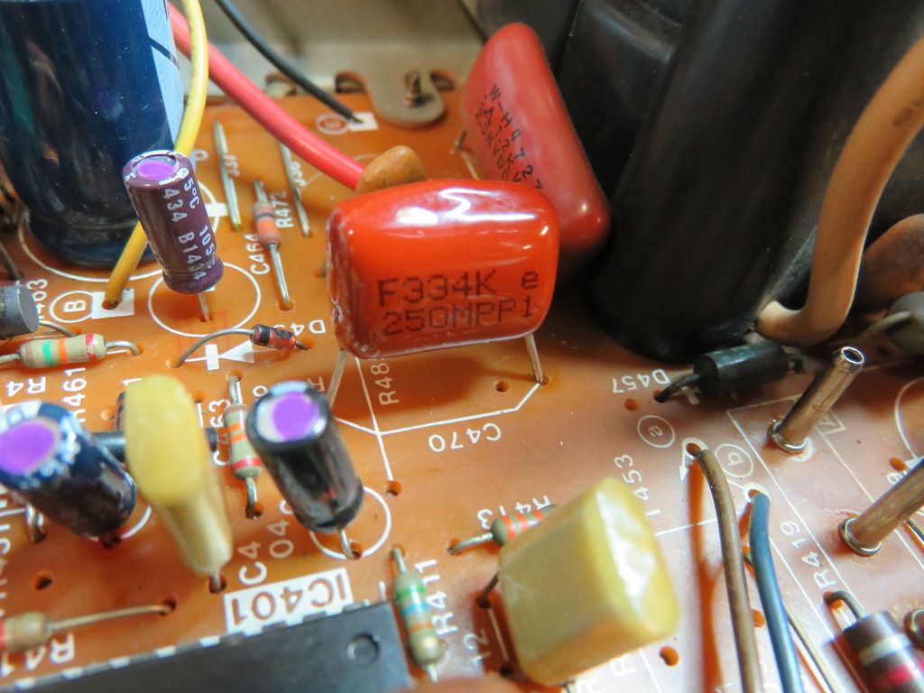

Ok, so I removed the previous cap. Soldered in the F334k in it's place. Powered up. Nothing seems to have changed. I adjusted the HWC until it bottomed out.
I then checked the original cap with the multimeter. .394 right on the nose.
Pretty much out of ideas.
