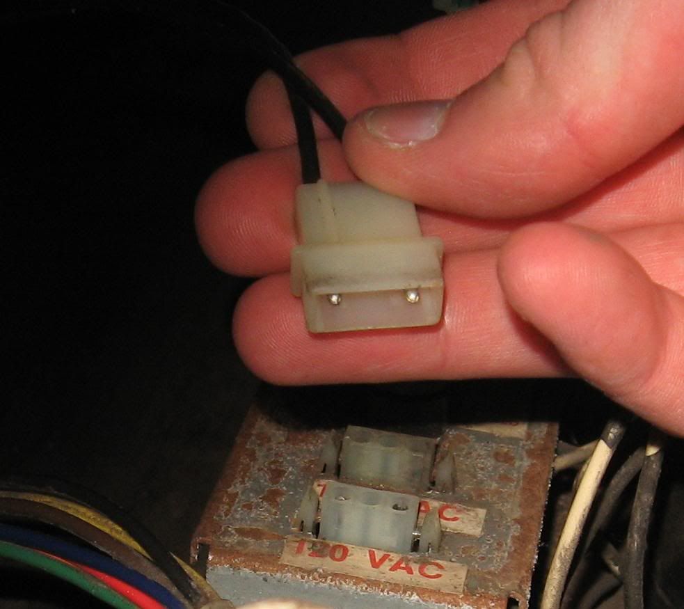

Anybody know where I can buy these types of connectors?
This is monitor AC in a taito cabinet.
Old thread, I know, but I've got a few of these Taito mate n Lock housings but I have no pins for them. I've tried both .84 and .93s, both too big. Tried .63s, way too small. What size pins do these things take? Do I really have to buy 10 of the pins Eddie linked to at mouser for $1.90?
ELutz linked to the correct male and female parts of the AMP "Commercial" Mate N Lock connectors and crimp terminals.
Perhaps you were trying to use Molex brand terminals in an AMP brand housing? They don't fit. Only use AMP brand terminals in AMP brand housings.
