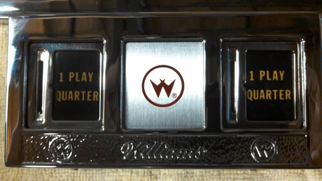

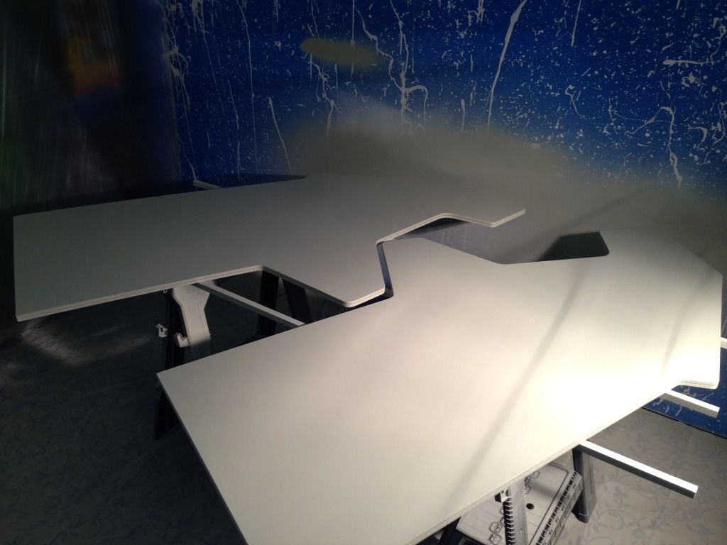

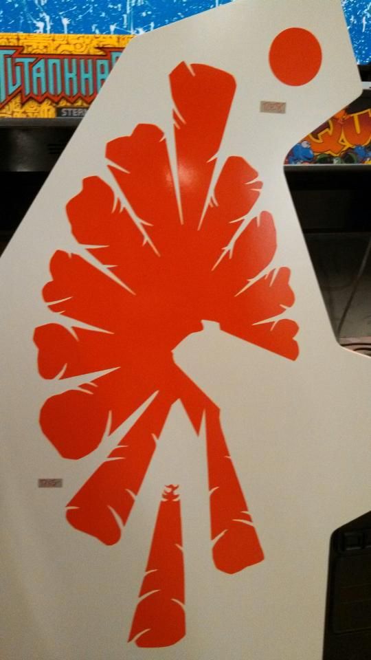

It's in various stages... cabinet, stencils, coin door, control panel artwork etc.
Cabinet front:
Cabinet 1st layer of paint
Stencil 2nd layer of paint

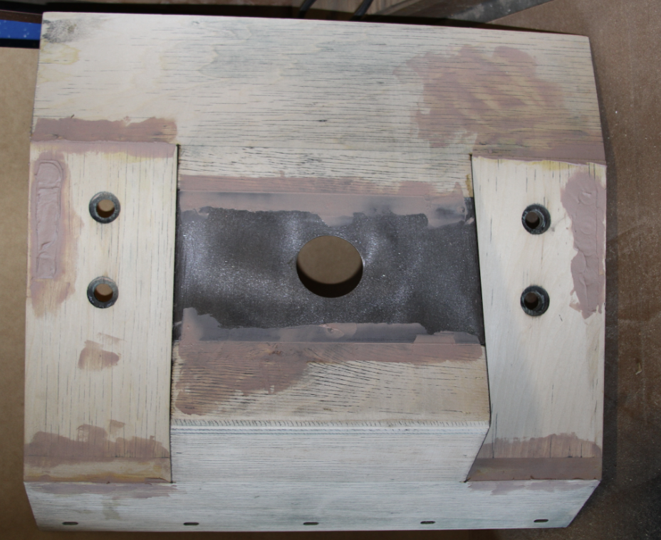

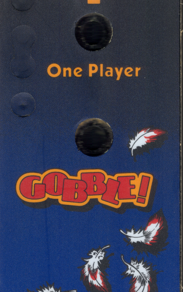

Control Panel, still need to fill those outside holes that ruin the overlays They were used to hold the latches underneath.

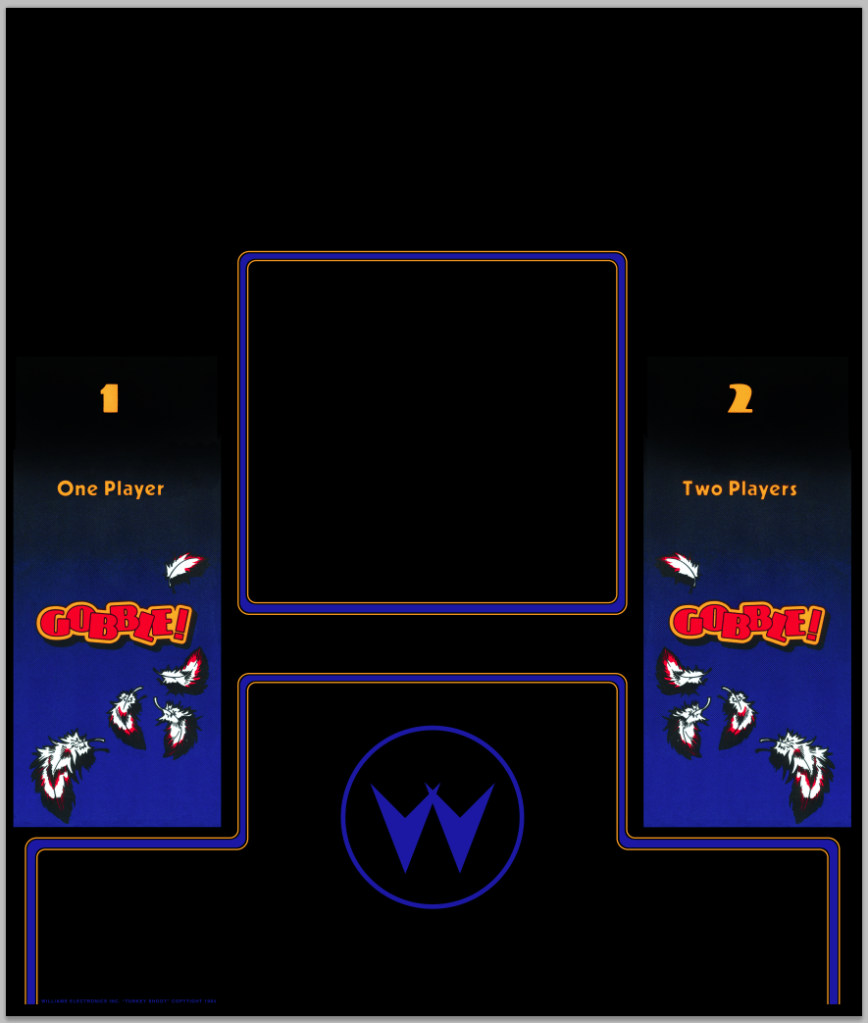

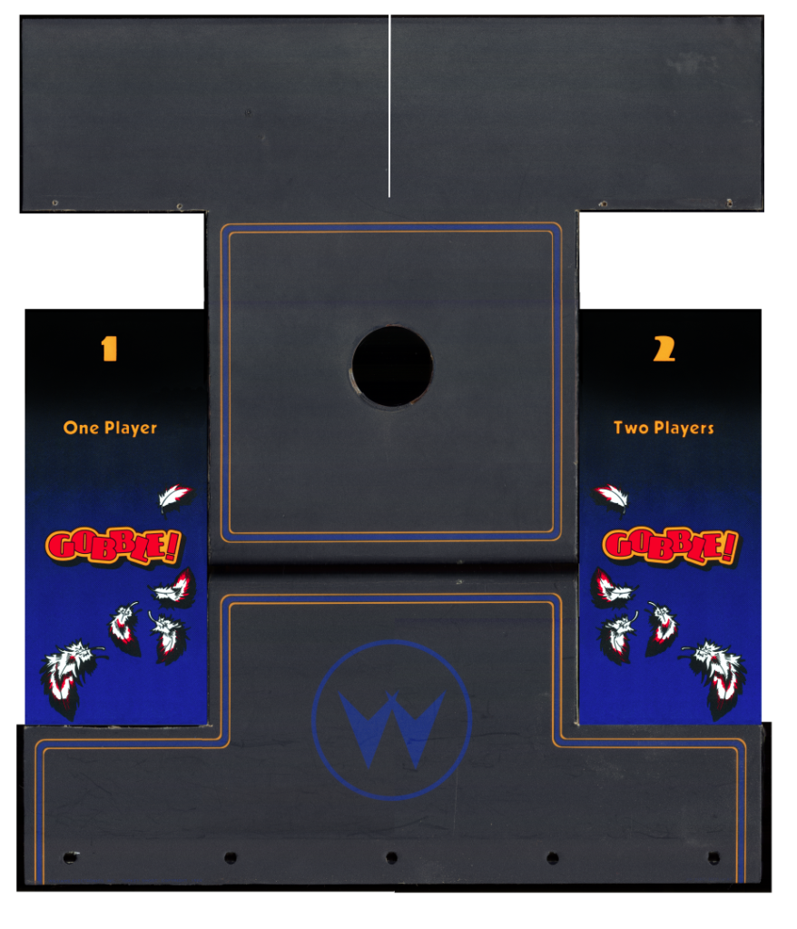

The sunken in damage to the overlay can be seen in these scans:
First section of cpo art restored:
CPO scan layout in photoshop: Stitched together about 12 scans
What the coin door is looking like:
panel filled, ready for sanding. Second stencil color (yellow) goes on tomorrow.

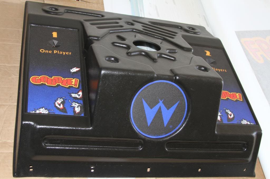

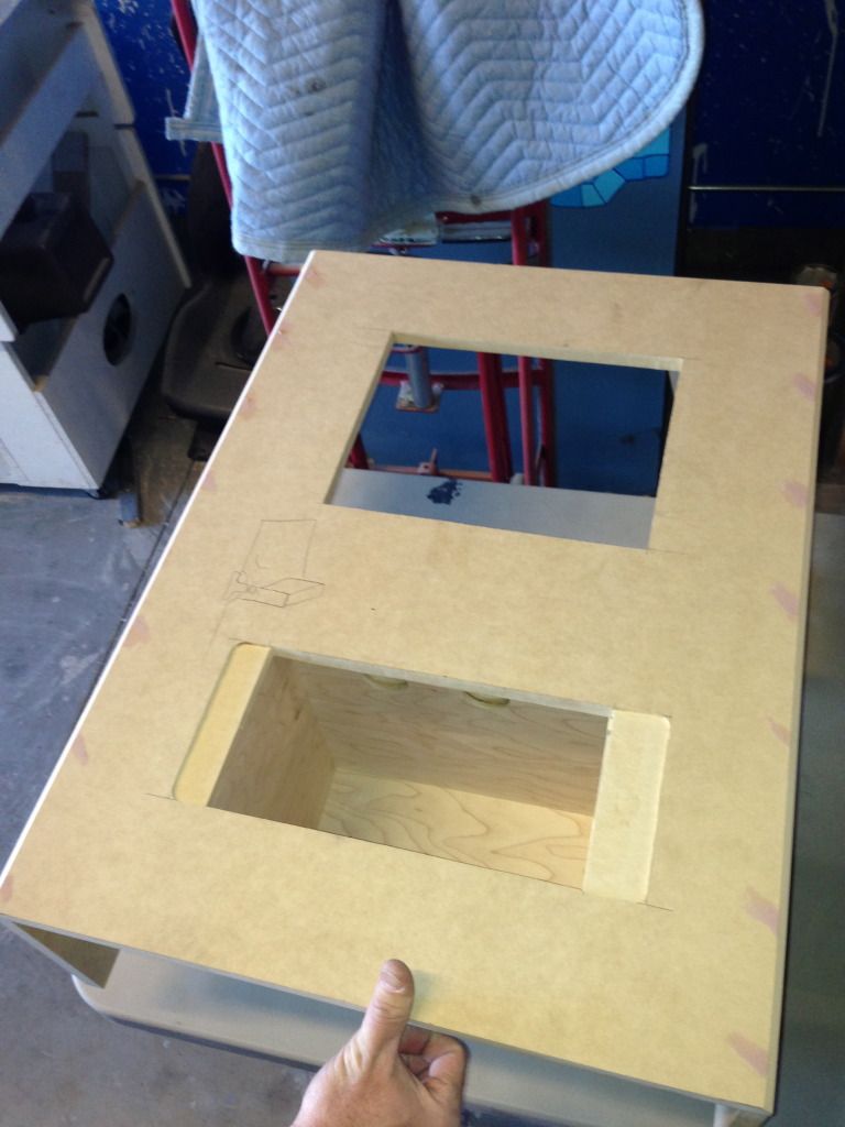

So you decided on the wood panel versus the molded panel?

I've never seen a Turkey Shoot for sale that has a control panel that looks like that. If i found one i'd buy it.

Hey Fiz,
Just an FYI, the molded CP is NOT a drop in replacement for a non-molded CP cabinet. I liked the molded CP better too, and I tried swapping CP's but the molded CP did not fit correctly into the non-molded cabinet. I didn't look into exactly what and how extensive it would be to make it fit though. Just wanted to warn you in case you considering putting a molded CP on, you would have to do some cabinet modifications.
So, got any of those non-molded Turkey Shoot CPO's available for sale?

Thanks for the heads up Joe. If and that's a BIG if I found a molded cp I could make modifications, especially at this stage of building a new cabinet. Later would be tricky but I think doable.
Yes, I'll have my test print back soon. Ill have to document how to apply it as well as it needs to be sliced just right to go on.

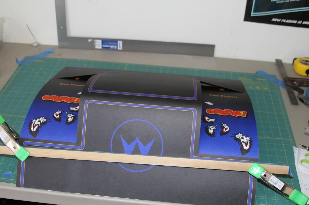

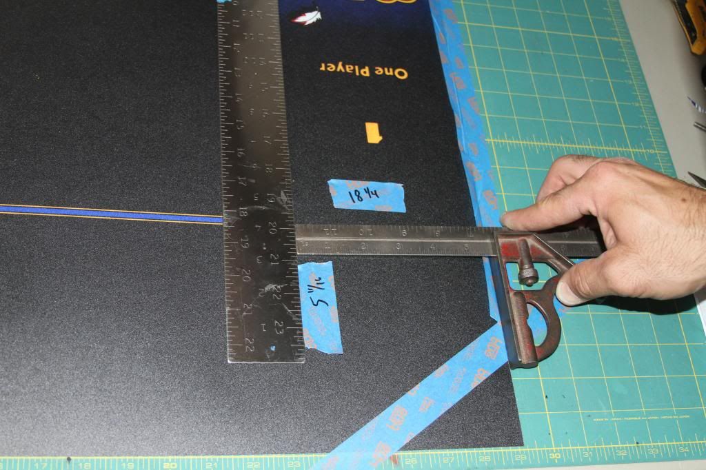

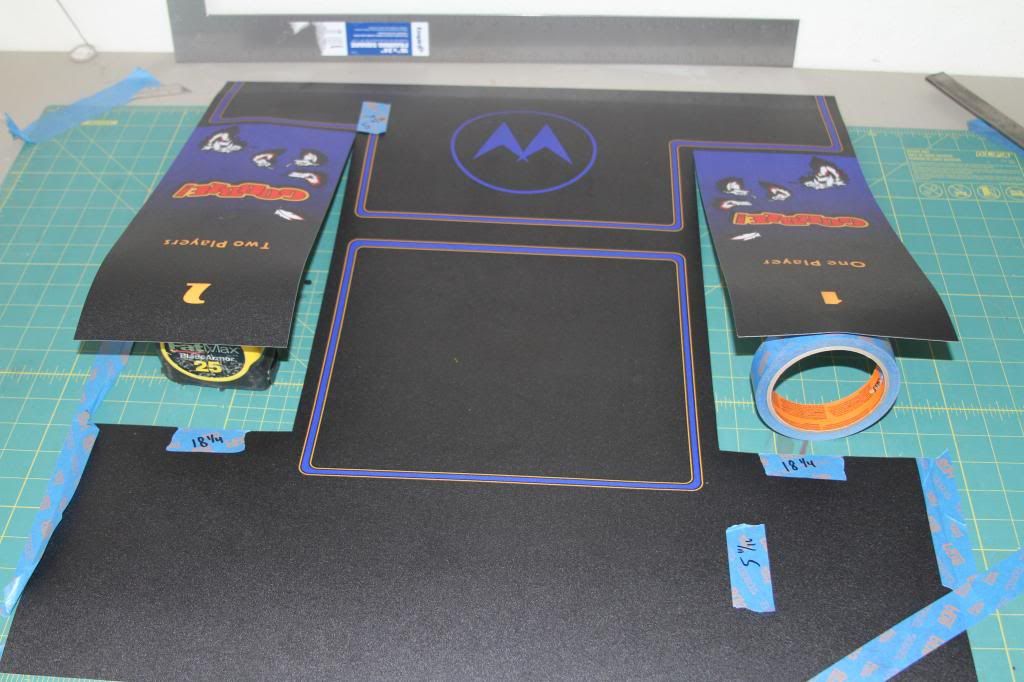

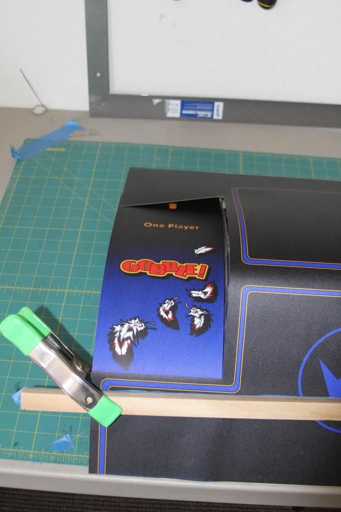

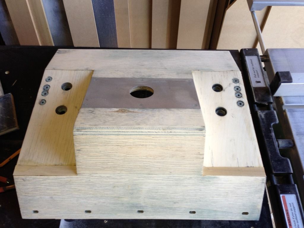

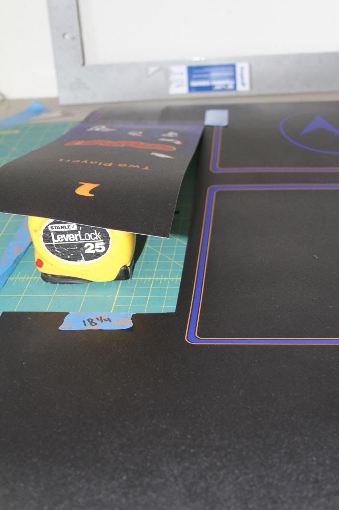

I also applied the a new CPO to the wood control panel that i'm sending to Joe M.

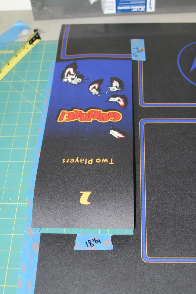

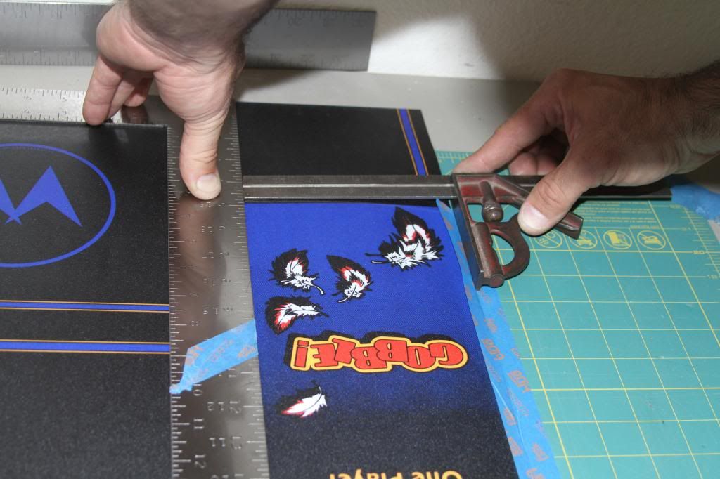

Here are the steps it takes to apply.

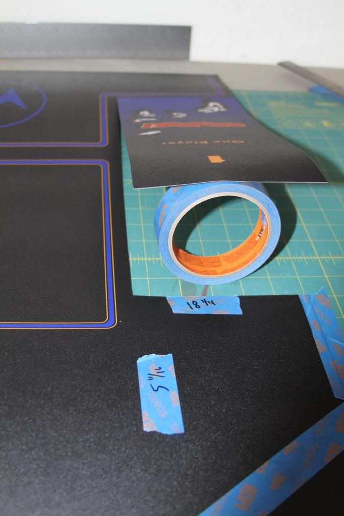

measure 18 1/4 from bottom of CPO, and 5 11/16 from bottom of cpo

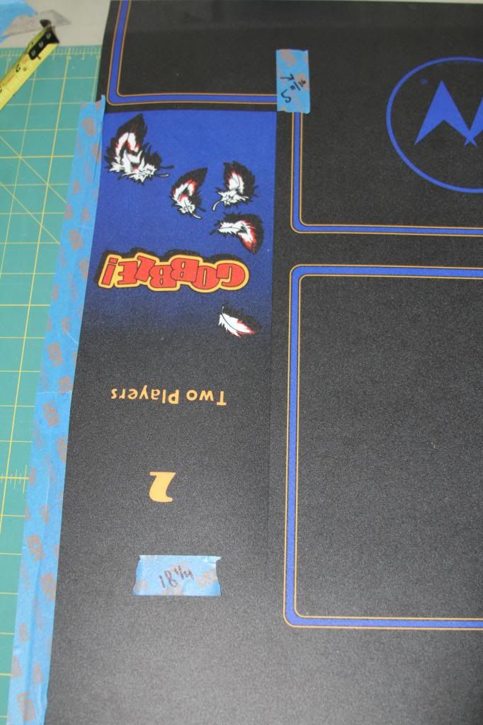

cut along blue edge and then top to create flap
other side
flaps
position cpo exactly flush with the bottom of the wood panel and clamp down
