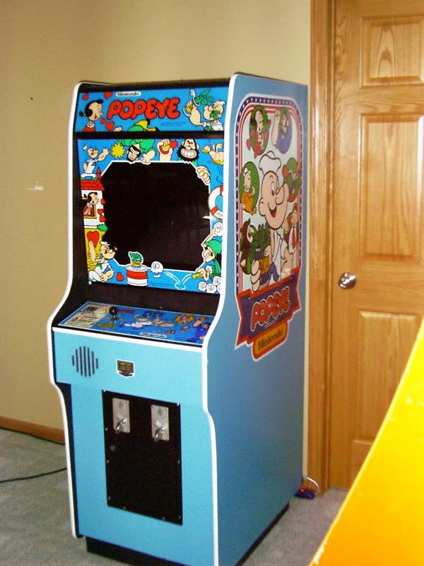

Wow Phet! I am surprised you didn't replace the side art, it was torn! :D That looks as good as the R-Type you restored!

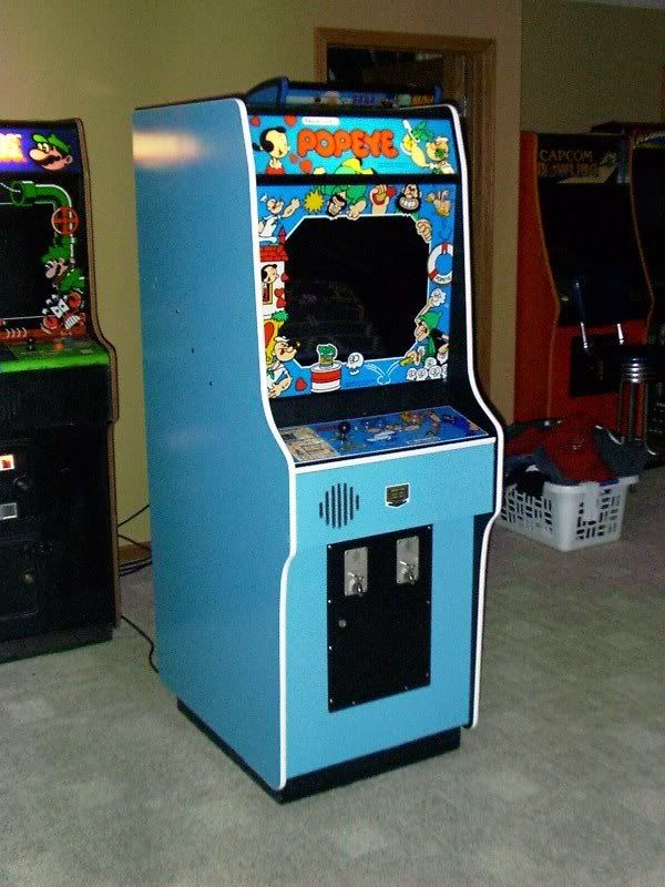

I didn't restore it for me, and I went above and beyond for the $325 pricetag that I and the buyer had agreed on before I started. Can you imagine that paltry $325 taking a $100+ hit for new side art? Ridiculous. I saved the side art for my own machine, which I restored a few weeks later:
Now that is beautiful! Why do I always see Capcom Bowling in Pac-Man cabinets?!? It seems as common as Golden Tee in a Mortal Kombat cabinet.
