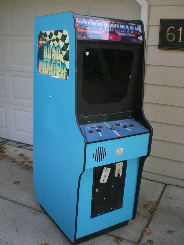

Saved another Ninty cab from the despair of 'shed storage' today. This one's actually not in too bad shape.
Back door is locked and I'll need to drill it out, unless someone can coach me on a better way to break in? I DO have access to the coin door, so I guess I could try some acrobatics to get the back door off.

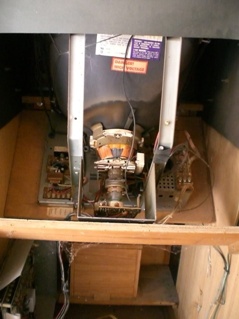

The cab's been JAMMA tized, but the original DK power supply is in there, and I believe it's the original 20EZ. Jailbars pretty bad.

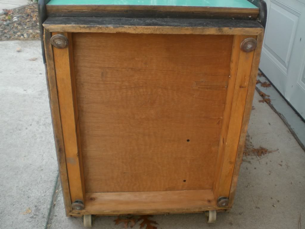

The bottom has a couple of 2x4's toenailed in with leg levelers installed. Kinda nice, actually. I'll clean that up and put some acrylic levelers on there.
The game works, but who the hell wants to play THAT craptastic game?
I'll be using the shell for a DK build this winter.

I couldn't resist - I drilled the lock. Yes, it's a 20EZ.
I don't know what I was worried about - Road Fighter is a Namco game, and the video works with the 20EZ. The harness has some 'creative' work to it, but the game works great. I was a little surprised to lift the CP and find a 2-way joystick - yep, Road Fighter is really a 2way game.

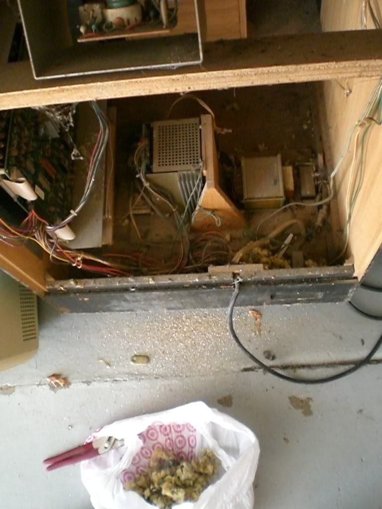

Cabinet had some serious mouse nest going on, but no carcasses that I could see. Dried rodent pee on the metal PCB shelf, but the PCB is clean, thank goodness.

I might want that PCB to add to my Konami collection. And BTW, the video output on the board is standard, it's being inverted to Sanyo/N* format by the inverter board on top of the flyback.
