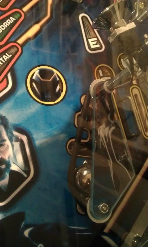

I'm loving it. I'm really glad that I did this. That being said, I have had a few problems with it. Noisy recognizer motor, I had a pop bumper go ape$#it (going off randomly), and somehow my wife managed to do this:
Mine does this often as well. Sucks, what can be done to rectify?
Balls are also getting launched over the playfield and into the far top-right of the playfield, above the actual field, behind a couple of artwork support posts. Thinking of trying to put some wire or something up there to bounce the ball back down to the playfield again - happens when shooting the ball during multi-balls.
I pulled the tension on the front side, so I'm hoping that will work. My only other though is getting the next size down. I've actually twice had it pop the rubber over the kicker mechinasism.
I'm thinking part of the problem is if the ball has back spin when it hits, which lifts the rubber up over it.

I have had both bumpers get the kick arm (or whatever it's called) pop over onto the wrong side of the rubber too.
