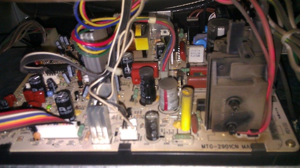

Another round of what chassis is this!
squall280
Mar 19, 2010
1,382
19
Pennsylvania
out of a tron machine.
Vision Pro. The white button on the left front is a sync selector switch so you don't have to change the wiring of the video connector to switch between positive and negative sync, if necessary.
If it's dead, recap it first. A lot of times one near the flyback bulges on top...
