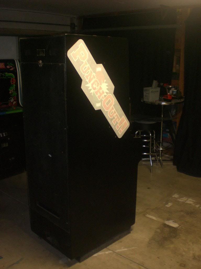

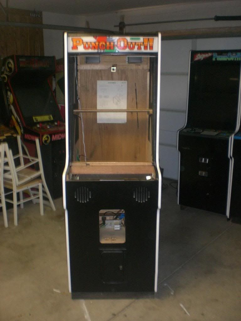

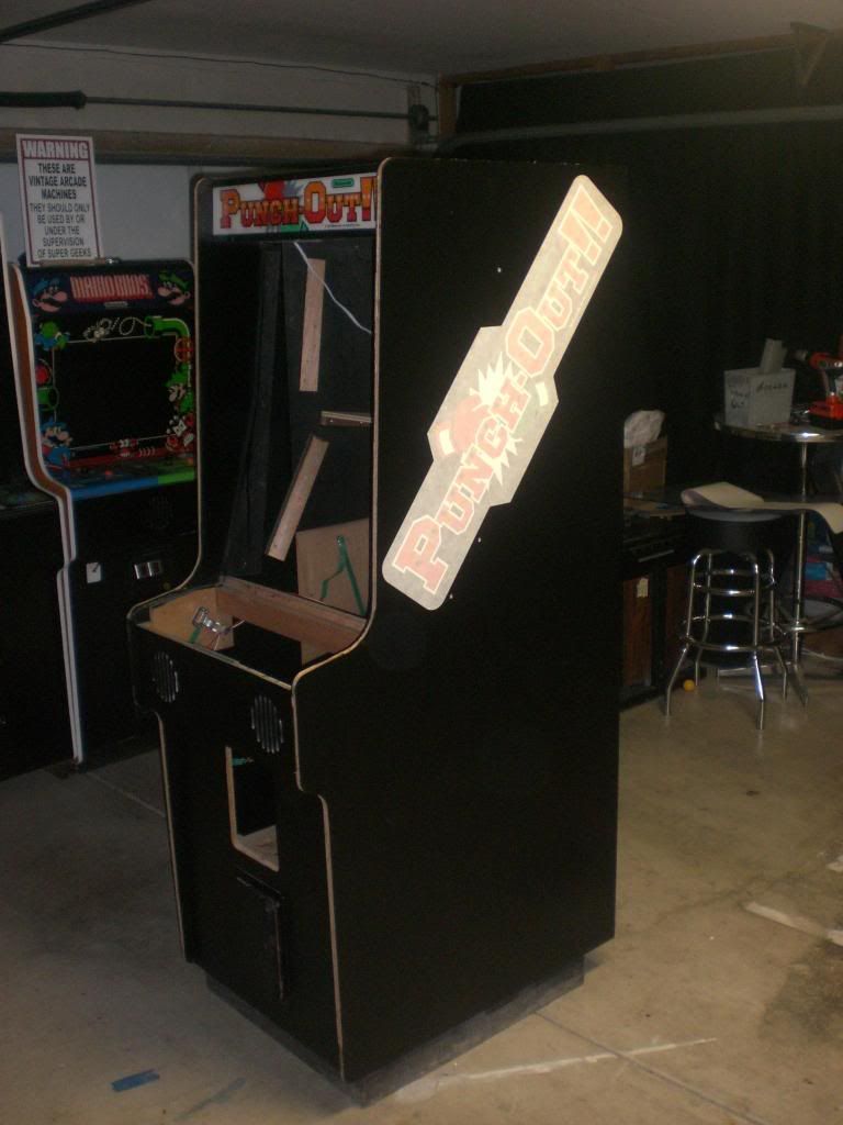

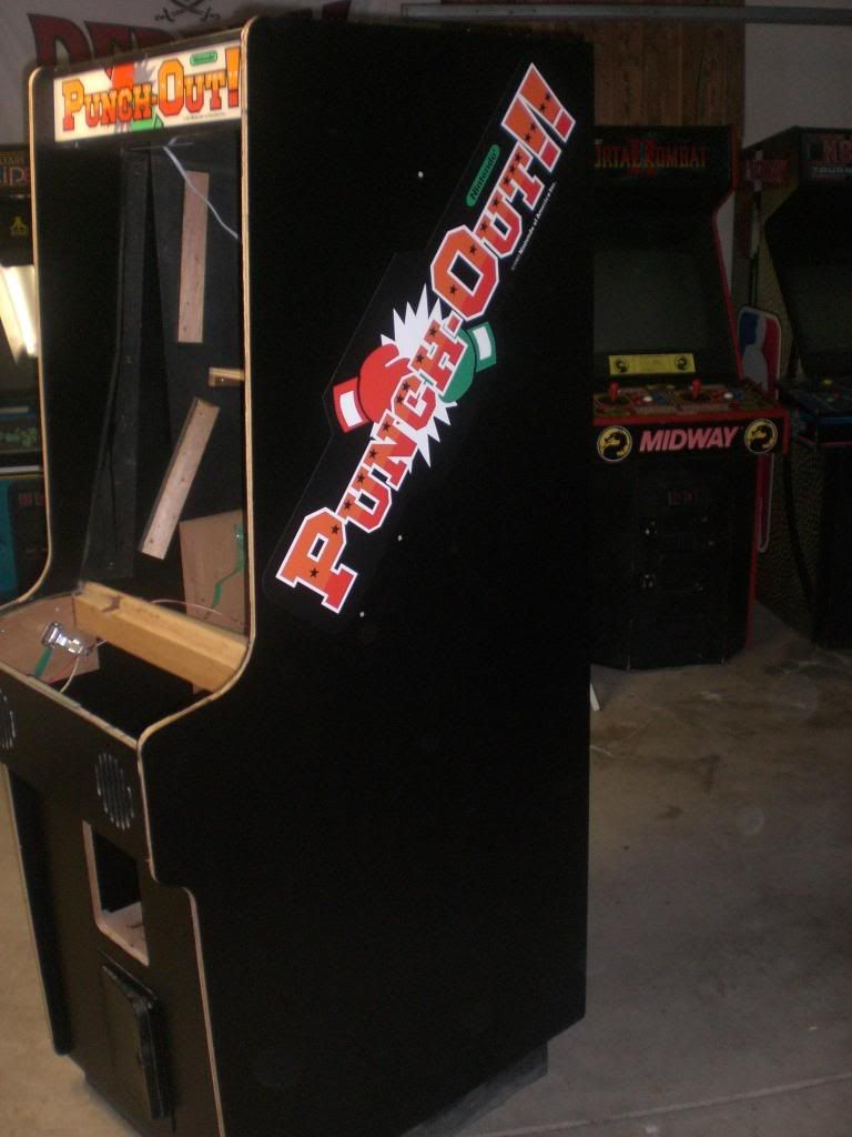

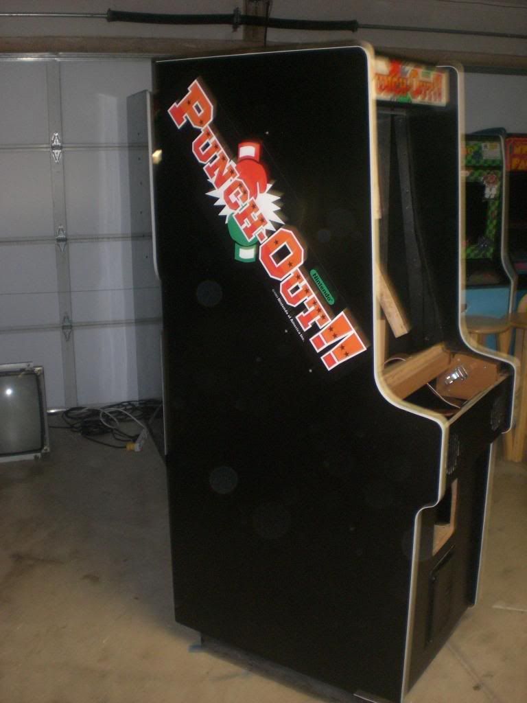

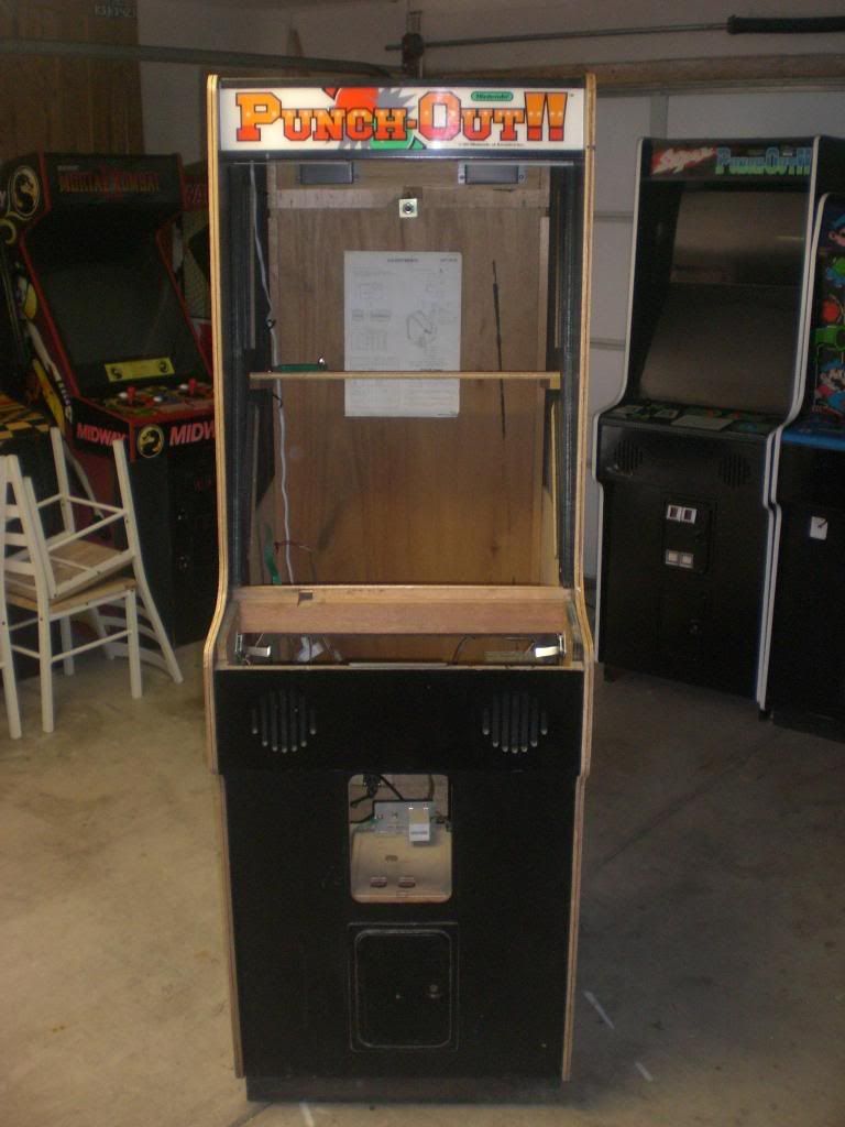

Figured I would share my resto, as it seems Punch-Out!! is a popular cab for people to be working on as of late. I'm not all the way done, but am finished with all the exterior. As I was uploading my pics I realized I didn't take very many progress pics, so that was kinda lame of me. You can get the gist of it though. This stupid 4 picture limit is going to make this post kind of long though :rolleyes:
Still needed to do:
-replace CPO
-install KO button (w/bracket)
-replace upper coin door
After that, she will be done!

Nice work so far on the PO! Did you have to do anything with the monitors?
Ha, yeah. Here is how it looked when I got it a year ago...
Top monitor had no chassis, bottom needed capped...
Blkdog - Its just a progress post ;) All the hard stuff (paint, side art, monitors) is done.
That's a beauty jow...very nice. I love seeing all the good photos of these PO restorations lately. The multi-monitor cab is very interesting.

Did you spray or roll the paint? It's amazing how a little fresh paint, some new sideart and t-mold will dress up a cab, when you get the CPO, the KO button and fix the coin door, that thing will look cherry.

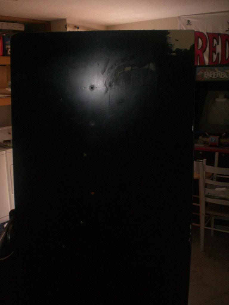

I rolled the paint. 4 coats of Rustoleum satin black. My wife bought me an electric sander for my Bday this year, and it was freaking awesome being able to use it. It prepped the surface pefectly. Im looking forward to finishing this up. As soon as we can get that "Super" side art repro'd again, I will do the same to the SPO in the garage.
looking good, what did you use for patching up? I would also spray the base with a little Rustoleum satin black as well.
I use wood filler (because the laminate was gone to the bare wood) when patching. It dries really firm, you can sand the crap out of it, and it takes paint fine. Good point on the base. I totally forgot about it.
