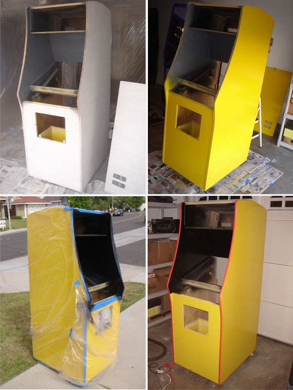

Pulled out all of the old components: A Pacman plus marquee, a Galaxian bezel, harness, power supply, and a very burnt monitor. I sanded down the entire cab three times over, going from 60 to 120 to 220 grit, and filled bolt holes and nicks with bondo.
Then the paint; again, all spray paint: Two coats of primer, sanding after with a 400 grit paper. Grey for the inside and white for the outside. Then the Sun Yellow for the outside and Satin Black for the inside. Finally a new set of orange T-molding.

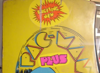

That's the first time I've seen the "Plus" sideart sticker for that conversion.
Anyone else?
Yeah..I've never seen those Pac Plus sideart stickers either...even in a few nos pac plus kits I've seen there were no stickers..interesting..maybe those were early stickers offered to see how kit would do on location or something..

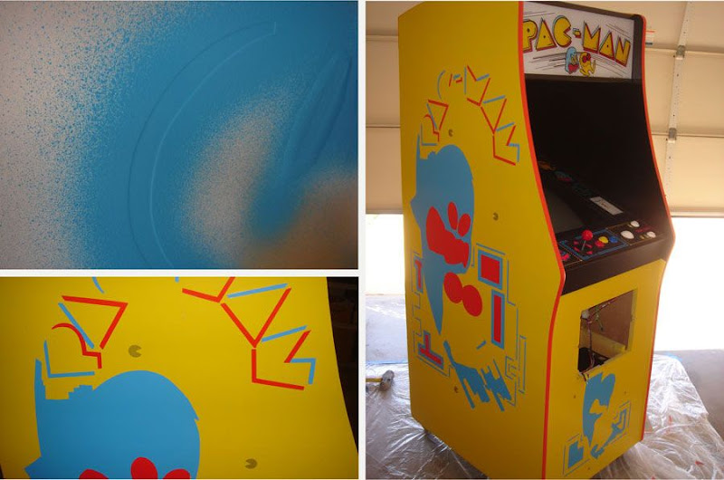

Alright; I finally got through the stencil job and got my pictures together for an update to this post. The art was definitely a lot of work, but its very rewarding to peel off the final stencil and see the finished pictures underneath. Again I have to thank Talon and Spyridon for their Pac restoration posts and picture sets. I read them thoroughly and used many of the tips.

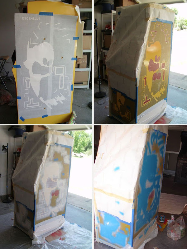

So as I mentioned before I'd done everything up to this point with regular spray cans mainly because I don't have a compressor and don't see myself ever doing something like this again. I'd read about difficulties using stencils with roller or brush painting, so I knew I wanted to spray. I picked up the best color matches I could find at Home Depot, and decided to try the Preval aerosol spray set-up which I purchased from Ace Hardware. It definitely took some practice, and some trial and error, but in the end I was able to spray these paints on extremely smooth. I would never recommend doing an entire cab with these, but for stencil work they're perfect.
Edit: I realized later that I actually switched my red to Behr "Red Hot", which was a slightly better match.

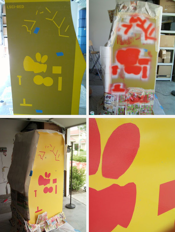

First up was the two red stencils for the sides. I applied these like dry side art as recommended in the other posts mentioned above. The went on very easily. I sprayed a coat of white primer under all of the red and blue just to ensure the colors weren't changed by the under coats.

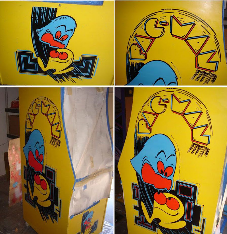

Next up was blue. The stencils were transparent which made it easy to ensure they were lined up. Of course just matching up the registration marks worked perfectly. Again I started with a coat of white, then two coats of color. Below is a close-up of the blue for the 'C'. The spray system I used got a very smooth coat with almost no orange peel. Once the blue stencils came off it started to look like a Pac.
Next up was the front red stencil, and finally the black. For black I went back to regular Krylon spray paint.
And finally the good part: Removing the final black stencils. The blue ghost on the front was the first thing I revealed. I had to touch up the mouth with blue to correct a mis-placed stencil, and am still thinking of filling in the lower part of the "C" with red. There were tons of tiny stencil pieces to remove.
I still need to figure out what I'm going to do about a clear-coat, and get everything reassembled, but its nice to finally see the side-art.
