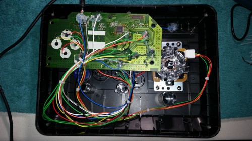

Hey All, just finished my second padhack/stick build, this time for someone else. A fellow Shoryuken.com forum member gave me the opportunity to try my hand at putting together another Genesis fight stick. This time, the Mayflash F300 case was used, as well as a Sanwa JLF and Sanwa OBSF-30's of the customer's choosing. There was a bit of headache dealing with controller PCB's that did not want to be padhacked, initially. But those hurdles were overcome, and what you see below and in the linked video is the final product. One cool additional feature that I incorporated on this one is the ability to switch between 3-button and 6-button mode on the fly.
Hope you like it. Thanks for looking!

Thanks, mate!
ebay or sometimes I see them come up on craigslist.
If ebay: "mayflash fightstick" or "mayflash f300". There is also an f500, but it seems prices are going up on all models and the f500 is over $100. :/ I have no experience with the f500, though and if it has sanwa parts out of the box then that's a good deal. Probably not, though, probably the stock junk that will need to be replaced, in which case >$100 is out of line, imho.
