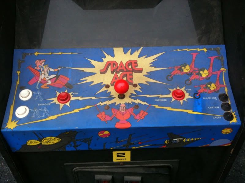

Completely filthy. Soaked it down with Simple Green for about 30 seconds, then went over it with Magic Eraser. Wiped it off, then soaked it with Windex and went over it again with Magic Eraser. Wiped it clean and...
Before (with flash):
After (with flash):
Before (no flash):
After (no flash):
Amazing. Looks like I need to go and pick up some Simple Green!
Man, that looks great. I have yet to use a magic eraser. Though, I've heard and seen good things about it. Most of the CPs I've worked on are far too gone to just clean up. I end up having to replace the CPOs.
Looks great. I was already on the Magic Eraser bandwagon. What I think is crazy, is when they converted those mappys to Jr pac's the went right over the mappy CP that has a button hole it in. It's amazing after all these years it hasn't ripped through.
I get better results with Greased Lightening than Simple Green.
Drench it in GL, allow it to drip down the panel, then spray down with Windex ans wipe dry.
These 4 panels were as bad or WORSE than the others pictured here in this thread (wish I had the BEFORE photos to show you)
