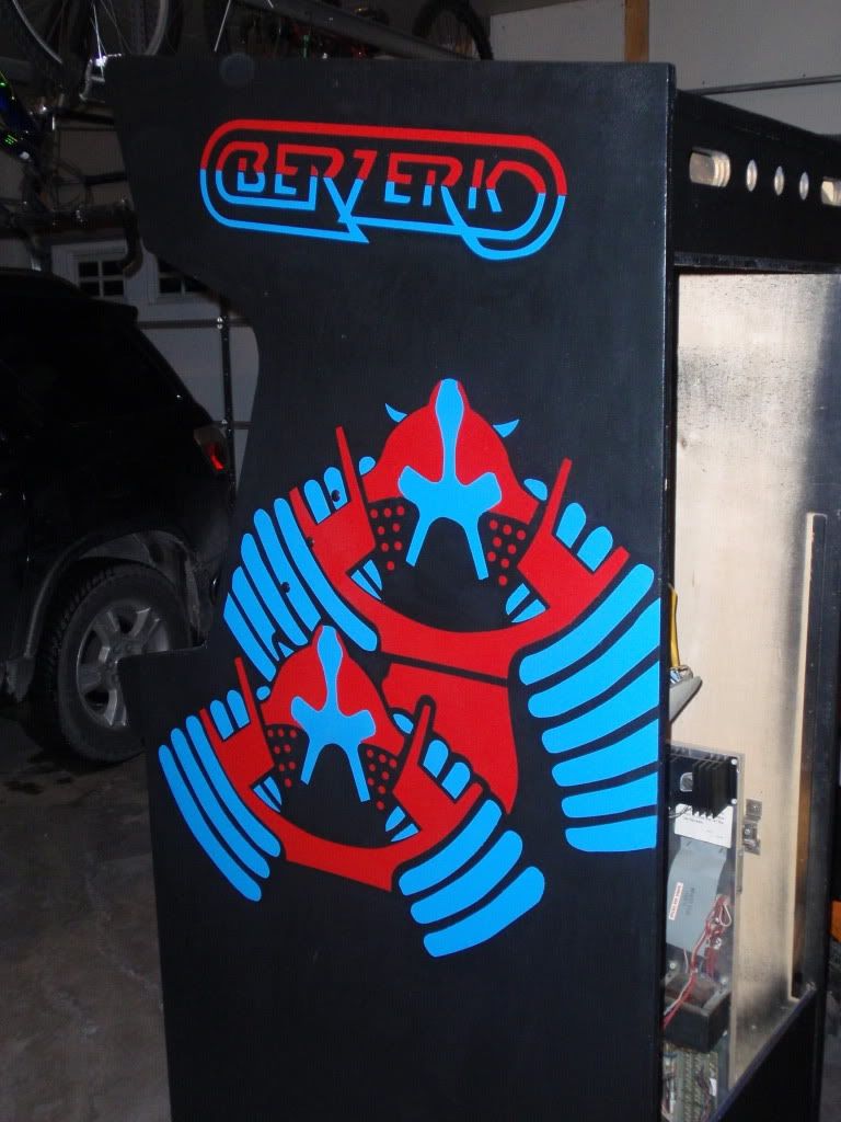

Berzerk stencils
Started doing the stencils on Friday night. Here it is all ready for the blue.
attachment.php
attachment.php
Shot of the finished blue.
attachment.php
Ready for the red.
attachment.php
attachment.php

After removing the red stencil.
attachment.php
attachment.php
There are a couple places that need a little touchup, but all in all pretty happy with how it came out for being my first attempt at stenciling.

Yes. It uses 1/4" staples up to 1" long. Picked it up at Lowes. Wish I had sprung for the 1 1/2" max staple size.

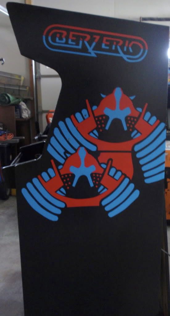

You know, it looks as good as it can. When I stencilled mine, I never was completely happy with it because of the stupid sand texture. You can see it looks OK, but not perfect:
I clearcoated mine which helped even it out:
but the 2nd coat gave it a glossier finish:
I love Berzerk as a game, but the factory treatment of the cabinet was sub-par for sure. Hell, they didn't even add the 2nd horn to the little robot. Now get it in the game room and play it.
Phet - when you clear coated yours, did you spray from a rattle can? Seems like it would be real hard to get it covered evenly (at least for me). Also, did you do anything to try to even out the edges on the stenciling?.
The clear coating evens it out. I used a high quality varnish brush and a thinned poly so it would self level better. The cab is so textured you can't even tell. I played the shit out of this game last night and got the 2nd place HS of 7800.
