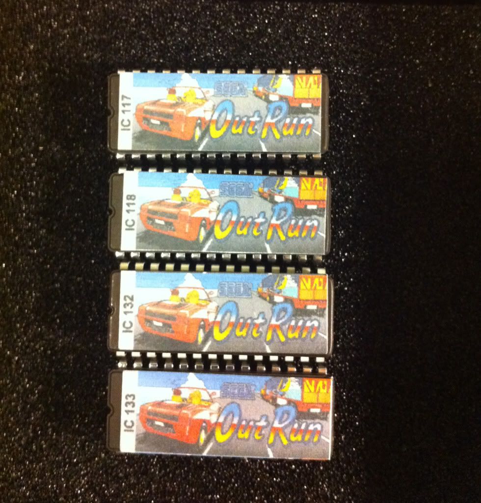

For those of you that bought the eproms from me.. They are ready to ship...
I also got in my lot of super capacitors for making kits.
The code seems settled so i'll try to order chips for kits tonight. I'll build as many as match the number of Capacitors. This is just a service really to keep busy. I'm not trying to make money off of these guy's wonderful contribution to the scene.

ToplessZ, Is it you that is selling these ROM chip sets on Ebay? I saw them on there a few days ago.
$30 +$5 shipping for a set of four 27c512's? That seems a bit steep, considering this is not your work.
Occasionally someone will ask me to burn a chip I did not produce (e.g. Tim's Tron freeplay). For the smaller common EPROMs (<=2Mbit) I never charge more than $5 each. You're free to charge whatever you like of course, but I personally don't feel right profiting from the work of others.
