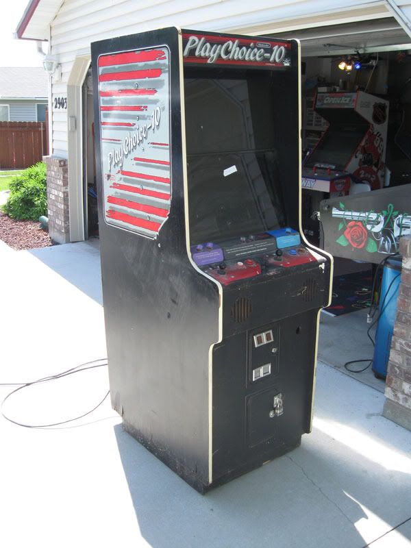

May I present to you.... my $25.00 (minus $3.50 in quarters I found in the coin box) Playchoice 10.

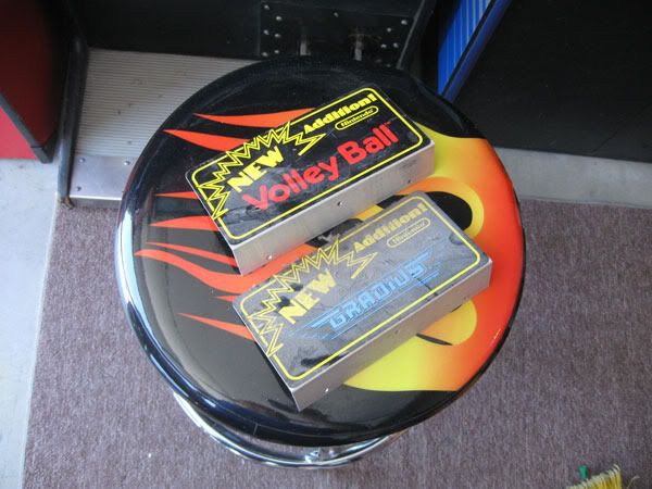

A couple toppers came with it...

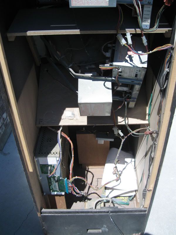

The cab is in SO SO condition...it's seen moisture but none of it got inside. I don't know if the cab works or not as there is no power supply.
Will the power supply in my Super Punch Out work with this PC10?

The cabs themselves are toast... T-molding falling off... side art vinyl coming off the RTR... a mess. the PC10 did a little better because it was under a tarp evidently... and it's ply.
Any advise on the PS? I'd like to test the cab with my Super Punch Out PS if that'll do it.
The PC 10 used to be a Punch Out so borrowing the PS from your SPO shouldn't be a problem. Getting a Nintendo PS or switcher put in there, should be easy enough. I would definitely agree that for $25, you sure took that one. I don't need one of those, but I wouldn't have turned that down. If I had one, it would be a novelty and probably wouldn't get played much but for $25, you can't really go wrong. Spare parts for your SPO, if nothing else.

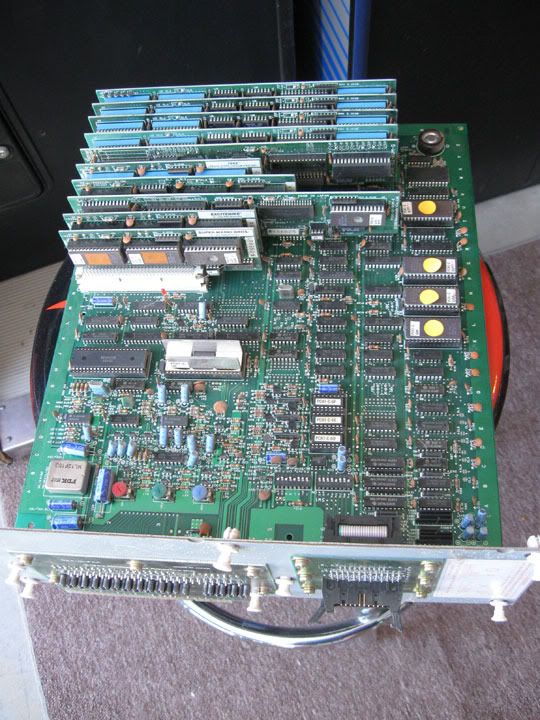

Welp... she's pretty much non-working (what did I expect)?
I get a semblance of the select screen up top... I can move around ... the but graphics are corrupted with letters and a bunch of crap. I can select games and what not but the main screen also comes up all garbage...
The top monitor has some collapse but the color is there.
The bottom monitor comes up all purple and with what appears to be some geometry issues.
Both click once in a while (and the image jacks up when they click)...
Bottom line: The PC10 System is toast. I wish I knew someone local I could test the games on though I'd be wiling to bet they're fine.
