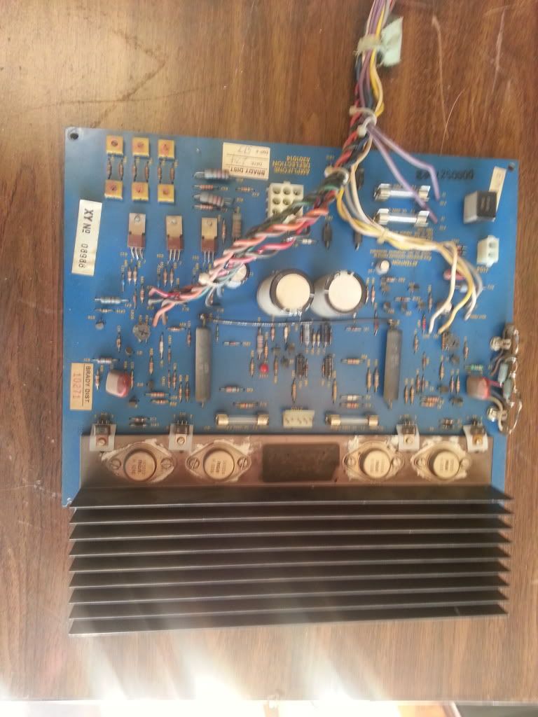

Here's one board:

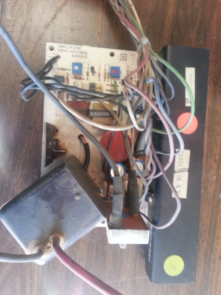

Here's the other:

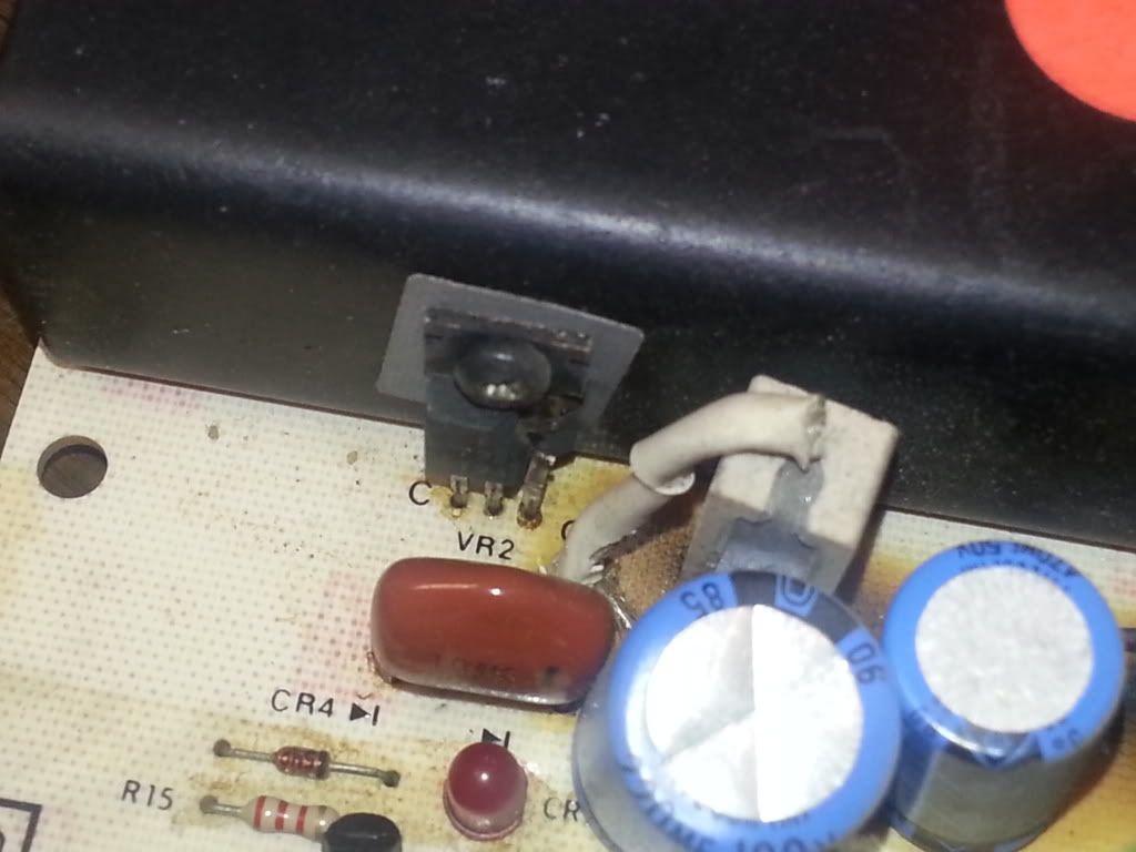

And the blown transistor:
It has a wintron so don't replace it unless it isn't working. If it was red then you would replace it no matter what. I don't care what anyone says, Wintrons are better than the new repro's but the new repros will still work.
Looks like something shorted and caused that transistor to go boom. Might as well order a BU406D too because chances are it's going to be bad.

agreed...Wintron is what you have on there already and not the original RED fly. keep it on there and work around it. someone has already tried fixing it if it has that Wintron on it!
yes order a couple BU406D also....i blew several before i got it installed right :(

That "transisitor" is labeled "VR" on the board, which means Voltage Regulator. I suspect something went to ground somewhere on your board, or went open.
Be careful. Unless you find what let the smoke out, it's likely to strike again.
