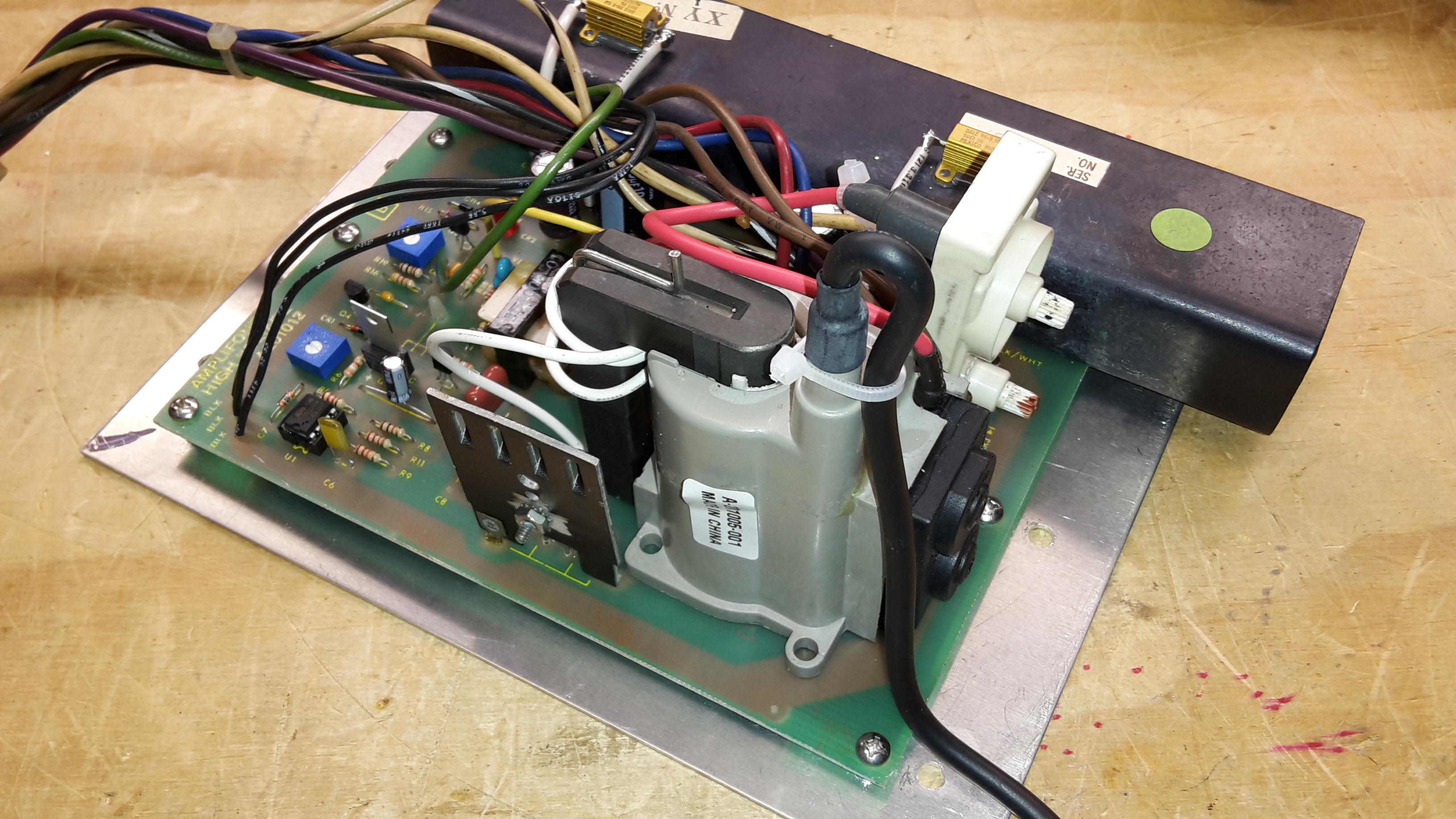

I see arcadeshop and alanone, there's also ttl versions floating around that can be made, don't know if there are any differences between the options available. I'll add pictures of the resistors for the fun of it, one of them has literally burned a hole through the PCB. I'll check out your video to see what kind of resistors you use.

Other than from a cleanliness perspective, unless the wires don't make contact with the pins (check the groud pin in particular), no worries about the neck connector.

But now I know which resistors are in question.
How did you attach them to the heat sink? Some kind of thermal epoxy? I don't see any mounting screws.
That's not my handiwork. But shows a typical "upgrade" to get the resistors away from the PCB and provide some better thermal management.
If I was to do that, I'd drill some holes and screw the armors into the sink fin. YMMV

Well it lives to display another explosion, or a few. I just ordered a bunch of shit from apar and shotgunned the heavy lifters. one of the big resistors was dead dead, 7924 was dead. the heat from the resistor killed c13. I replaced both regulators, replaced the bu409 (that was working, whatever) with the 406d, the diodes on the back got changed. I got the same resistors that charlie did, but I went the lazy way, instead of trying to land them through traces in the right spots, I mounted them up top and wired them through the holes the old resistors already burned through the board. I didn't have any screws on hand so I decided to use what I had on hand to mount them.
