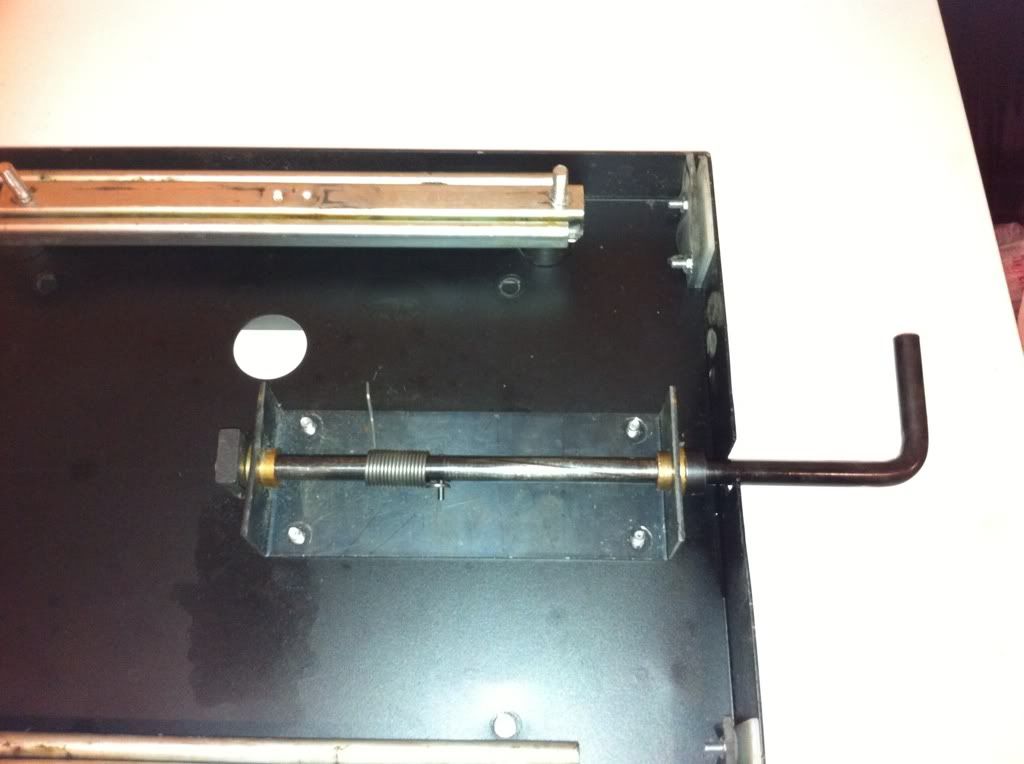

I'll start it with a repair of a seat adjuster on one of mine.
Sometimes my odd tools come in real handy!!
Someone was ANGRY when they did this... pretty tough assembly to mess up...
I didn't realize it was so bad till I took the seat off.

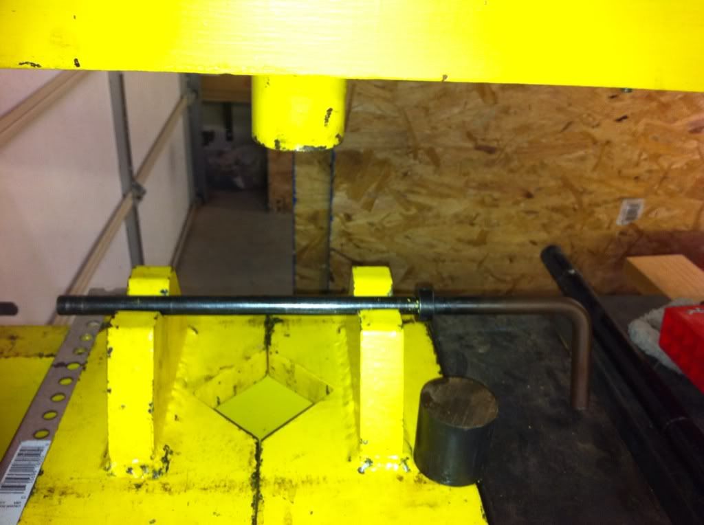

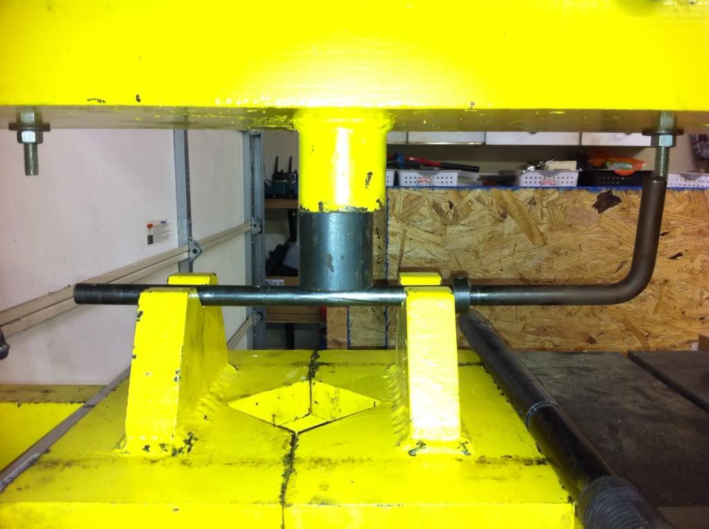

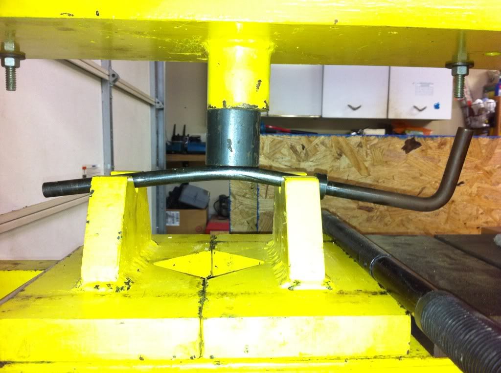

I have a homemade 30 ton shop press which didn't even strain to straighten the shaft...
Shaft is now almost straight... had to do a few presses to get it perfectly straight.

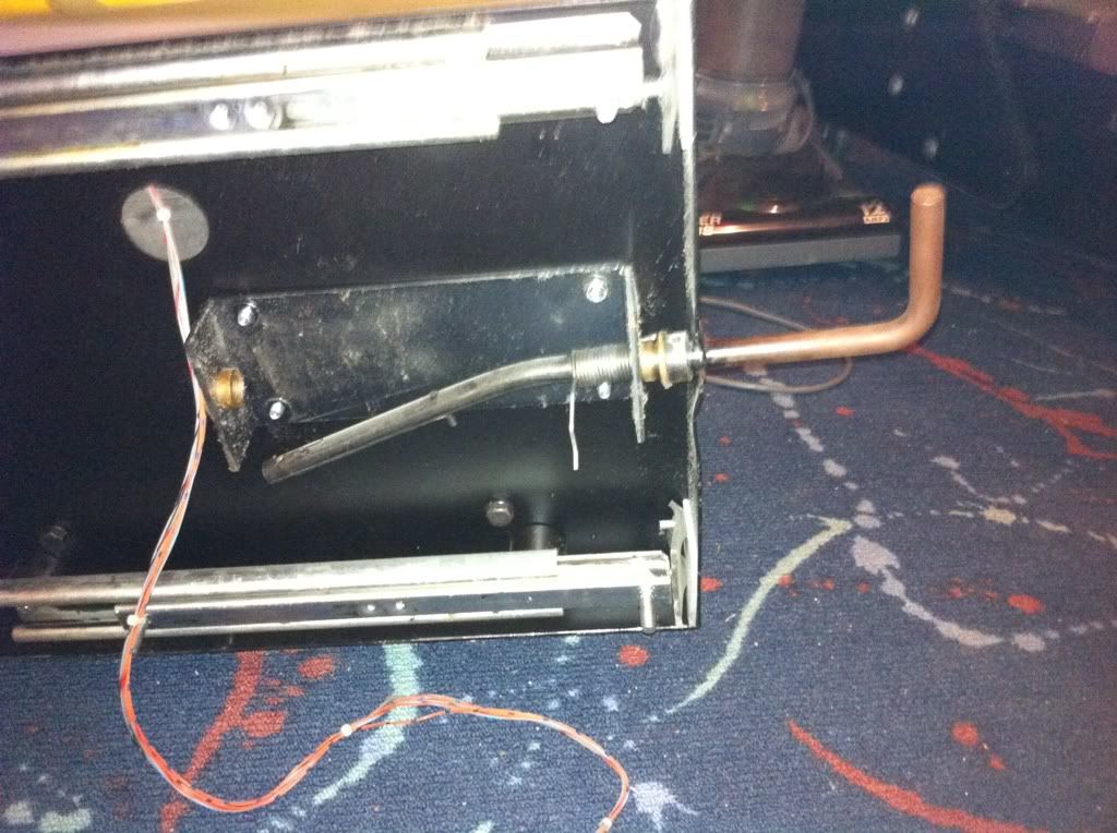

Repaired shaft is ready!
Reassembled adjuster on the seat.
A pin was sheered on the metal tab on the end... $0.40 or so at Lowes.
The metal tab itself had fallen into the machine, glad it wasn't cleaned out!
Had to do a bit of hammering on the seat base to get it straightened too....
