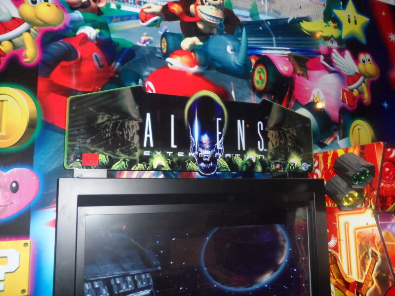

Never seen one of these in the states. Found this in an arcade in Chonburi, Thailand. Anyone seen this before? I was going to record some gameplay, but the guns weren't registering on the screen. You'd see the trigger flash, but nothing would register as being hit. "This is BOGUS MAN!"

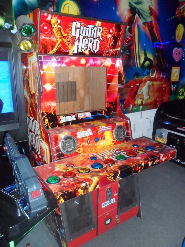

There was also a "push button "Guitar Hero" next to it. Seen the one that look just like this before, but it had actual game guitars. It, of course, couldn't be played either as it had no working monitor. Never seen one like this...

Well, what was weird about this was that the trigger would flash the screen, along with the grenades, and the flamethrower, but nothing would register any damage on the enemies. I thought it might have been an issue with the LCD not being able to register the photocell on the gun, but the barrels are covered over. Not a traditional light gun setup. I just let it eat my dollar and left.

That GH cabinet is nuts. I don't think I would like playing it with buttons. It's Guitar Hero... not Aircraft Carrier CP Hero.

We have one, the deluxe version with the plasma (well, could be an LCD) screen. (NOT the one in the pic -- that's some kind of messed-up conversion. The REAL deluxe dedicab has a larger screen than that in a flat metal box with blue mood lighting on the back.) IMO, it's a terrible game. By default, it scales the amount of damage done to you by how long it's been since the last credit -- so each credit is forced to last a fixed amount of time, regardless of your skill. This time is adjustable in the operator menu, but if you turn it off completely, the game becomes so hard most people die within the first six seconds.
So it's punishingly difficult, or downright unfair -- operator's choice, and those are the only choices. It's expensive because it attracts non-gamers that like the theme, so in an FEC environment, it earns pretty well. Expect it to tank HARD in an actual arcade though -- people with any semblance of skill will catch on quick.
I did a post here about it a few years ago when I fixed the guns on one here in Austin. The cabling was made a little too tight inside the gun and was causing stress that would cause the x/y to not register properly. After I fixed it and e-mailed them about it, they came out with a service bulletin listing the same approach I used...
