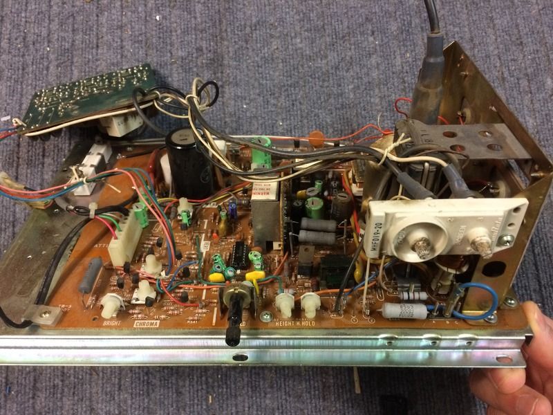

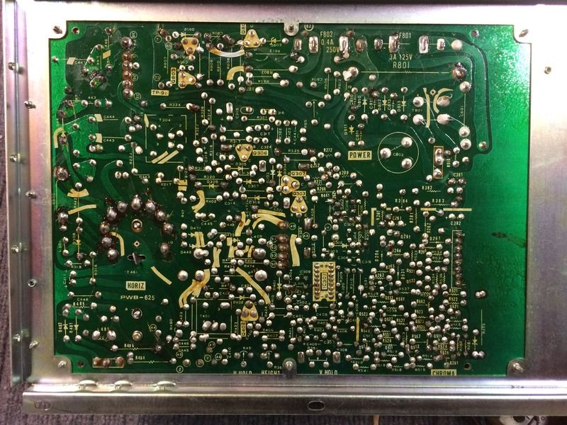

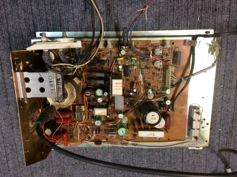

I happen to have a couple of these monitors. One loose and the other in a generic cab running a bootleg double layer blue DK. Jr. board. Each missing stickers but enough between the two that I was able to gather some info and get over the hump to figure out what they were. Here is what I worked out, all gathered together, in the event anyone else goes searching and finds it helpful.
Also known as Ati CR-M-19VH
One of mine has a sticker that says Handewell Corp. of Los Altos Ca.
Info with pics of the chassis:
http://forums.arcade-museum.com/showthread.php?t=75289
Pin out is a little different:
Starting from the back of the monitor, closest pin as you look past the neck is Red.
RED GROUND GREEN GROUND BLUE GROUND SYNC
Testing my board on a 4600 I discovered it was Negative Sync so I would say the Sync pin on the CR-M-19VH expects negative sync.
The tube is a 510SLB22. It sets up just like a "typical" arcade monitor (IE G07, 4600, 4900, etc...) on my Sencore. So that is the standard 23 adapter an a B&K.
