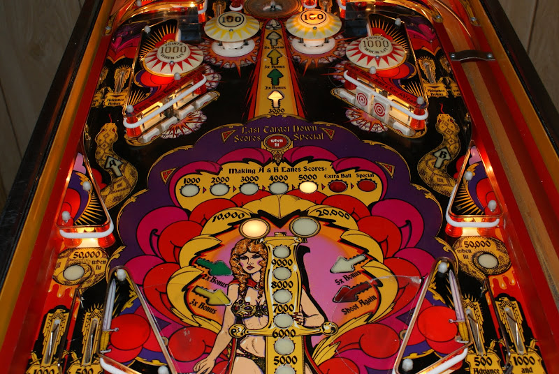

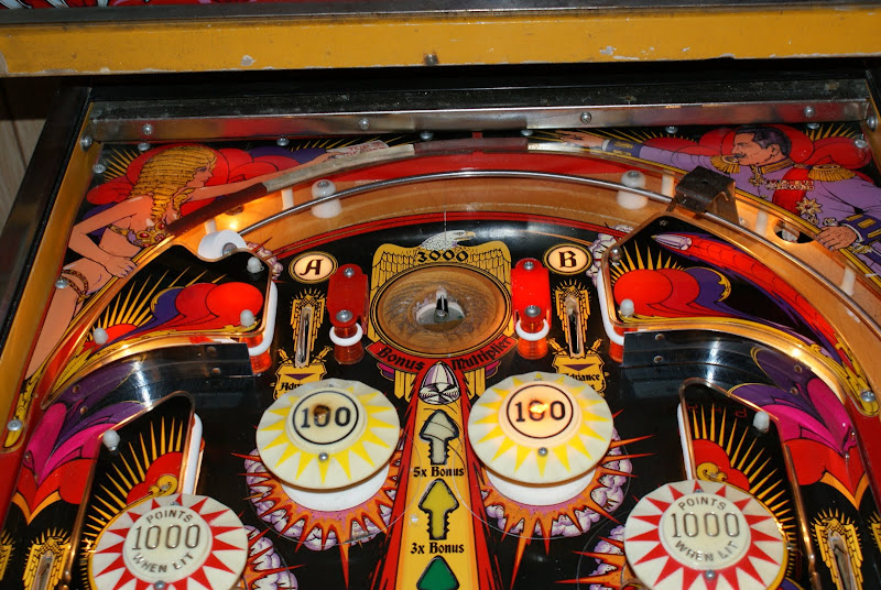

Next question, how much wax is TOO much wax? I've got the first coat on. Maybe it's a bit thin, but it's on. I'm thinking it only took like 5-10 minutes to wax the first time, maybe I should do 2 or even 3 passes?
I'm doing circles in the tin to wax up my rag, and then i put enough wax on the playfield to make it hazy, but not overly "waxed". Then buff, buff, buff, buff till everything's shiney.

Playfield - Stripped, Cleaned, Waxed, Waxed again (touch-up, don't think multiple coats are necessary)

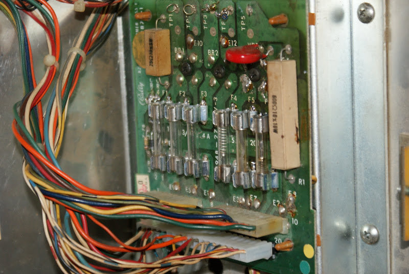

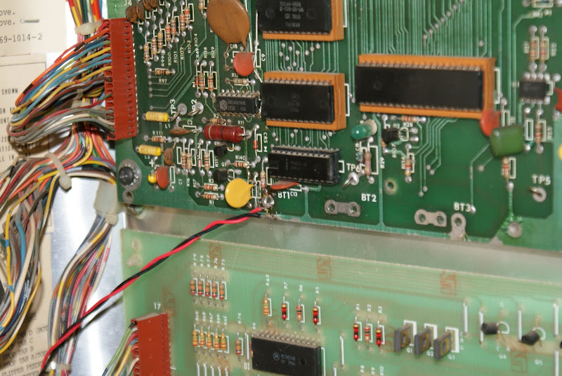

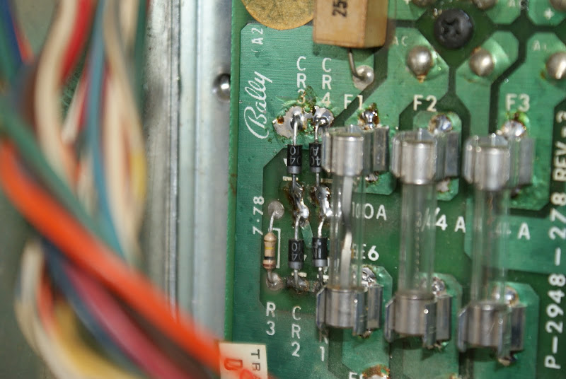

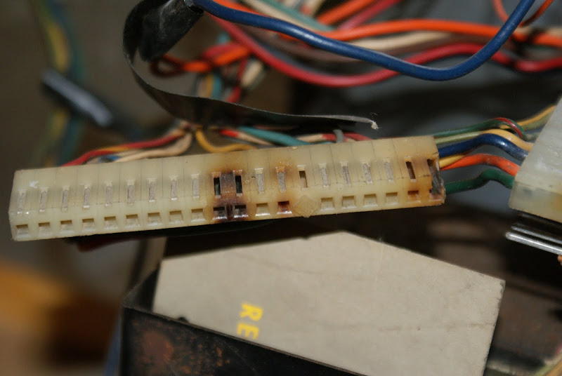

Rectifier Work-over - fuses, fuse clips, J3 header and connector replacement, current mods from pinrepair, C1-C4 diode replacement (Yay, 220v instead of 150v!)

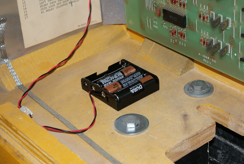

MPU Work-over - Battery holder mounted (with 1n5817 diode), grounding mod

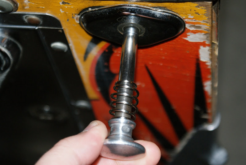

Plunger - Cleaned, Replaced springs, replaced tip.

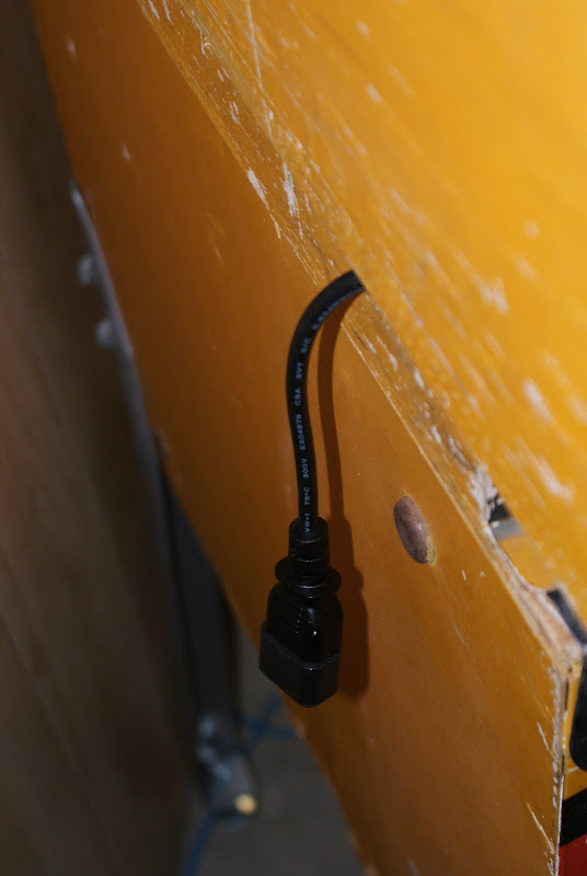

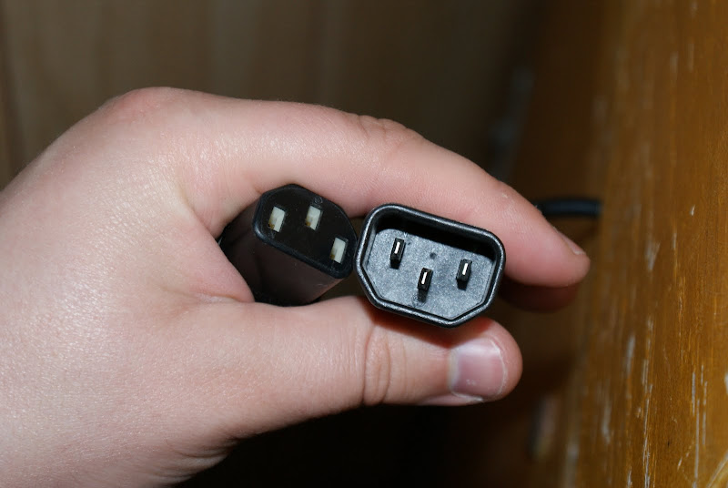

Power cable - Old cable didn't have proper grounding, replaced in favor of an IEC-C14.

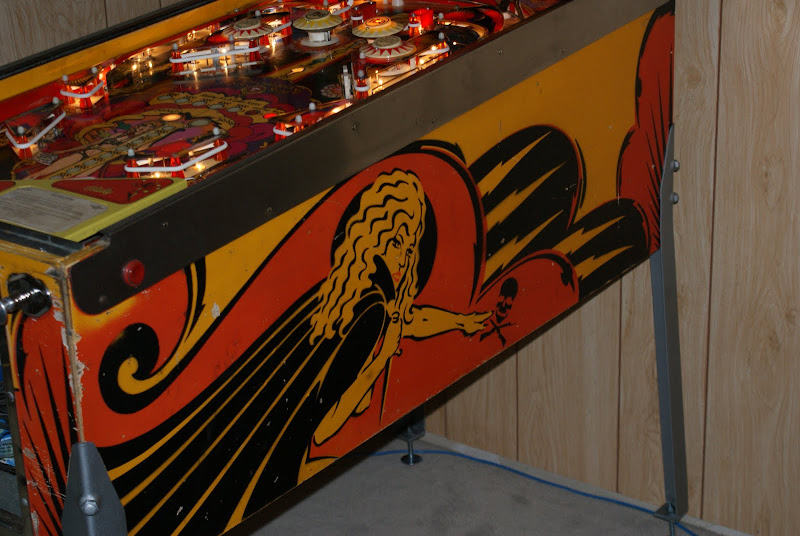

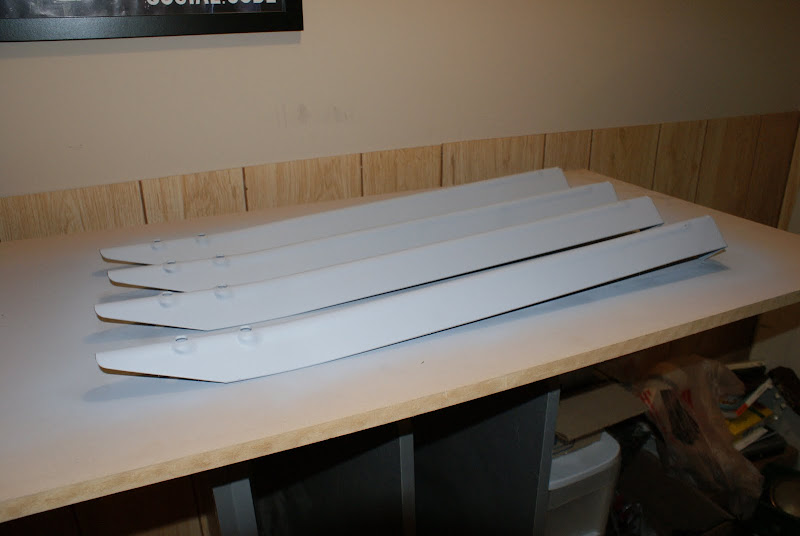

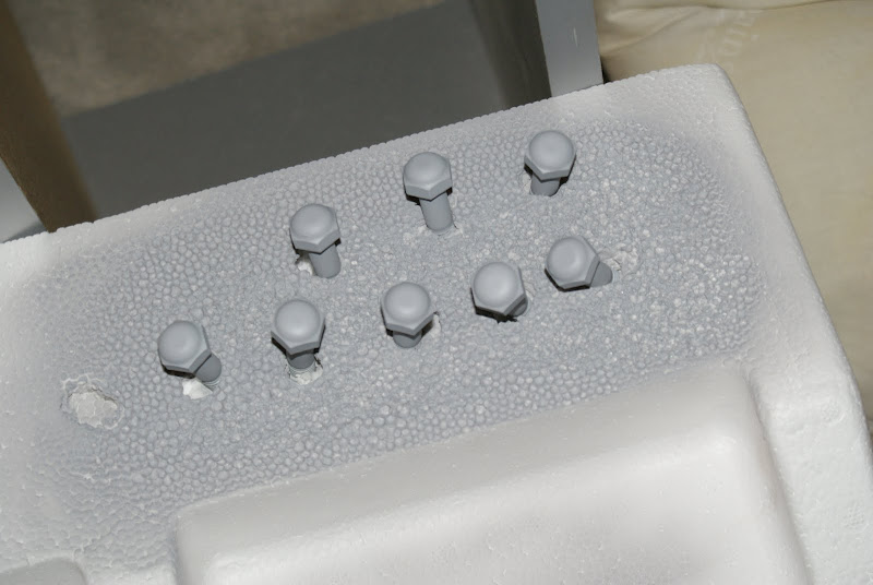

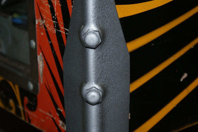

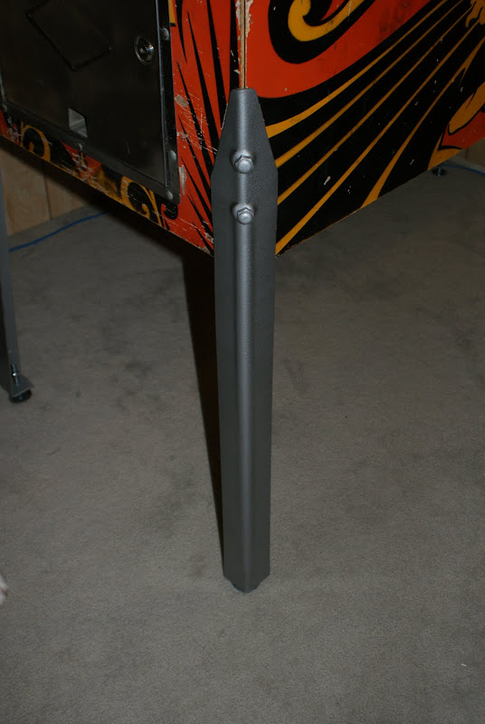

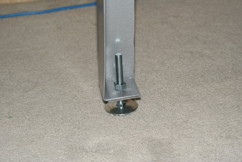

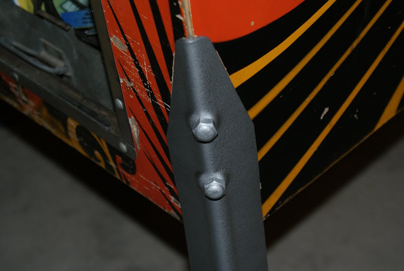

Legs - Straightened, Acid Bath, Wire Wheel, Spray Primer, Hammered silver paint, new levelers, repainted bolts

I told the girlfriend she wasn't allowed to play it until I got this far. Last night she had THE first game on it. Changed her whole perspective of my hobby :D:D:D I wanted her first game to be a fun one. The new rubber, ball, wax, and bulbs really payed off. When I played it, it was slow, noisy, the rubbers bumpers and slingshots did nothing useful.
Now it plays like a dream, the ball moves nearly silent, and it bounces all over the place. The pop bumpers really do POP, I mean they REALLY move the ball now. She lit up the 1000's, and got the ball blasting around them, the chimes were going ballistic. It was truly an awesome sight to see. Now I need to get some AA's in there to save our scores!

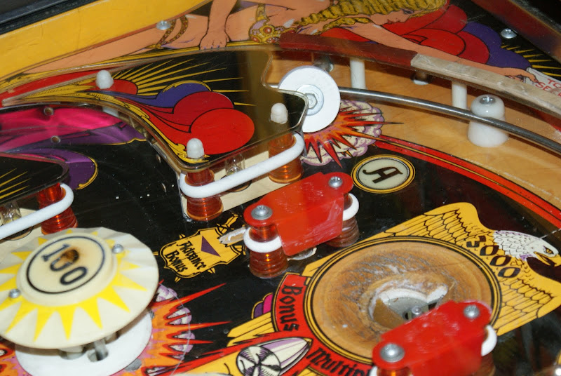

Replace Bumper caps - "100's" have some melting
Bulb Holders - 3 pop bumpers, 2 sub-playfield won't light up, 2 sub-playfield bulbs very dim

Here's the legs, all straightened up and primed. Forgot to snap a shot of before, after acid bath, and after wire wheel, sorry!
... and the bolts...
Quick shot of the legs on the body
And a close-up to show off the hammered finish
Another
...ahhhh nice new leg levelers in!

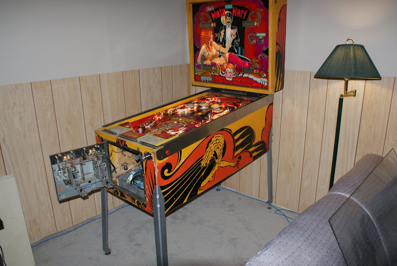

Here's some shots of the cabinet...

What's this cord hanging off the back of the cabinet?
Oh nice! IEC-C13/14! Now we've got a standardized cable, that can be detached!

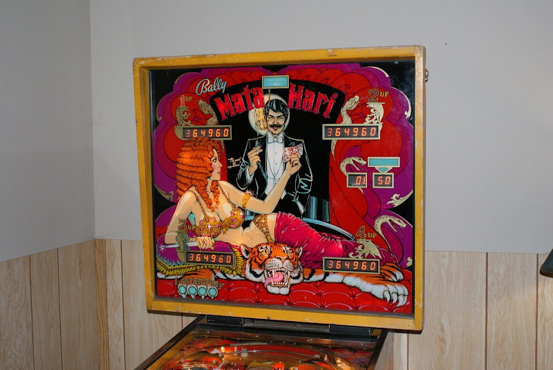

Shot of the backside of the backglass GI
and a closeup of my serial number...
Rectifier Board work, here's my new fuses!
And the culprits responsible for my low voltage to the score panels. All new diodes, but messy flux :S

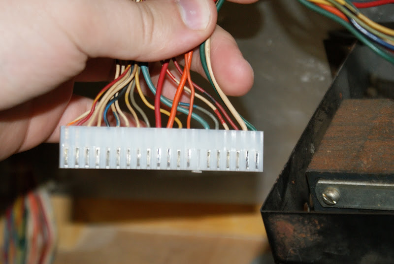

J3 repair...
from THIS...
To THIS!!!
MPU after-shot, with wires leading to the battery holder
Close-up
And the battery holder

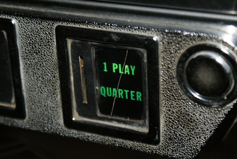

Coin door all cleaned up...
Might need to replace these inserts... one's scratched, the other is slightly melted.

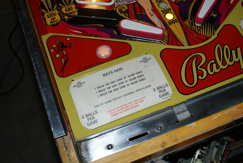

Skirting... not sure why it looks yellow in these pictures. In reality it's pretty green.

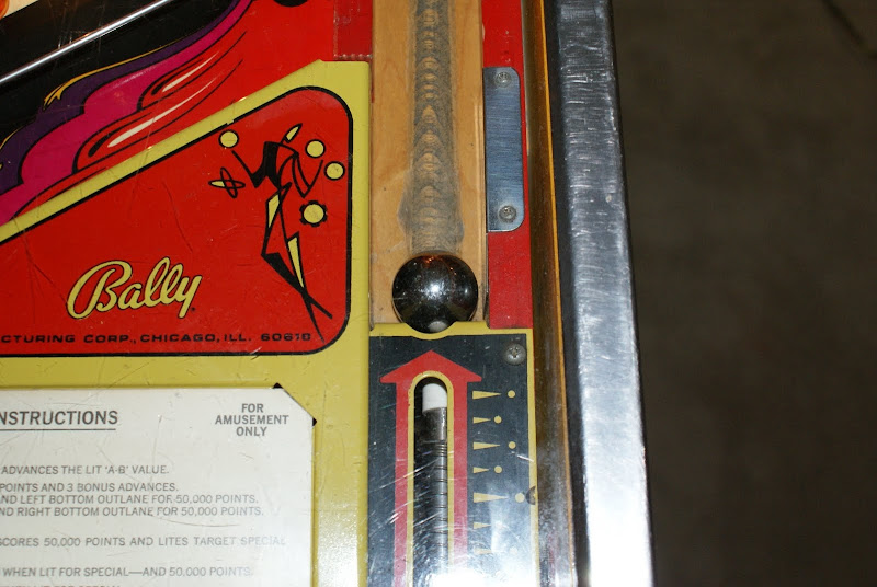

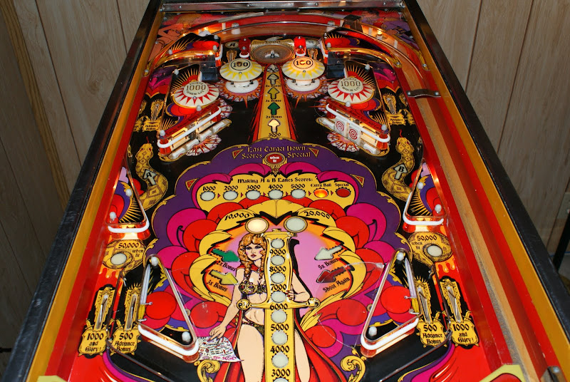

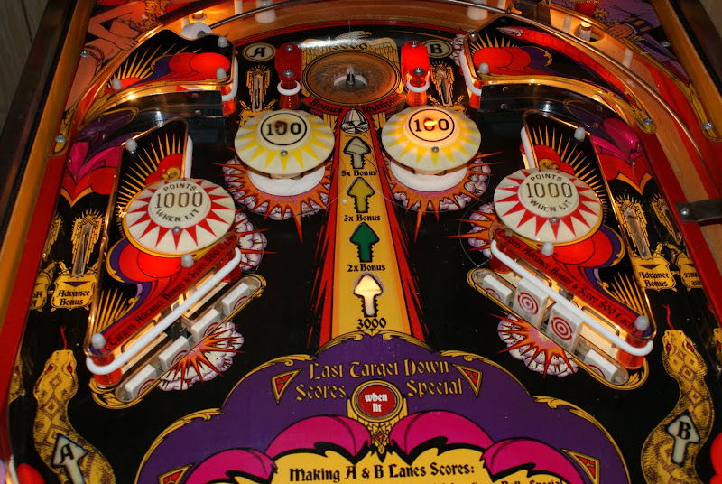

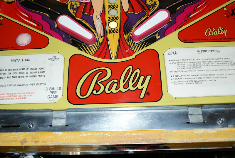

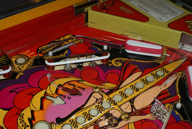

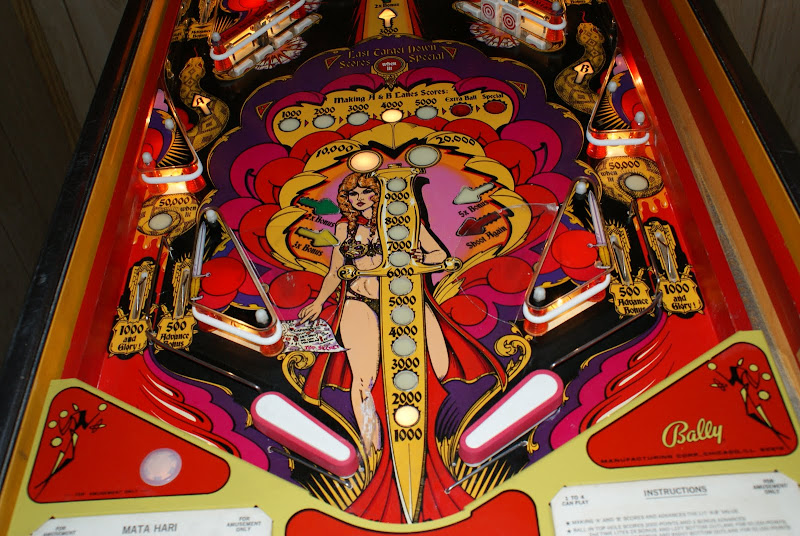

And working my way up the playfield. It's in awesome shape minues some black fading around the inserts, and some wear on the left flipper. Looks like a rebuild's been done since, as the flipper no longer drags.

Debating removing the mylar, but it'll probably wait till i do playfield paint touch-ups...
