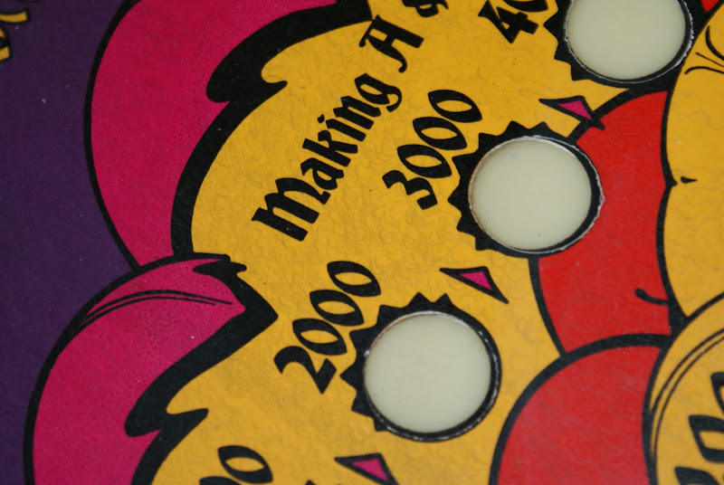

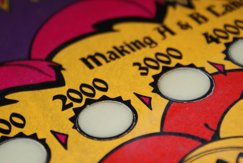

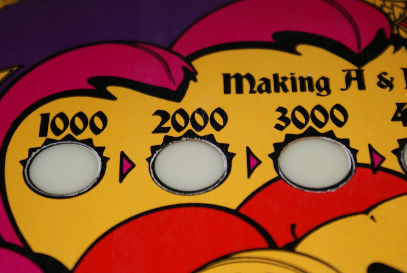

Went through my parts to make sure I had everything. Grabbed some general stuff from Wal-Mart to clean up the playfield and...
WOW!
I just took a magic eraser and some rubbing alcohol to a patch of the playfield...
Here's a couple shots of before:
And here's an after shot.
There's no camera blur here, the color actually came out that solid! Looks like I'll have to touch up some of the black parts. Nothing a good old sharpie can't fix up.
