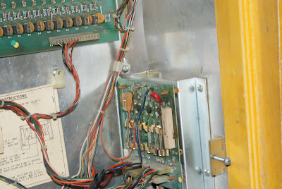

Checked my fuses tonight. Decided i needed a better shot of my Rectifier board.
Waitaminute... what are these wires running off the test points?
Oh, how nice, J1 is all torched up, and the wires are spliced in and connected to the test points!
No worries, connections look stable enough, but let's take them off while we're testing voltages, just to be sure our rectifier is isolated.

That style of rectifier board is burned/hacked more often than not. Soldering the wires to the test points actually works quite well. I'm not condoning it but it will work just fine until you can replace the connectors.

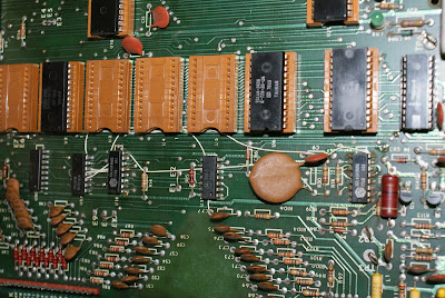

Day 3 of the pinball experiment. Pulled the MPU and i'm snooping for some corrosion. Looks like the MPU has had some work on it already. There's white wire soldered in between some chips...

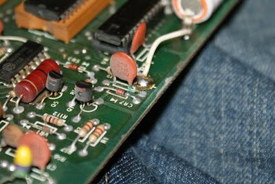

More snooping around the board and i found THIS! Right beside the battery!
A bit of corrosion on that capacitor and diode. I may end up taking the board in to my local electronics shop and seeing if they have any replacement parts for the ceramic capacitor and the diode beside it.

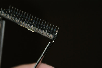

Time to pull out and reseat all the socketed ICs. I pulled them all out and gave the legs a brief scraping to shiney them up, hoping that would solve some potential conductivity issues. Noticed Pin 21 on U9 is missing!
Not sure if that's standard or not, but it's the way it is. Continuity still checks out between the IC leg and the bottom of the PCB. Oddly enough though, there's no continuity between the legs when the cpu is removed...
Any suggestions?

Removed the battery, cleaned up the corroded capacitor, and replaced the 2 diodes with brand new 4148's, hooked up the MPU in the head with the rectifier AAAAAAAANNNNNNNDDDDDDDDDDDDDDDDDD......
