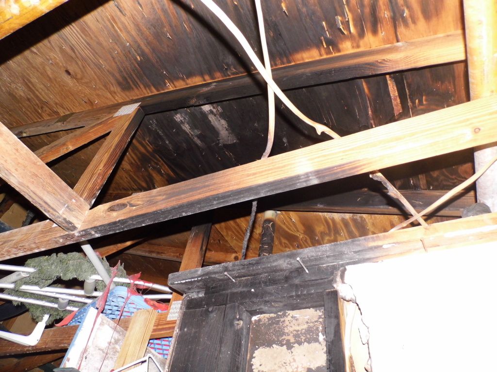

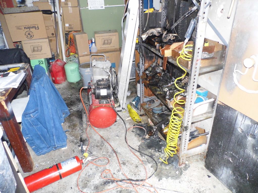

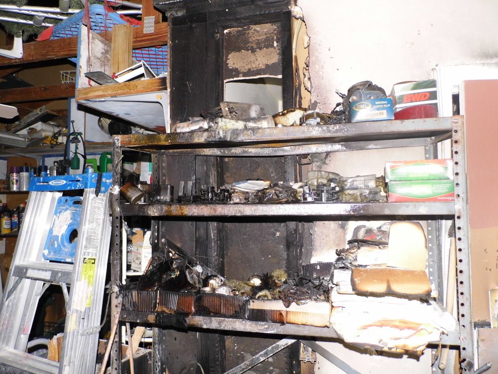

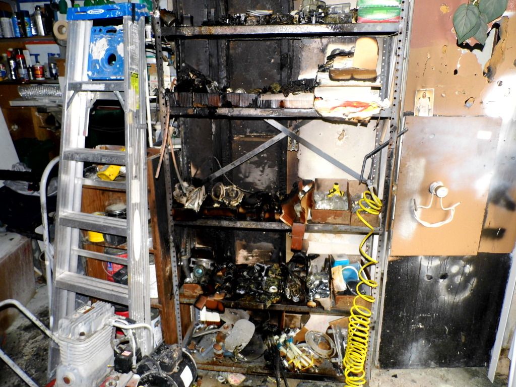

Just be careful what you plug it into,my shop at work caught on fire 3 weeks ago as a result of a compressor/extension cord. I was able to put it out but just barely.
