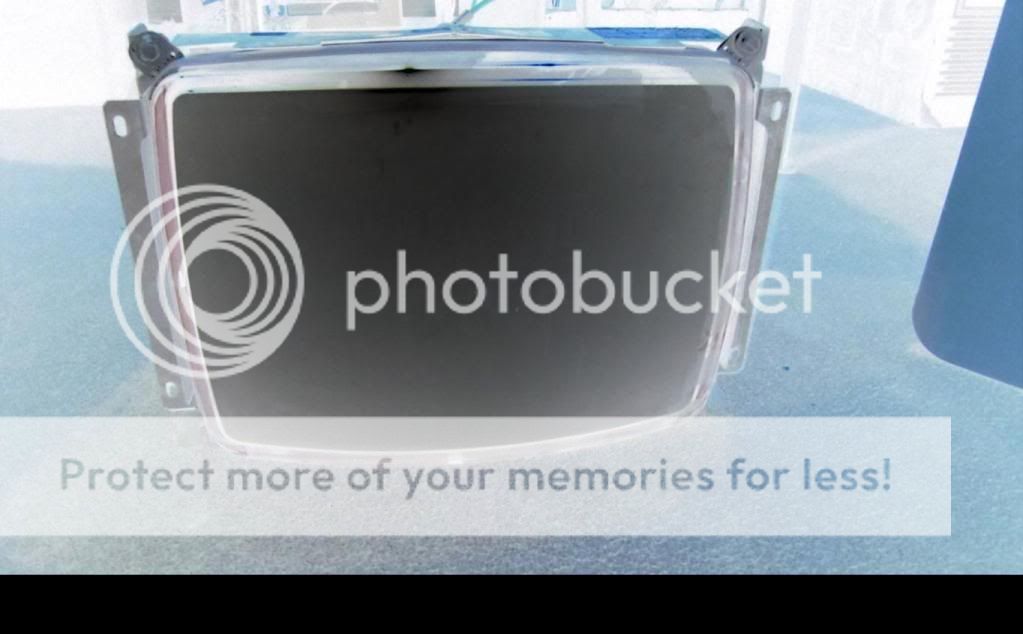

I can see some burn there, though it is nicer than any vector display I have. Here is a color invert version for your viewing pleasure / displeasure:
I'm still not seeing it. Perhaps I need to look at it under ultraviolet light to detect it. But man, if it's true I am so disappointed!
Fixed....
( you asked for it )
:) Well I got to experience that one recently as well! Not with a Tempest though.
This one is destined to get a BR Deluxe rebuild kit and hopefully it will fire up. I think I'll just put it back in the little Tempest cabaret. The 6100's in my other games all look pretty darn good already. I'll have to eyeball them all closely though.
squint at it. if you look hard enough, you can see the "tempest" across the screen about 1/3 down from the top, and below that the (c) ATARI MCMLXXXI
its nicer than 95% out there(nicer than 99% of all tempest), but in the regular photo, you can see the words tempest, the tube image marks and a spot killer dot( or someone turned it up too bright)..
