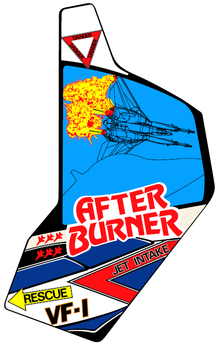

coming out awesome! I just need any bezel sticker, mine is missing completely as well as my throttle plate sticker. who can print the ones you uploaded??
**videogame parts has all of em except these two LOL

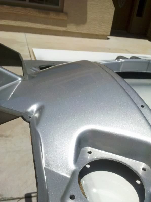

Was able to 'work from home' this afternoon and knock out part of the bezel refinishing. I would have liked to just scrub this bezel and reapply decals, but the cigarette burns weren't coming out - so time to reshoot it with color.
Stripped the decals from the better of the two bezels I had, took it down with 600 grit wetsand, shot it with a automotive basecoat/clearcoat. Had some leftover paint from my former 350Z; the silver was a pretty darn close match for the AB bezel (paint code KY0, 2005 350Z), and luckily for me, had just enough slow reducer/hardener since temps were over 100º this afternoon. New color has metallic flake in it - makes it stand out just a bit - I think it looks sharp, myself.
Would have been nice to shoot this in a booth, but caught the weather at a nice point where crap wasn't flying around in the air to end up in my paint (no haboobs today!). Clear laid down very well, happy to say. I'll let that sit for a couple of days before applying the NOS decals and new monitor screen bezel.

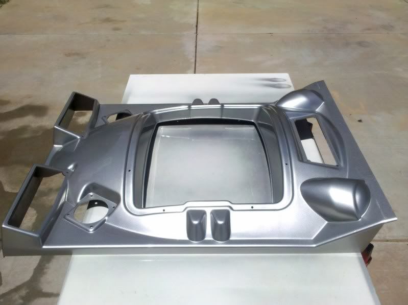

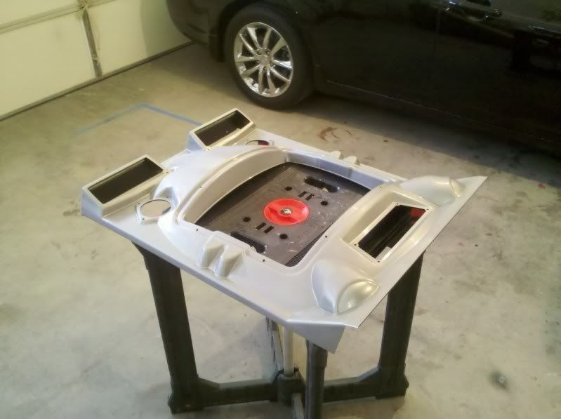

Stripped and sanded:
New color and clear:
Clear laid down nice with the slow reducer; high gloss and no orange peel:
That looks simply beautiful. What brand Basecoat/Clearcoat did you go with?
Thanks - I shoot Martin Senour and Ultra 7000, affordable stuff from Sherwin-Williams since things like this are hobby only and no way related to the day job.

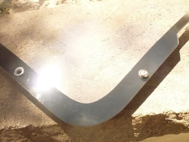

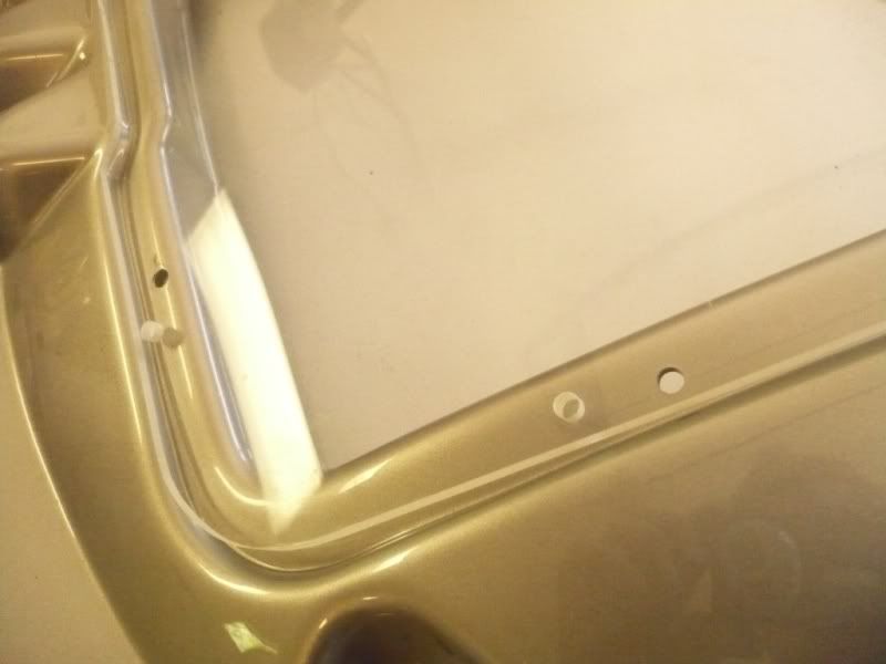

Frustrating setback today - my NOS windscreen replacement doesn't fit my newly painted bezel. It fits my donor bezel just fine (and yes, I did flip it around just in case) - screw holes are distanced differently on the new bezel.. WTF?!
*sigh*

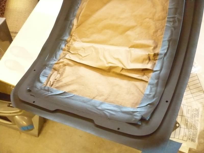

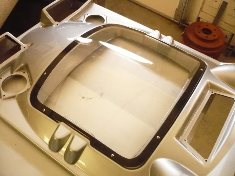

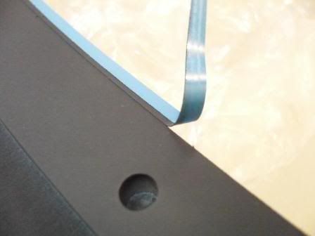

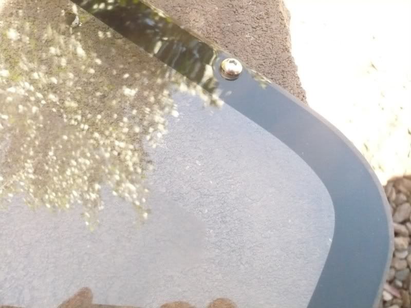

So, I just sat and looked at it for a few minutes, I'm pretty disappointed that there apparently are two different bezels out there. Came up with the option of shooting the inside of the new NOS plexi *gulp* to hide the screw holes. I tested it out on my donor plexi, and had some chrome hex screws that I think will work well for the project. Luckily I had some fine-line vinyl tape on hand to have a sharp, accurate bend... looking for thoughts on the matter:

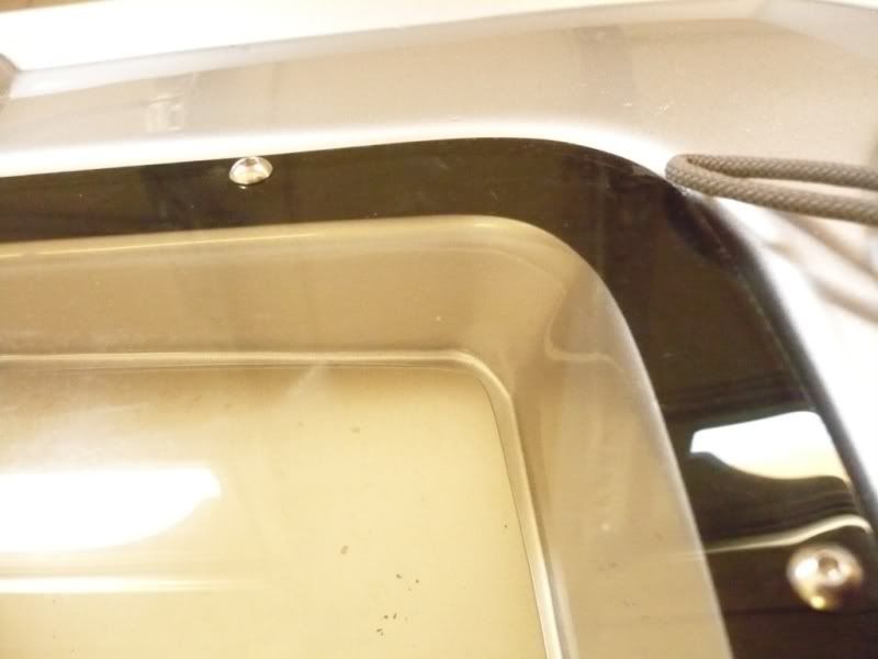

Well - did it - looks like it turned out OK. Fine vinyl tape is great to create a sharp edge; the paper tape didn't cut it on the donor plexi. I used small strips of electrical tape to cover the holes before applying the plexi - spray pain doesn't stick well to this plexi, and you cannot sand it prior to spraying, so it was *very* prone to scratching which is markedly visible on the front. I believe the chrome buttonhead screws worked great with this color combination.

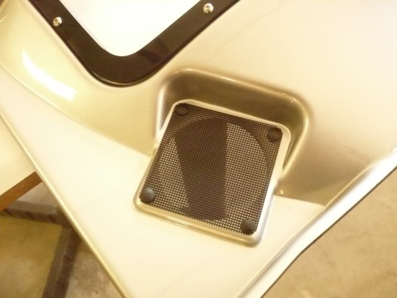

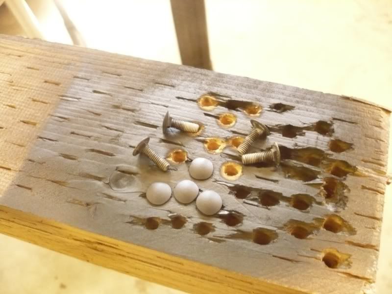

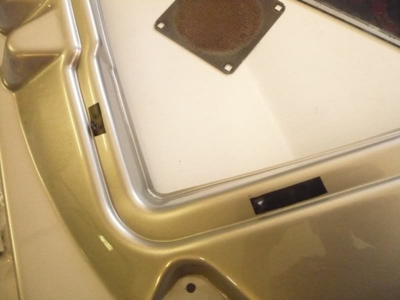

Finding metric carriage bolts in a black color was a PITA, so I sanded down the ones I had and resprayed them along with the speaker covers.

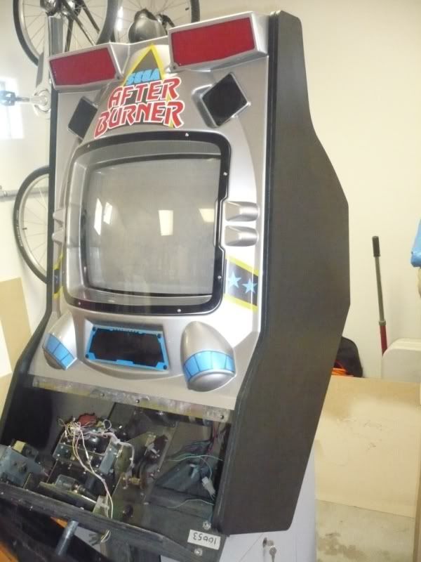

NOS decals and warning lights installed, test fit is looking pretty good!
