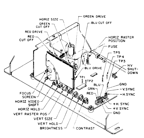

I have a stand up After Burner and the screen keeps scrolling from top to bottom and I cannot find a place to adjust it. Can anybody help me? I found the R G B knobs, but thats it. Please email me at [email protected] if you have an answer.

Hello,
First you have to determine what monitor you have. You can do so by visiting this page:
http://www.therealbobroberts.net/monitor.html
The last Afterburner I saw had a K7000 in it:
http://www.therealbobroberts.net/7000.html
If you have the same, you can see a layout of the control pots here:
Also, it's kind of a pain to have to email info directly. You can subscribe to this thread you started so that it will email you automatically when someone responds to it. If you have a different monitor than than the K7000, you'll need to go back to that thread and provide that info...
