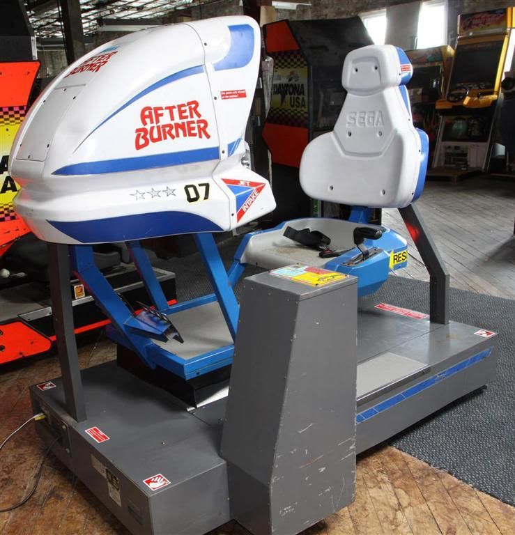

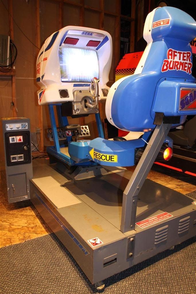

I thought I'd share a couple pics of of the AB Commander type (aka: Commando.) It's one of the cooler cabinets Sega ever dreamed up, in my opinion, and I had been looking for one of these forever; R360 seems to be more common these days.

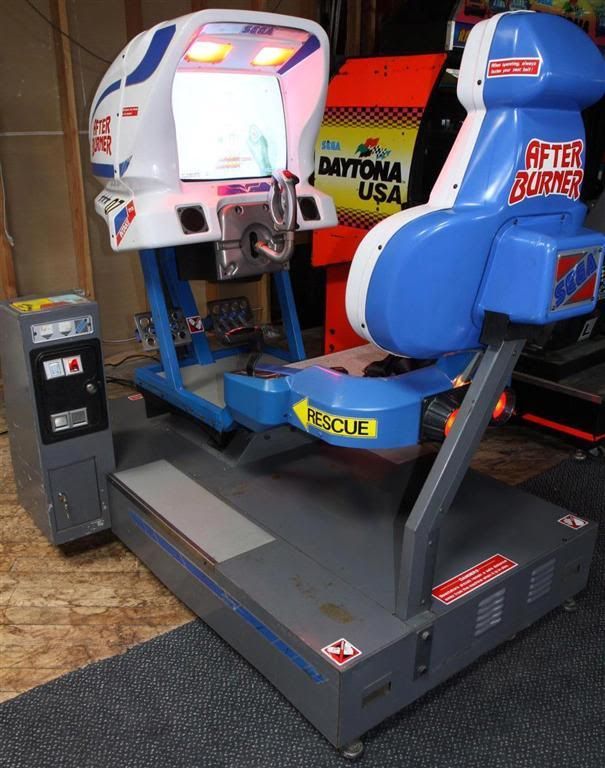

It's in surprisingly good condition, works perfect, and still has the 100 Yen coin entry. The only real problem with it is that red & green strobes mounted under the seat have expired -- I'm trying to convince the manufacturer to sell me a couple, as they are only available in Japan.
Have any of you ever seen one of these in the wild?
Now I just need to track down a Galaxy Force middle type (aka: City.) ..and I should probably sell my AB deluxe..
Damn that's pretty cool. So is this one a lot more fun to play than the AF Deluxe? I would have thought that the cockpit feel from the Deluxe would provide a more immersive experience.
I love sega cabs and this is a new variant. It looks like they took the skeleton of a sit down AB and mated it with the top half of the upright. Thanks for sharing with the group!

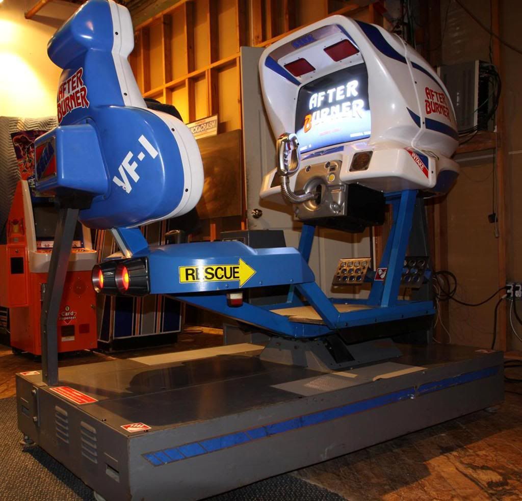

it's a self-contained xenon strobe with an intermediate base (called a FlashBoy) sealed into a plastic case that operates at 100VAC. They are still made in Japan so I'm just trying to get the replacement first -- they're only sold there because of the voltage. If that falls through I'll just try to cut them open and replace the flashtube and the cap(s). The lamps are not designed to be replaced.

It's basically the same L/R motion as the DX.
