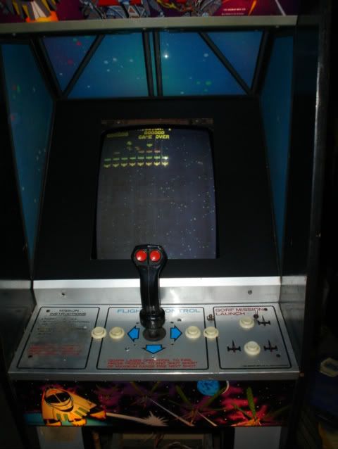

during my gorf brain transplant i droped a wire and it hit the moitor frame frying the monitor and it seems doing somthing to the game board
i have tried 3 known working monitors and all i can get to display is a black and white immage game seems to play fine other than no color
i can get some color but that is by cranking up the color drive pots on my neckboard
(ps posting this here because its not a monitor ishue since i have used 3 known good monitors)
where should i start is there somthingthat controls the color on the board set
here is a pic of my display
Looks like black and green to me, indicating no red or blue signal, unless you have the green cranked way up. If it truly is black and white, then all three colors may be on at once.
Do a voltage check at the video input connector to see if you get about 2.5vdc at each color input. That will tell you what colors you're getting and what you're not.
You could check Q8 and U15 on the CPU board for damage, as they output the main Video signal, although the PDF scans on ArcArc aren't good enough for me to find the actual RGB signals...

as for the green i have the green drive cranked up so i could see the game since i was wireing up the cp and need to see what my inputs were doing

You should not need to get the full board set for this little board. It is the one little board with the two cardboard tubes that mounts to the side of the cab... They come up for sale pretty often and sell for under 30.00. I think are the same in wizard of wor. they look like this:
http://www.classicarcaderesource.com/GorfRGBpcb.jpg
Try and find someone close to you thats has a gorf and let them test yours or let you borrow thiers. If not put a want add in the wanted section here for one.
Also read this link.
http://www.biltronix.com/gorf.html
He seems to have had a close to the same problem. I would check those resistors he talkes about.

tested my voltages at the rgb molex at the monitor and getting 3.06-3.14 on each pin
so what next
ill look at that link about the resitors and se what i get on them here in a bit
shred after reading the link you posted it seems he was not getting red at all at the monitor molex and also not at the rgb board
after testing voltages it seems that i do get all thre colors but it may be that they are always on an at full throttle as 3.14 v seems a little high to me

it was indeed the rgb board that took a dump form me shorting the lighting wire on the monitor frame
picked up a rgb board from my good buddy and bam we have gorf in color

Yea I figured it was the rgb board. I still think it was the tba530 chip.. I would really like to see that chip replaced to see if that was the issue on yours... I would really like to pick some dead RGB boards up in the future and try and fix them, there does not seem to be much too them. The 270 ns delay on them is the only thing I am not sure of.
Dave
I've always been tempted to short over the delay lines and see how the image is actually affected.
With a 15.7kHz Hysnc, and assuming 320x240 resolution, you'd get a 5.5-6Mhz bit frequency, so that delay line is at most 1-2 pixels... At worst, I'd expect to see something that looks like a uniformly misconverged image.
I'll have to dig out a gorf and try that sometime...
Though you don't need the help now, but for future reference, I believe the Astrocade based boardsets (Gorf, others that use the cage) output composite with component video, and that interface board converts it to pure RGB.
This means that you can take modern TV sets that accept component (aka ColorStream on Toshiba's) and feed it a Y, Y-R, Y-B component sigal and see if the board is outputting the correct video before it's the converter board.
In fact, I think the Y line is actually a full composite video signal (not just green+sync) and can therefore be used to feed a composite input too, but I've not tried that.
Yep.. you can connect Gorf directly to almost any TV set if you want--with the native output.
