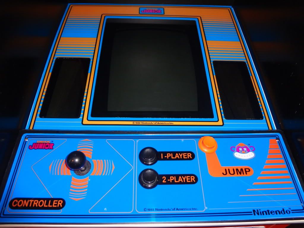

This is how Il do my glass inkjet laminate repros
its first printed on a clear vinyl in reverse then screened with a white back
then floated on to glass like a water decal with rapidtac
The adhesive is on the back side of the printed vinyl.

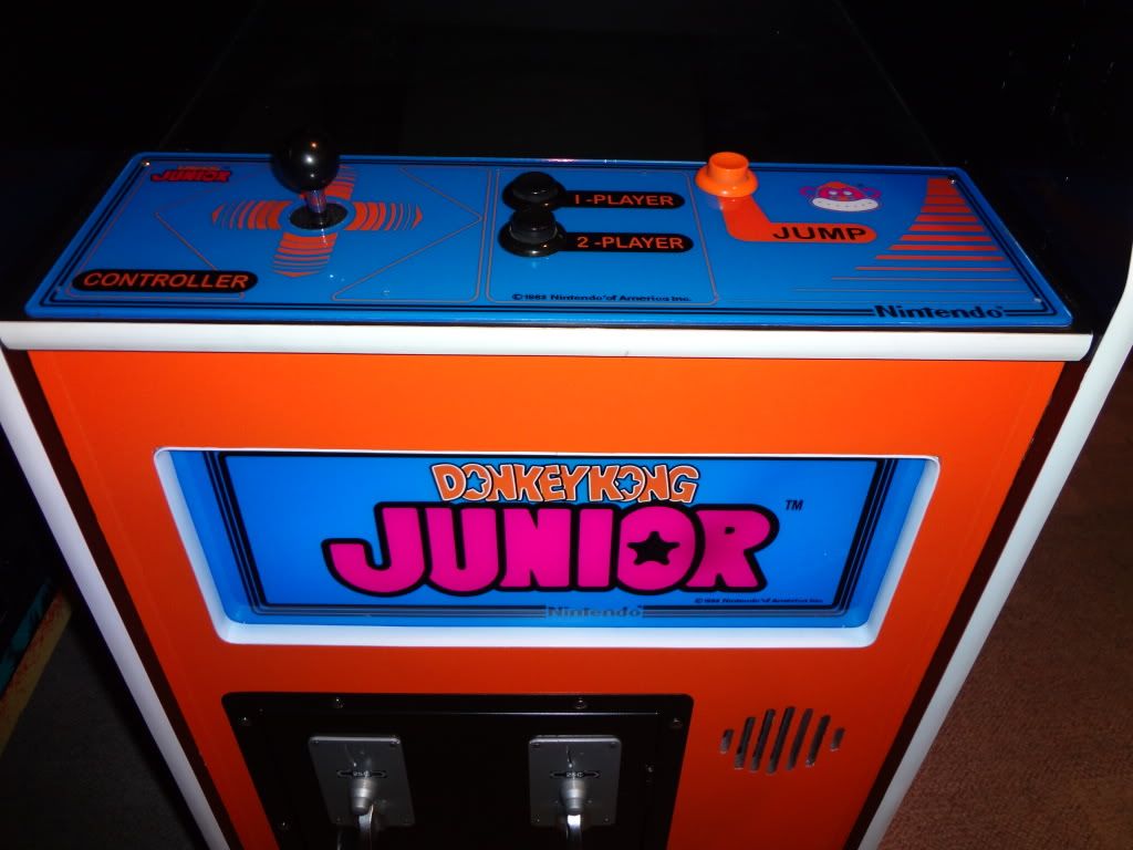

Like I said the clear vinyl I print has adhesive on the reverse side
which is why you need to print the image in reverse
but since most inkjets dont print white. I screen the backs white.
Yeah, you need adhesive. After the water/alcohol mixture evaporates, the adhesive takes hold. All 3 of these pieces were reverse printed and stuck to the backside of plexi, which is the same concept:
