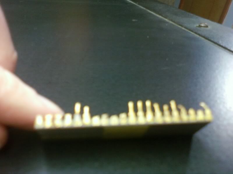

So I've recently acquired a pp cockpit converted to pp2. When I power it up, I get garbage on screen. I began reseating the roms, and found a nasty rusted chip with the legs falling off when I pulled it out. I figured surely that was my problem, so I pulled the same chip off my working pp boardset, and Im still getting garbage. I know its the board, I put my pp boardset in and it works perfect! Any tips on where to start? The interconnect board has already been taken out of the equation...
Bad Z80 chip
