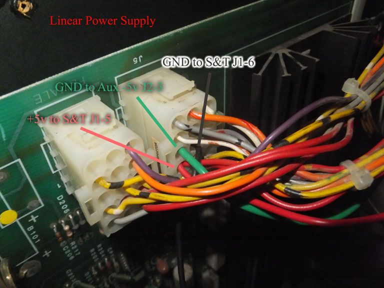

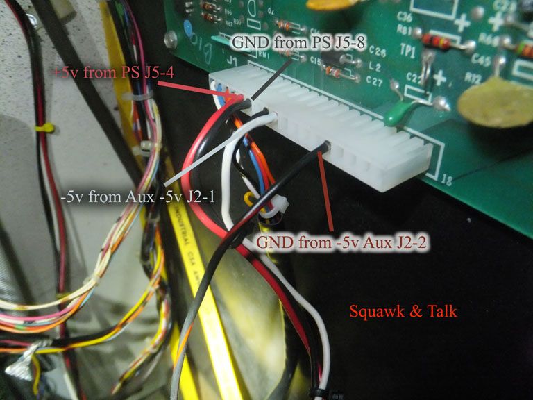

The S&T needs a +5V supply, -5V and 2 (or 3) grounds. To feed it the +5V, remove a +5V output pin from the power supply J5 connector pin 4. Then cut the pin off, add the extra length of wire for the S&T and crimp a new .084 Amp pin around both wires and re-insert to the connector. You could also use wire taps if you want. The other end of that wire gets a .156 pin and goes to J1 pin 5. This is the solid red wire in the pics. For the first ground, attach a .084 Amp pin to a length of wire and insert into the power supply J5 pin 8. On the other end attach a .156 pin and insert into S&T J1 pin 6. This is the solid black wire in the pics.
The -5V Aux board requires an input to convert to -5V. This comes from the +8V unregulated output of F4 and F5 on the power chassis (pic 2). To 2 strands of wire, connect the .187 insulated quick disconnects. Connect these to the piggyback spade connectors your and these to F4 and F5 fuse holders. To the other end of these wires connect two .156 pins. Insert these into pins 1 and 2 of the 4 position KK .156 housing. This connects to J1 on the -5V Aux board. These are the solid pink-ish wires in the pics.
The -5V for the S&T comes out of pin 1 on the -5v Aux board. Attach a .084 Amp pin to a length of wire and insert into J2 pin 1. To the other end attach a .156 pin and insert into the pin 9 of J1 on the S&T. This is the solid white wire in the pics. The -5V Aux board also needs a ground from the power supply. Attach a .084 Amp pin to a length of wire and insert into J5 pin 7. On the other end attach a .084 Amp pin and insert into the 3 position male connector pin 3. This is the solid green wire in the pics. For the other ground (to the S&T) attach a .084 Amp pin to a length of wire and insert into pin 2 of J2. To the other end attach a .156 pin and insert into the S&T J1 pin 14. This is the black/red wire in the pics.
