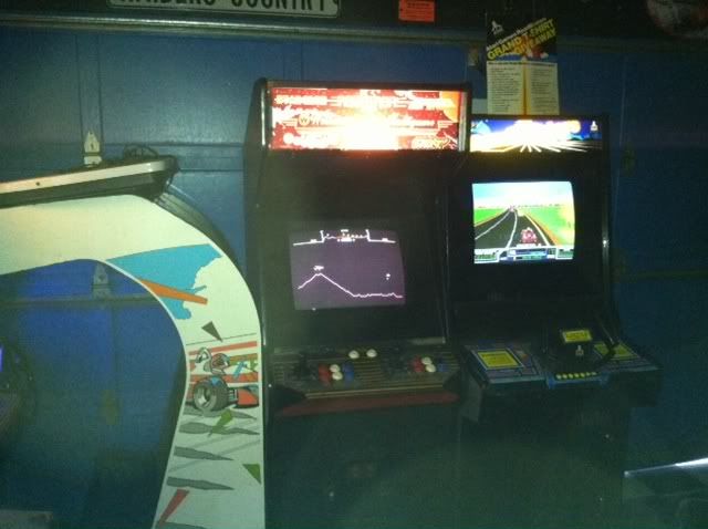

got the ultracade a few days ago.. I am in the process replacing the cga monitor with a vga one...
Picked the front line up today. it works great.. Someone did a pretty poor color match touch up job. But the cab is in good shape. I need to replace the monitor as it has some light defender screen burn.. Monitor glass is decent,but it has some scratches/flaking.
That side art graphics on the Ultracade....the girl looking THING! is very creepy looking......
But nice haul, that taito looks great....outer side good =P

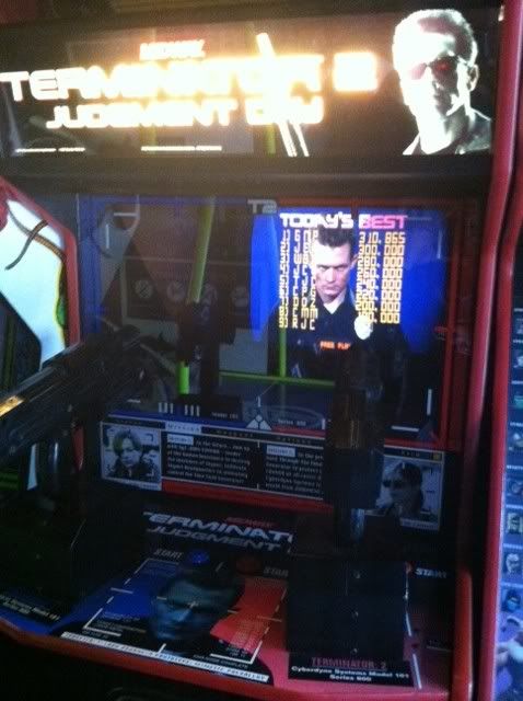

I love T2...I will have to get one of those someday....how heavy is that beast...it looks like its heavy and kind of bulky to move around...but I've never had one or moved one that I recall...
Yeah T2 is a sweet game but it"s my least favorite games to move around it's HEAVY!

I was messing with ultracade today..
Orignally it had a 25" cga in it. Pic looked dim.. So I pulled the monitor. Dropped it into a SF cab and picture looks great..
I dug out what I thought was a 25" vga I got like 8 years ago.. Turns out its a neotech nt-25e(ega). So I modified the ultracade cga dongle to ega and hooked it up.. Picture looked better, but it did not want to sync lock.
So I dug out a 27" d9400 I had. Since its VGA I could bypass the jamma video and connect directly to the computer(I was told the interface board can lead to dim picture).. Picture looks fantastic! I found some monitor mounts that will work, but I need to modify the cabinet to support the larger monitor..
finished the ultracade. I made some better monitor mounts and and added some L iron to beef up the structure of the cabinet. The 27" d9400 fits and looks great! Just need to cut the paper bezel a bit fit the larger monitor. here is pic..
