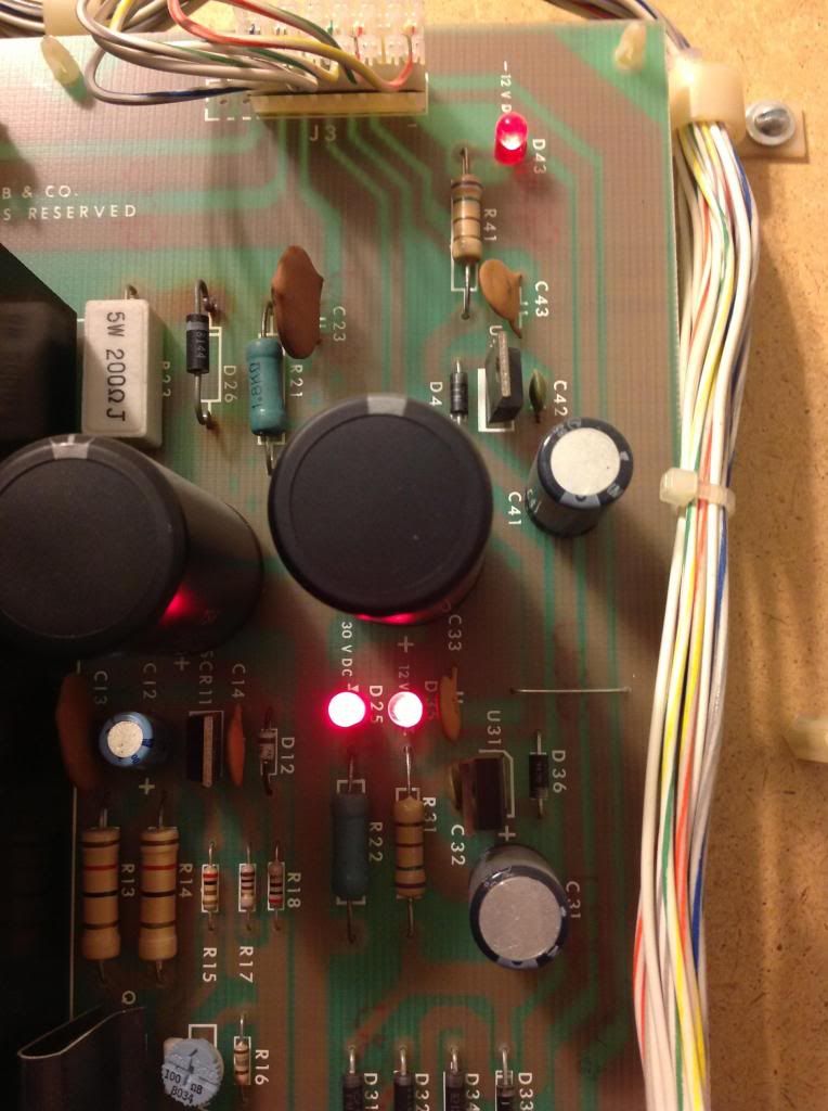

So it's really kind of a bummer that my prototype Q*Bert doesn't have a knocker assembly installed. I want to add one.
Yeah I know it's not original and all that but I'm going to mount it on a piece of wood and lay it in the bottom of the cabinet. I won't do it if I have to tap into the original harness.
Where should I start in doing this? Is it just a matter of tapping into an out on the power board?
Thanks ya'll!
It's got the voltage required to drive the knocker...
One thing that my prototype doesn't have though is an F6 fuse(knocker) on the transformer plate:

FYI, the fuse for my knocker is mounted next to the knocker, not on the brick
Its right behind the monitor neck board here:

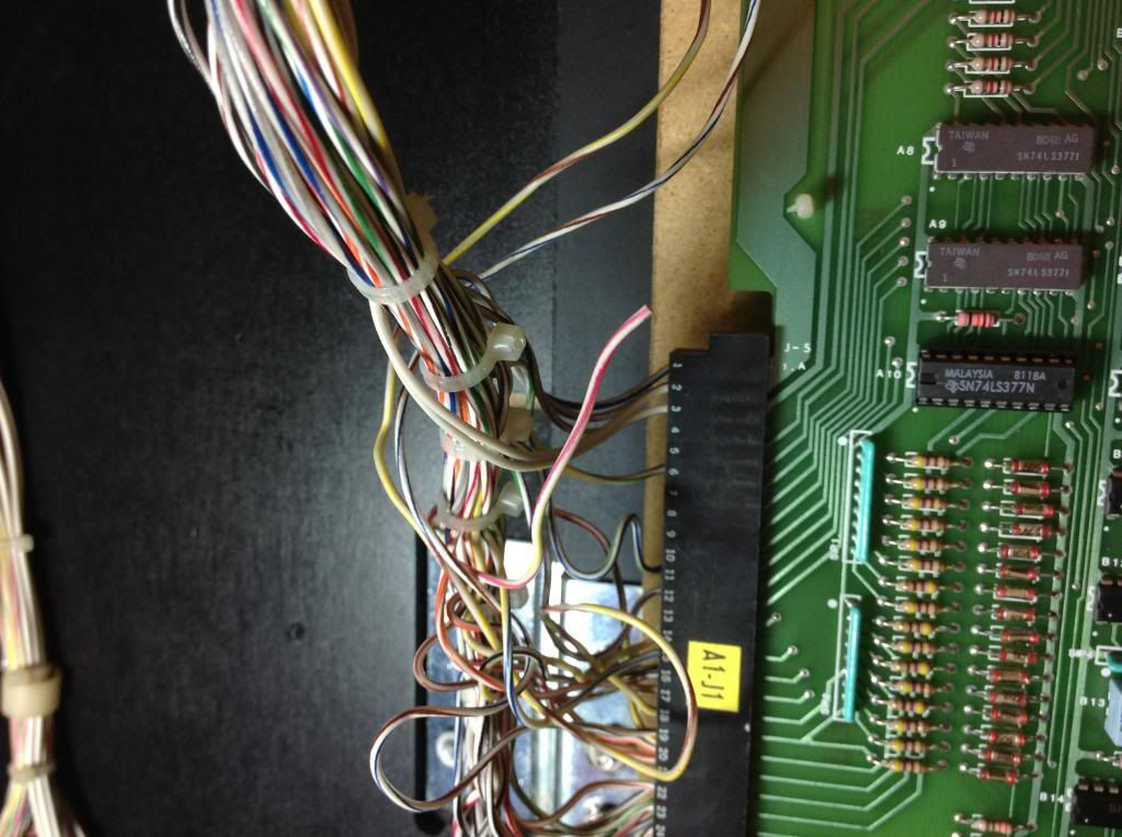

There might be an issues since you are using a prototype PCB. The code to activate the Knocker in the eproms may not be there. Meaning even if you put a knocker in there the PCB board may never send the signal to activate it.
If I was going to add something to the Proto type Qbert I would never connect directly to wiring harness. I would used Male and female connectors. So if you want to put it back to the original way. It is as simple and Unplugging it.
Correct, I would never plug directly into the harness.
I believe the code to be there as the knocker is selectable as "on/off" in the on-screen menu.
Yeah, I'm just looking for info on where it is triggered from and how exactly the knocker is wired up.
