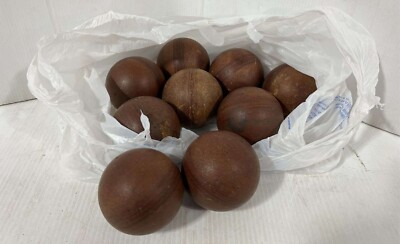

Are these real wood skeeballs meant to be played on this machine in this ebay ad?
I already have 5 that look like this:
@mhcapps, is a like the same as a yes? Lol.
I really need get some more (i'm refraining from saying balls, because no matter how i phrase it with that term in a sentence, it sounds kinda wrong)

I bought 5 of those balls, the more you buy the better the discount so it wasn't so bad. Hopefully they match good, if not i'm sure my kids can piss me off by throwing them all over the yard.

So i received the balls from ebay, 4 are good, one is some kind of composite repro. Hopefully they don't give me any trouble sending another. Glad i bought 5 when i only needed 4.
