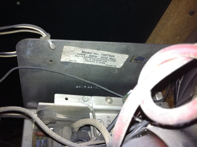

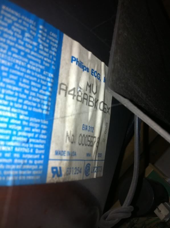

I've been busy and it's hard to find time to dedicate to getting this arcade cabinet fixed. Anyways, I was reading that http://www.junknet.net/donor-tvs page, and I don't quite understand what I'm looking for on my monitor. It looks like I should be finding a code starting with CR, but I couldn't find one anywhere.
Here's a bunch of pictures, maybe one of you guys can help?
http://s6.photobucket.com/albums/y204/Xieflow/BrokenMonitor/
Model Nomber 19k7602
http://i6.photobucket.com/albums/y204/Xieflow/BrokenMonitor/IMG_0159.jpg
Chassis Serial WG 200375
http://i6.photobucket.com/albums/y204/Xieflow/BrokenMonitor/IMG_0158.jpg
MV A48ABK05X
+ a few other numbers I can't get an angle on good enough to read, but it doesn't look like any start with CR.
http://i6.photobucket.com/albums/y204/Xieflow/BrokenMonitor/IMG_0157.jpg
If I have time today I'll try and swing by a few value villages and see if I can find some 19" TVs.
The A48ABK05X is the number you need to be concerned with.
First thing when looking for a donor tube is to match the "48" part of the number. That number determines the "size" of the tube. (48 centimeters=18.8976 " , in other words a 19")
Some 19" tv's will actually have a 20" tube, so absolutely match those numbers.
The second thing you need to do is look that number up in a guide such as (google CRT_Setup_Chart) which is where you will find the CR # to match. (yours is a CR31)
This CR number is the neck socket size and pinout.
Yep, that's a CR31 neck. It's 8 pins, commonly called a 'thin neck' tube.
Here's a link to the B&K rejuvenator setup guide. In this guide, there's a chart showing a good listing of most tubes made, and their corresponding heater voltage, as well as their CRT socket type. That tube, an A48ABK05X, is listed on the chart. It uses a standard heater voltage, 6.3 volts. It's a CR31 socket.
http://www.bkprecision.com/support/downloads/pdfs/CRT_Setup_Chart.pdf
Start scouring craigslist for 19" TV's. Ask the sellers (or givers, as the case may be) if they can tell you the 'A48' number inside the vents on the tube. Ask nicely, and most folks are willing to oblige.
Careful, though. I'm on the hunt for another CR31 donor TV (flubbed my first attempt at a swap), and I'm not having much luck. Most free or really cheap 19" TV's I'm finding are CR23's which are showing up on TV's made from the mid '90's and later. The one TV I found that was made before 1990 was the 1 CR31 I've found. You're going to be looking for an OLD TV.
Get a matching tube and socket, and you're 99% there. The last hurdle is to make sure the yoke isn't bonded. That way if the TV's yoke doesn't work with your chassis, you can swap yokes.

Yeah the "CR" codes are for the B&K rejuvenator sockets, basically a way to reference what size/pinout the neck is. There really is no other great way to reference it. You look up your existing tube in the rejuvenator handbook, see what CR code it is, then get look at my list and find a compatible tube thats the same size (number starting with A48 or 19) and neck (same CR code).
The purpose of the list on Junknet is a datbase of known-good donor tvs. Print it out or bookmark it (I'm hoping to have it in a better format sooner or later), and take it with you to garage sales, thrift shops, etc. If you find a TV with that make/model number or close, you may have a winner!
It also helps that if you are shopping thrift shops, get a cheapo LED flashlight to peer through the vents - you can usually read the tube number and led flashlights seem to work well for that purpose.
