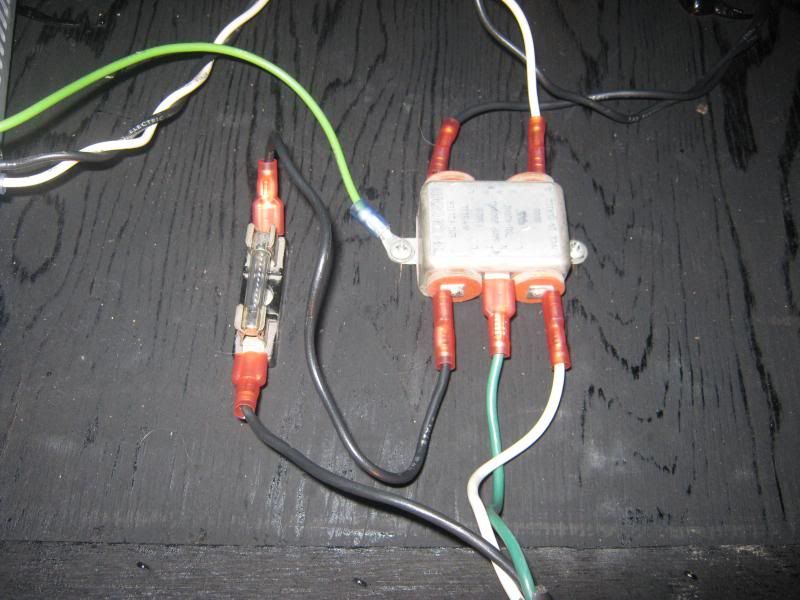

I would move your fuse to go before the on/off switch. Right now, if your switch gets damaged and shorts out, you'll have unfused household AC going through there.

I use Bobs diagram as well. I would suggest a distribution block and moving fuse in front of everything.

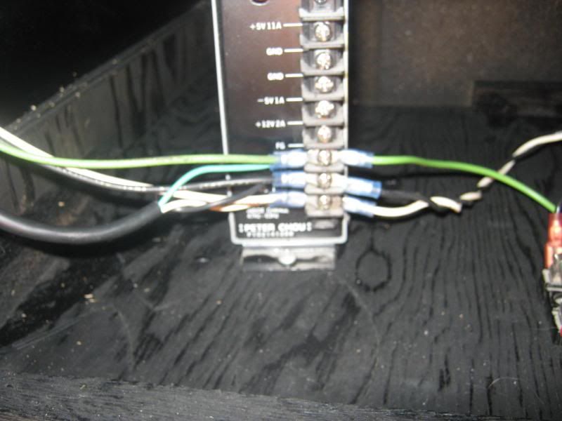

yes i moved the fused in line first and here are some pics, looks like it works, the marquee light comes on and i just used the power supply terminals for a power distribution type deal, still need to order a new jamma harness and video converter and wire it up
Shazaam!
I always wonder about having the fuse, with its exposed contacts, just sitting there on the bottom of the cab. I've seen it piles of times, but I always think there should be something covering it (plastic or even a folder piece of cardboard), just to stop a loose screw from shorting it out, or your arm from brushing against it.

yeah i got plastic cover i plan on putting over it
Are you using a PC running MAME with a computer CRT? If so why not just throw a power strip in there? What are you using the switcher for?
Other than that your wiring looks good.
no its a regualr street fighter 2 pcb, im just using a crt monitor because i had a old 19 inch and a video converter for it is only 35$ and allot cheaper than buying used or new arcade monitor, so when i flick the one switch everything cuts on and same as it was before with regular arcade monitor
