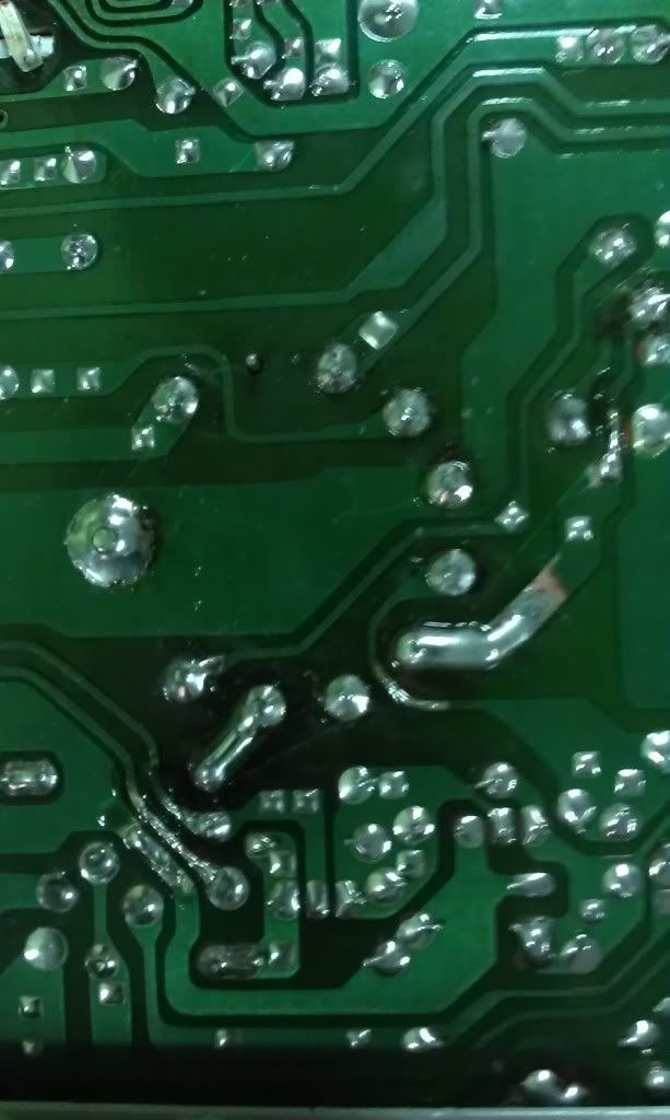

I compared the neck pins on the neckboard from the chassis with no heater against 2 other ones and I am getting an open between the heater neck pins, while I have continuity on the heater pins on my other 2 neckboards.
well, this is rich..

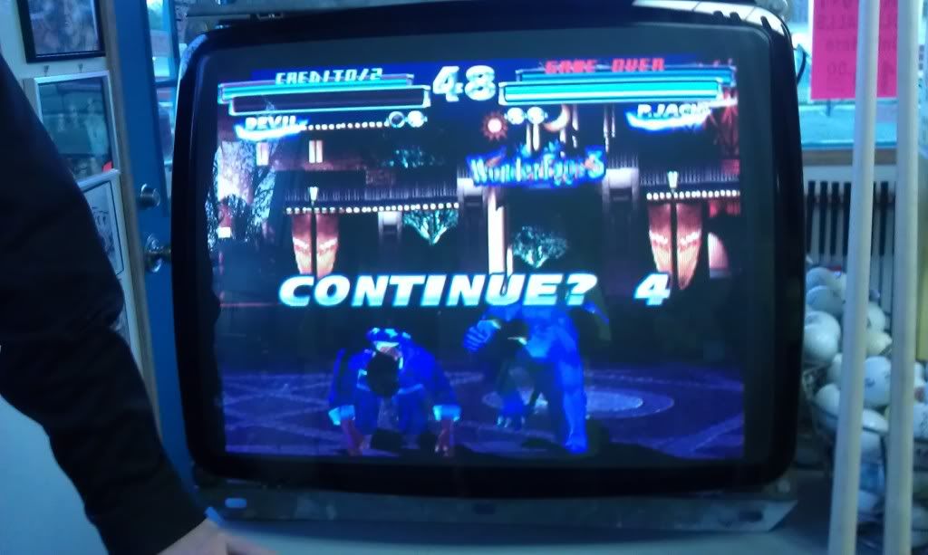

I found SEVEN broken traces around the flyback, on, you guessed it, the heater pins. did my patchwork on those and I got heater again, but with an all-white screen. I had a blanking problem and replaced R40 and it's all good again.
I'm running the monitor now with Tekken Tag and it's looking beautiful. :D
now onto the next chassis.
Polo 1 broken traces! glad I could just scrape and solder patch them instead of using wires.

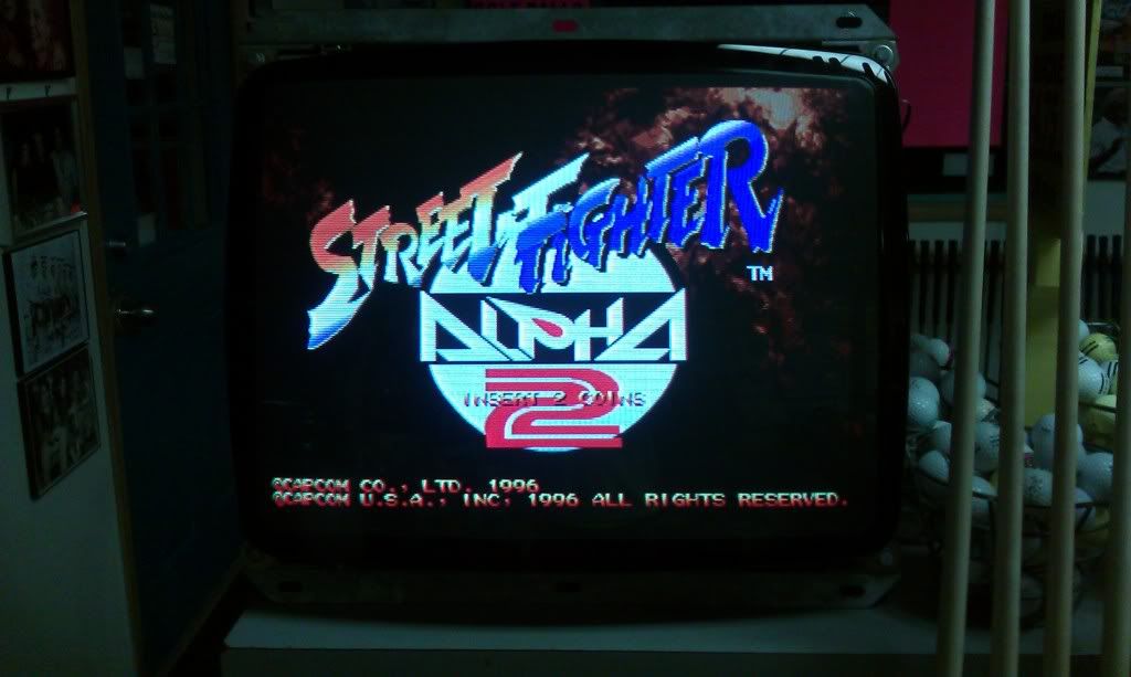

Polo 1 alive:
Polo 2 had some poorly soldered parts in the power supply. real easy fix after all.
yep, got both of them working. if I never stressed the importance of checking your traces... well, check your traces. :p
