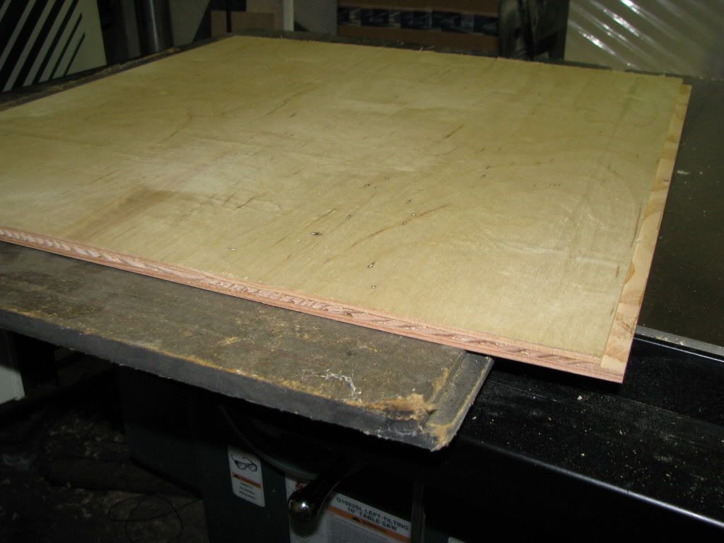

After replacing the lower backdoor with a new piece made from 1/2" birch ply, I had to make a new upper. With a Robotron upper door as a template, here goes..
Notice the original door has swollen and is much thicker than 1/2" at the edges:
I cut it and routed the edge so that it would fit snugly into the top edge of the lower door.
Next off was to make the recessed hole for the lock. I figured out which exact size forstner bits fit the hole and recess, so I could drill the recess first:
Here's the finished hole. Also, the door lock plate with 3 holes is the original type used on this cabinet (from the Robotron door). The one with 2 holes came from Bob R and is close enough.
Not shown, but I painted the door with satin black RustOleum, same as the lower back door, front and top of cabinet.
