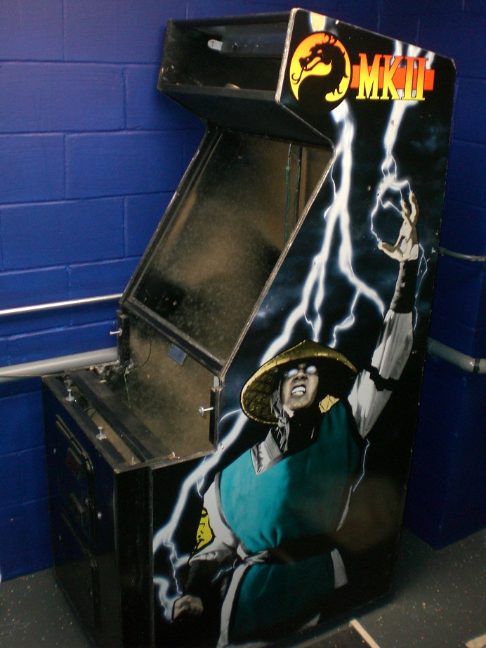

A sneak peek at my next game restoration...
As promised, pictures.

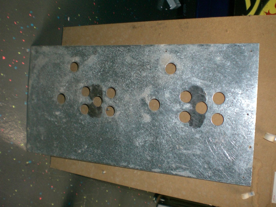

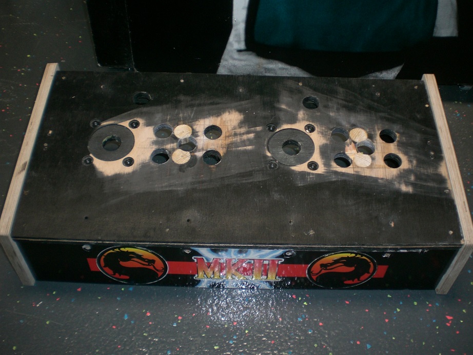

Here's the wood control panel, before I started. The previous owner had filled in 6 holes, and drilled 4 new ones. All of this needed to be fixed.

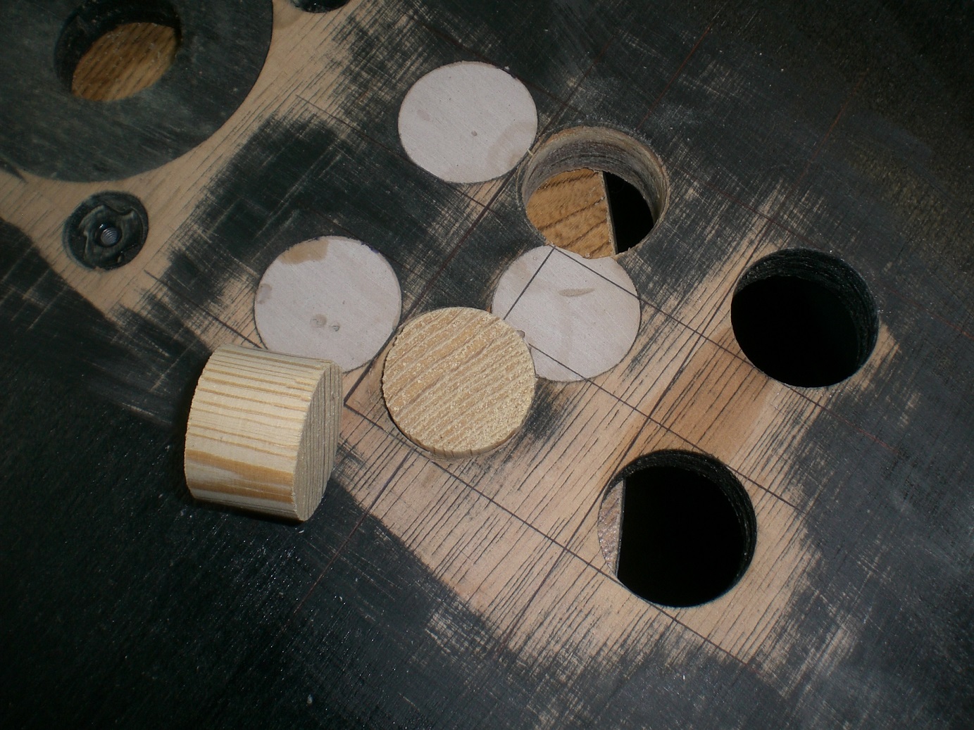

Here's a shot of the wood dowels, cut to size, and being dry-fitted before being glued in.
And the finished product, after I removed the bondo plugs, and glued in the dowel. I had to re-drill the center holes after gluing in the dowel plugs.

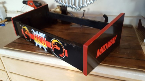

You can also see the replacement sides I made for the control box here too.
Finally, here's a side view of the 1st side, art stripped. I still have some clean up to do in some areas, but this is pretty close.

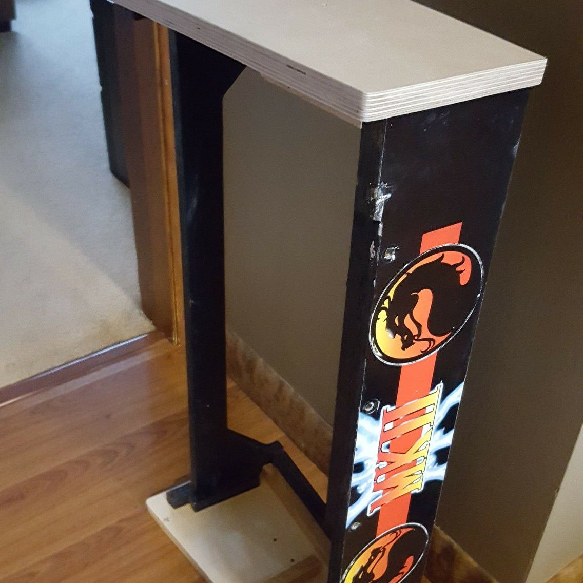

Spent more time working on the MKII yesterday. Focused my efforts on getting the control panel done. I got my 1/16" slot cutter bit for the router last week, so I was able to cut the slot for t-molding.

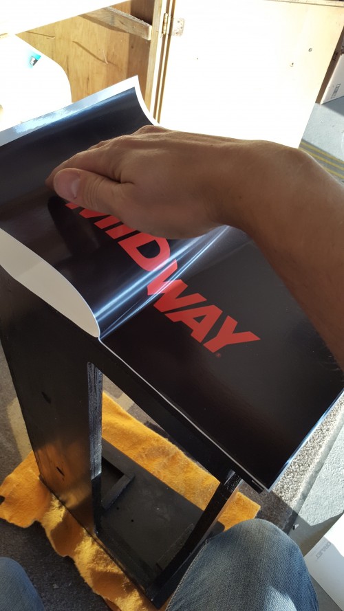

Installing the side art on the control panel box:
I like the way the woodgrain of the birch ply shows through the vinyl.

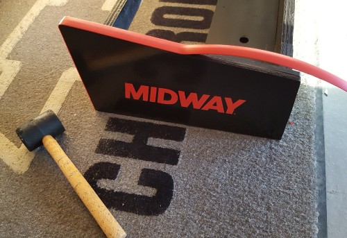

T-molding installation:
Lower half of the box done.

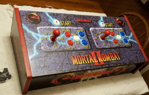

Test fitting the control panel, after installing the buttons, sticks, and overlays. It's starting to look pretty nice now.
Getting closer. I had some time to sort out the wiring harness on the game last weekend. The old harness had been hacked up a bit to add the extra edge connector for the extra player buttons on Tekken. I removed the extra edge connector, replaced the .100 IDC connector for the low-kick & low punch buttons, and we're all set. Also replaced the locks in the coin doors, and the starter and bulb in the marquee fixture.
