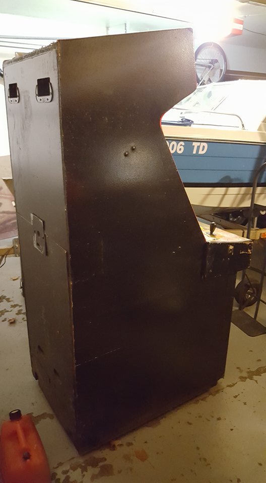

MK II in the house. This one will get the full treatment.
Gas can was considered briefly. In the end, preservation prevailed.

I have a Galaxian with that same thick black paint on the side. ugh. I'm probably going to use klean strip or citri-strip to get it down to absolute bare wood.
What method are you using? Are you going to try and preserve the side art?

I'm using Citri-strip to remove the layers of paint. This cabinet has 2 layers, and I'm finding that it takes 1 light brush application to get each layer up. It's a delicate balancing act to wait just the right amount of time to let the Citri-strip lift the layer of paint, but not so long as to allow it to start to eat away at the vinyl artwork underneath. The white areas of the artwork are the most difficult to work with, as there is no ink to act as a "barrier" from the chemicals, so they tend to leech into the white areas pretty quickly. Scraping off the paint is fairly straight forward, but the white areas are more problematic. The easiest method I've found is to use the Citri-strip to get the paint off working around the white areas, then I let it dry for a day. Then I go at it again with a magic eraser and 91% isopropyl alcohol. That usually allows me to clean up the white areas. Work slowly and methodically, wiping up with paper towels as you go, and the white areas will clean up nicely.
Last night I spent some time on the hand, and you can see the results on the white lightning. It's a slow process, and requires patience. But I should be able to recover the artwork for the most part.
attachment.php
Here's a current progress shot. The areas circled in yellow represent where the citri-strip got ahold of the white too much and I lost those areas when scraping. I'll have to go back and fill in those areas with some white model paint.
The area circled in red is where the previous owner worked on art removal on the palm of the hand and applied too much pressure with the magic eraser and alcohol, resulting in completely removing the halftones. I'll have to try my best to fill in those areas using a micro-tipped sharpie or perhaps some kind of screen. Not too big of a deal to fix.
This cabinet will not be a gorgeous restore. I don't intend it to be. I'd rather do my best to clean up what I have to work with and rescue a survivor. When I'm done it'll be a decent looking $1000 MKII instead of a pristine $2500 machine. I think the world needs more "good enough" restored cabinets, and less of the "it's better than factory fresh" cabs. There's a market for good, clean original cabs.
