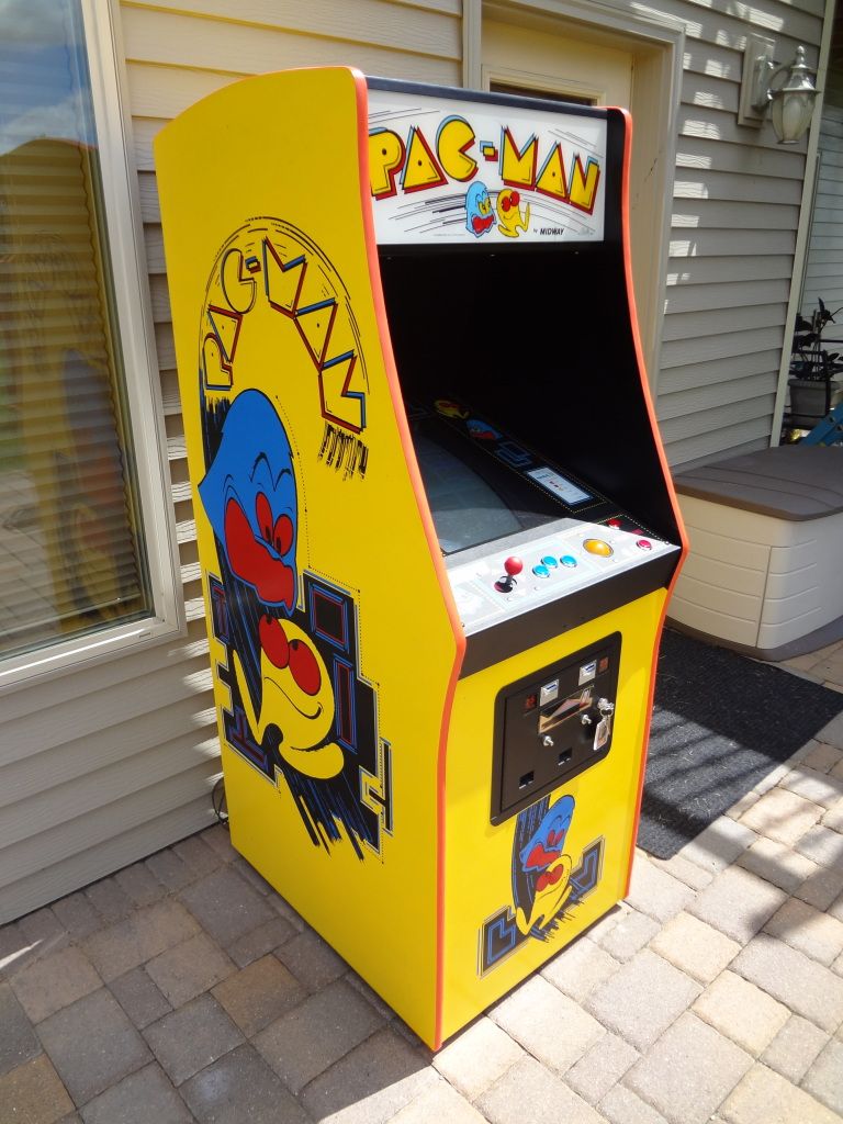

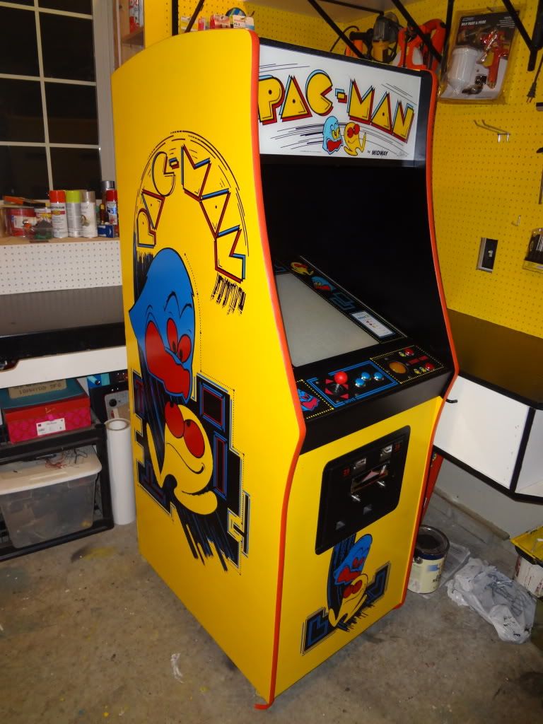

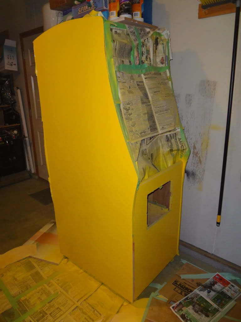

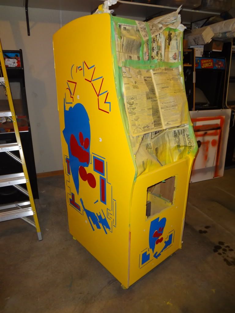

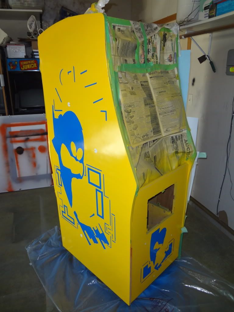

Yeah, I used all oil-based cut with Penetrol. Mostly Rustoleum, but sometimes I splurge and go with Sherwin Williams All Surface Enamel. This was 100% Rustoleum:
OK..i haven't been around here in awhile..so forgive me :) but DAMN ! thats a Great Paintjob ! I'm VERY Impressed PHET !
You Get 5 Stars ***** :D
Daniel.
I'm here, I'm here! Thanks for info. Yes, your PAC cab is amazing. If I had more patience and experience, I might be willing to take on the stencil job.
